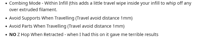

Not sure if these will help but I found these settings online:
stringing-1
