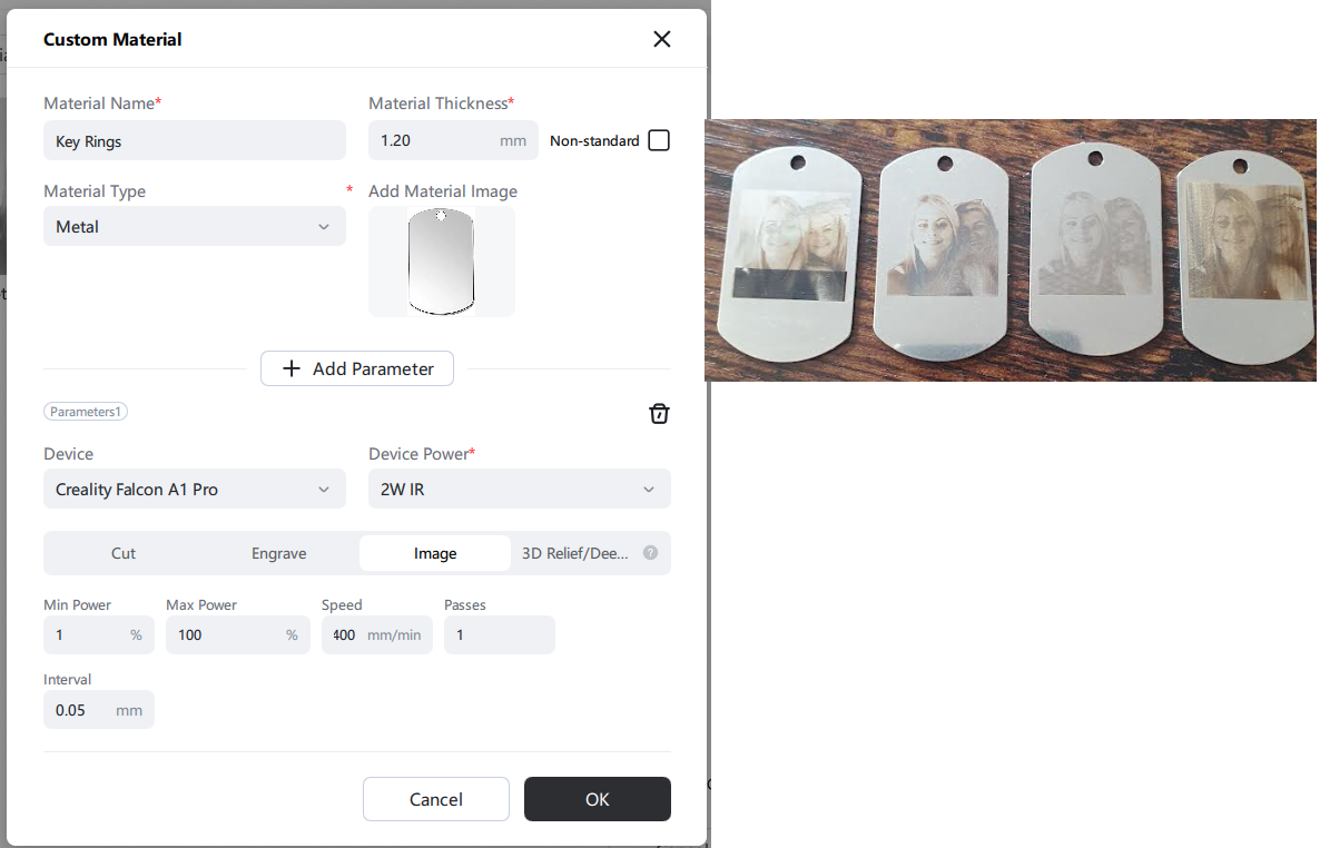

I’m hoping (praying !?) that people here can help me - This is my first attempt to engrave a Stainless Steel keyring wih my new Falcon A1 Pro.
I’ve been working with Claude however i don’t think Claude’s knowledge is that great ! Gives me many conflicting settings etc. Also tried YouTube videos however not much success.
Essentially, “where am i going wrong” !!!.

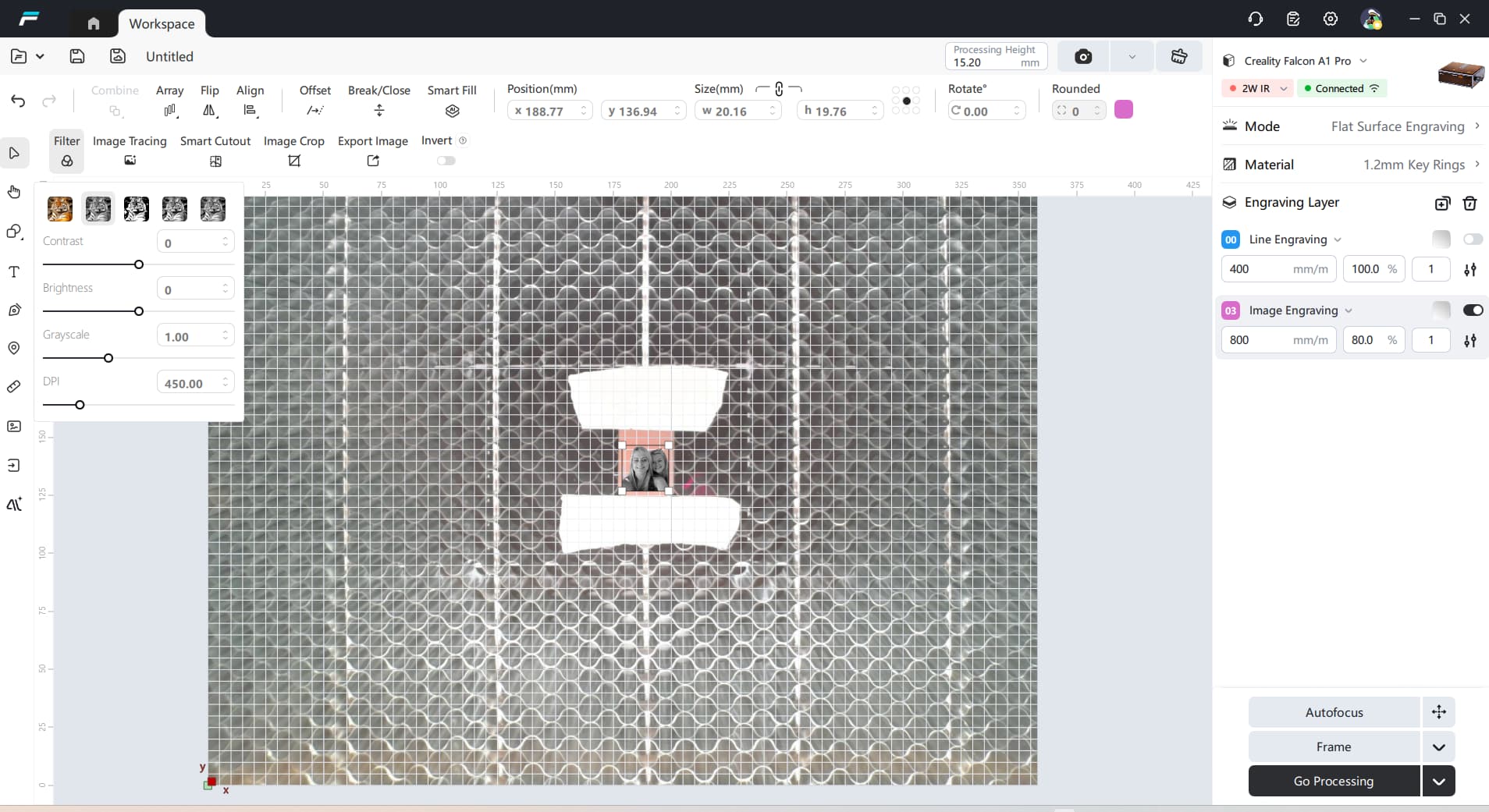

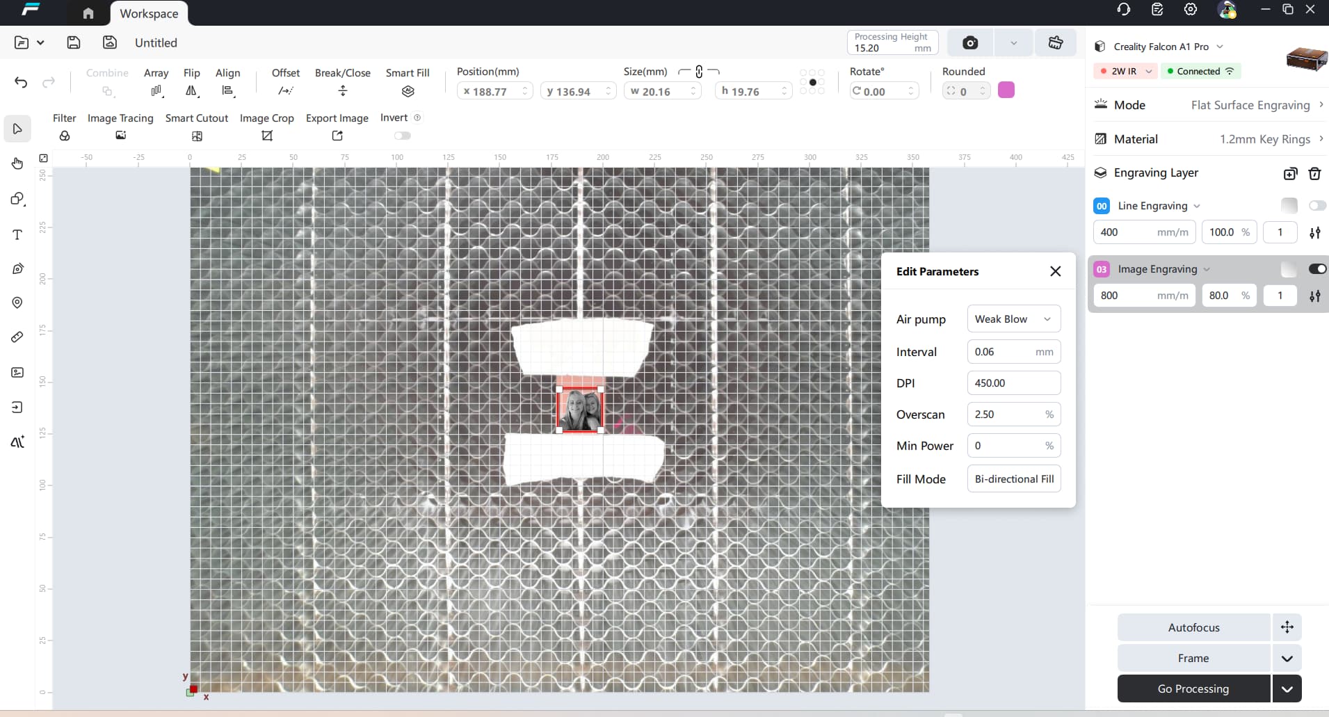

I have uploaded various screenshots to show my current settings and have tried other settings with many varied outcomes ! Have attached some examples of what I got it to ‘print’ and also screenshots of my settings.
The image i’m using is just a ‘basic image’ (ie - i have not run it through any ‘image→engraving’ software or anything).
I’m hoping somedody can put me out of my misery !
I don’t even know if i should be using 20W or the 2W IR module ? And also get confused about the ‘3 step focus block’ (so how to set the laser Z axis)
Hoping this forum will have the answers before i have no hair left !!!
Many thanks for reading..

I’d separate the material problem from the image problem first. For bare stainless, start with the 2W IR head — Creality lists that one for stainless and fine photo work. Get the focus and a small material test right, then go back to the original image and sort the tones, inversion and dithering. I’ve been using this free browser tool for that image stage: Image Preparation for Laser Engraving — Makers Army . You’ll still need to dial in the IR settings, but at least you’re testing with a cleaner file.
