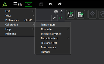

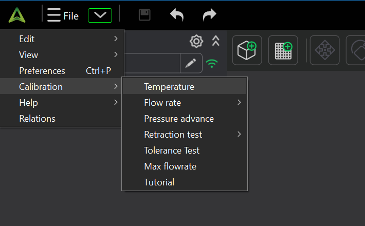

The temperature tower is just one tool in a broader set of calibration tools. Many users prefer to calibrate pressure advance and flow rate first, since those directly affect extrusion consistency, but there are differing workflows and opinions on order.

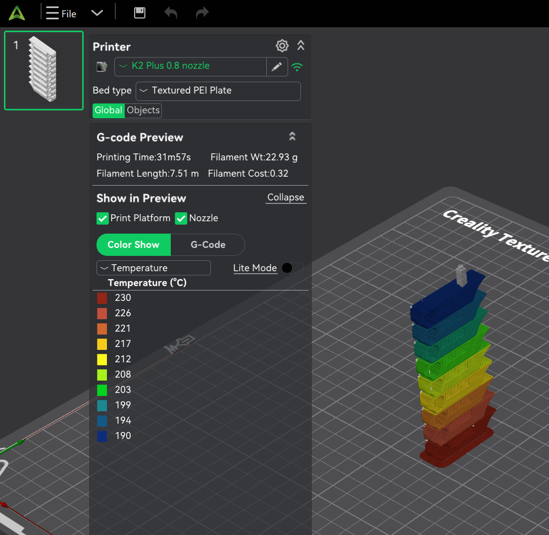

If you are simply downloading a temperature tower model and printing it as-is, it is likely not being used correctly. A temperature tower only works if the G-code is generated to change the nozzle temperature at each height of the model. Fortunately, most modern slicers handle this through their built-in calibration menus.
After slicing, switch to the temperature or preview view in the slicer. If you do not see a clear color gradient or “rainbow” indicating temperature changes by layer, then the model is static and will print at a single temperature, which defeats the purpose of the tower.
