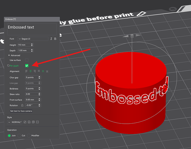

  • I have a cylinder I want to place text on. I thought I did it with an earlier version. Is this possible?

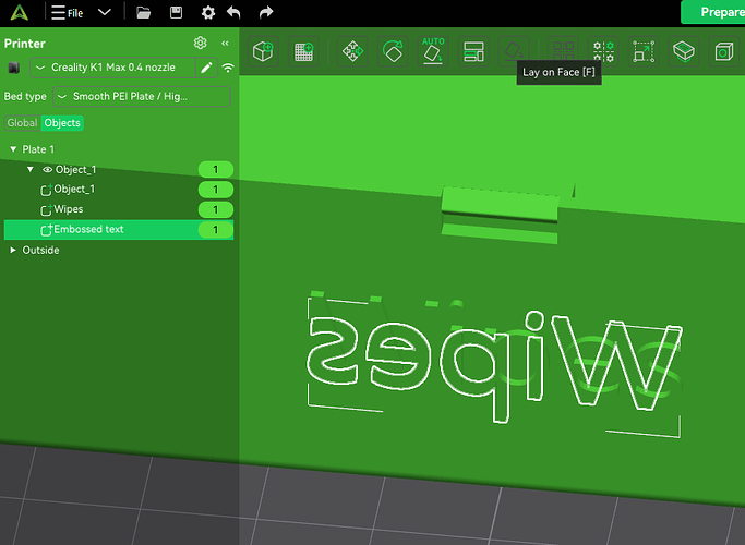

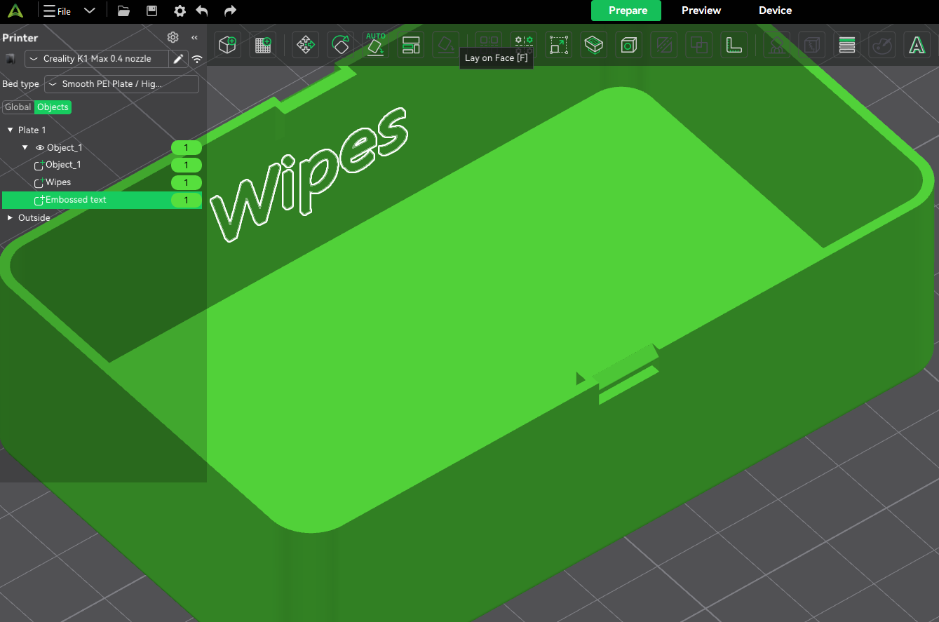

  • I have a box I can select the first side (flat) and put some text on it, but if I rotate and try to place text on the opposite side of the box, it places the text on the inside wall of the first side.

Concerning the first question, you have to activate “Per Glyph”

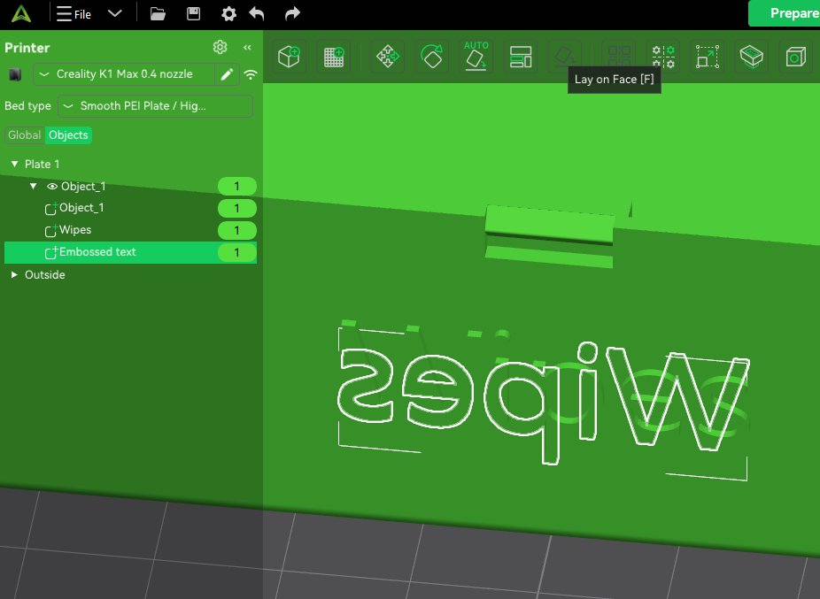

Concerning the second question. This figure you can see the embossed “Wipes, which worked.
The second image I selected the other side and entered “Wipes.” As you can see it places it on the first side’s back side.
