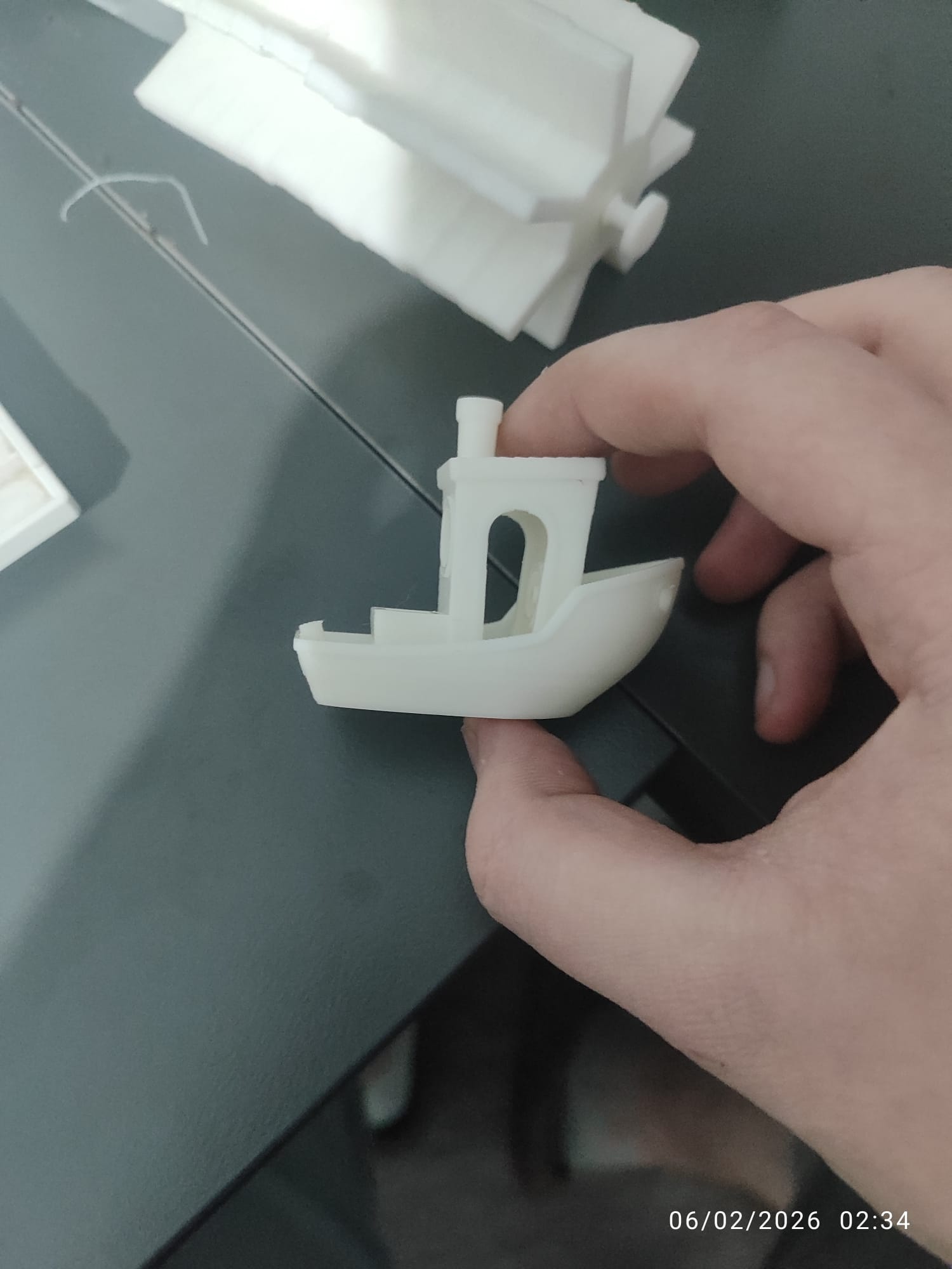

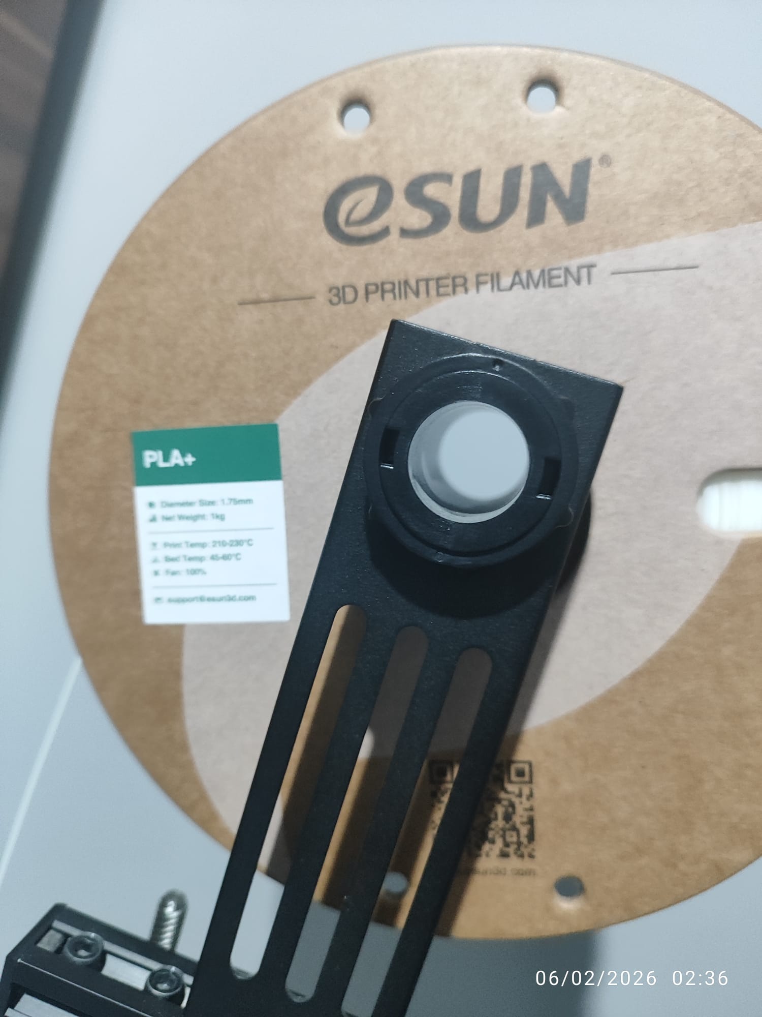

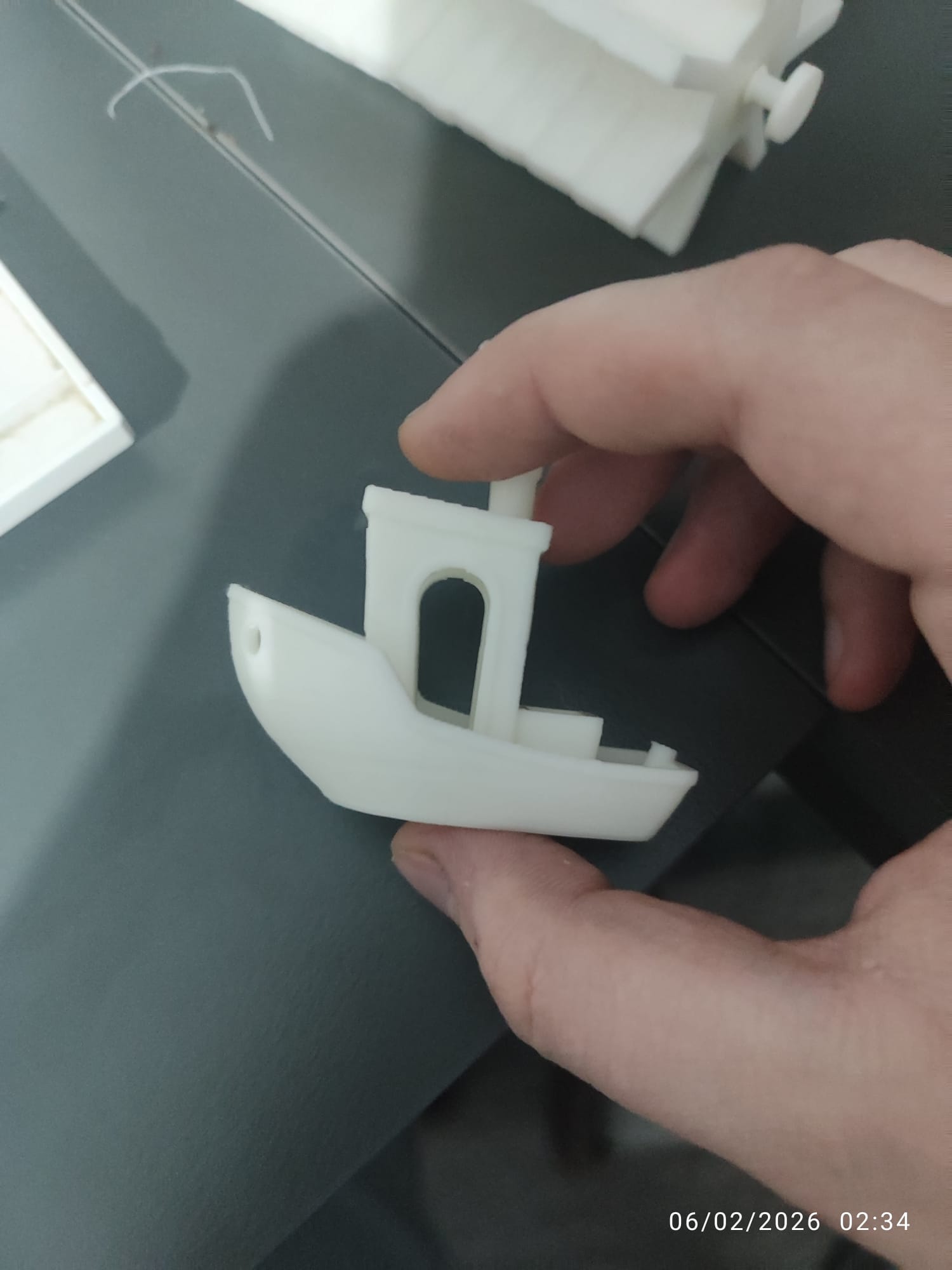

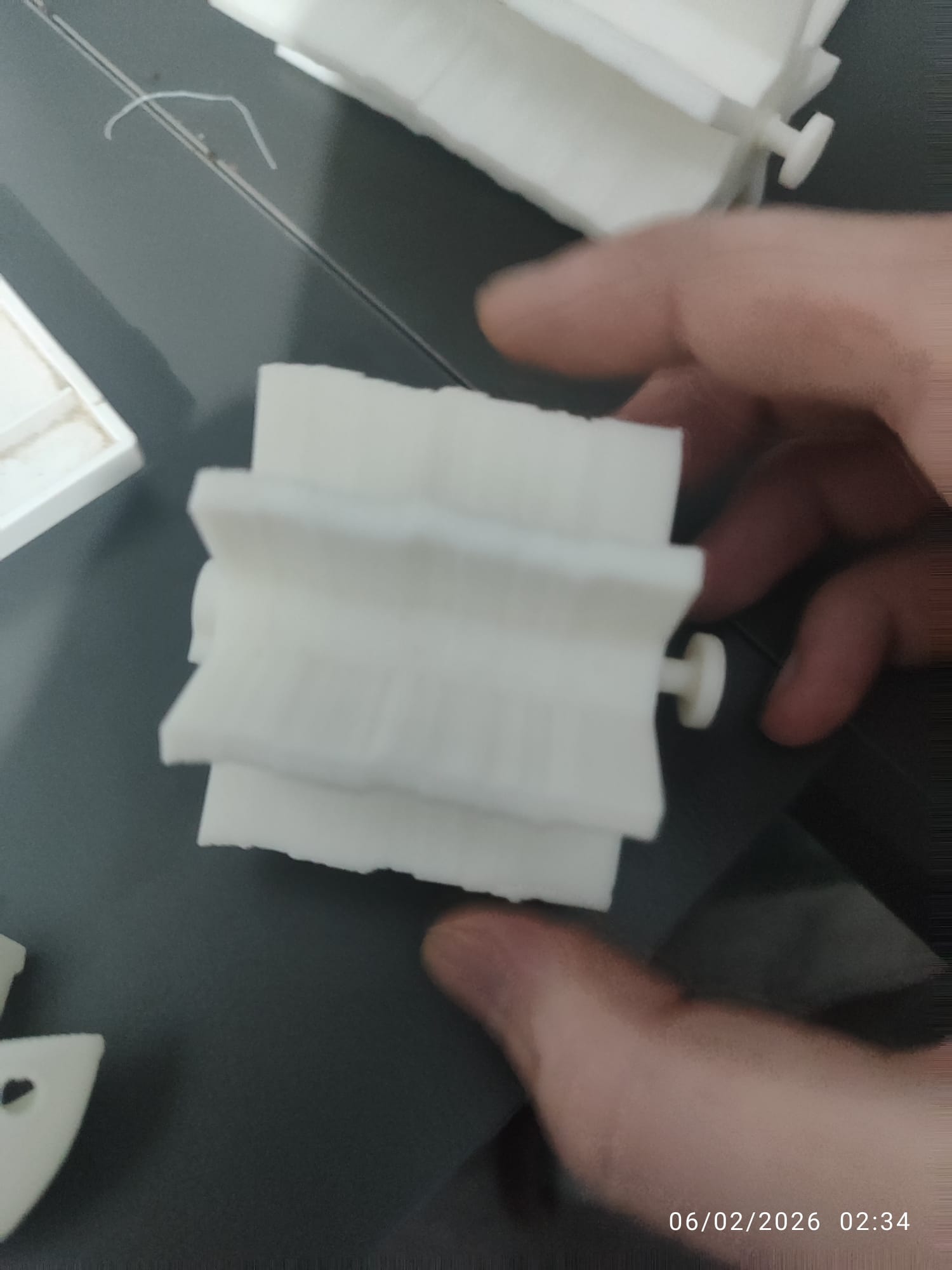

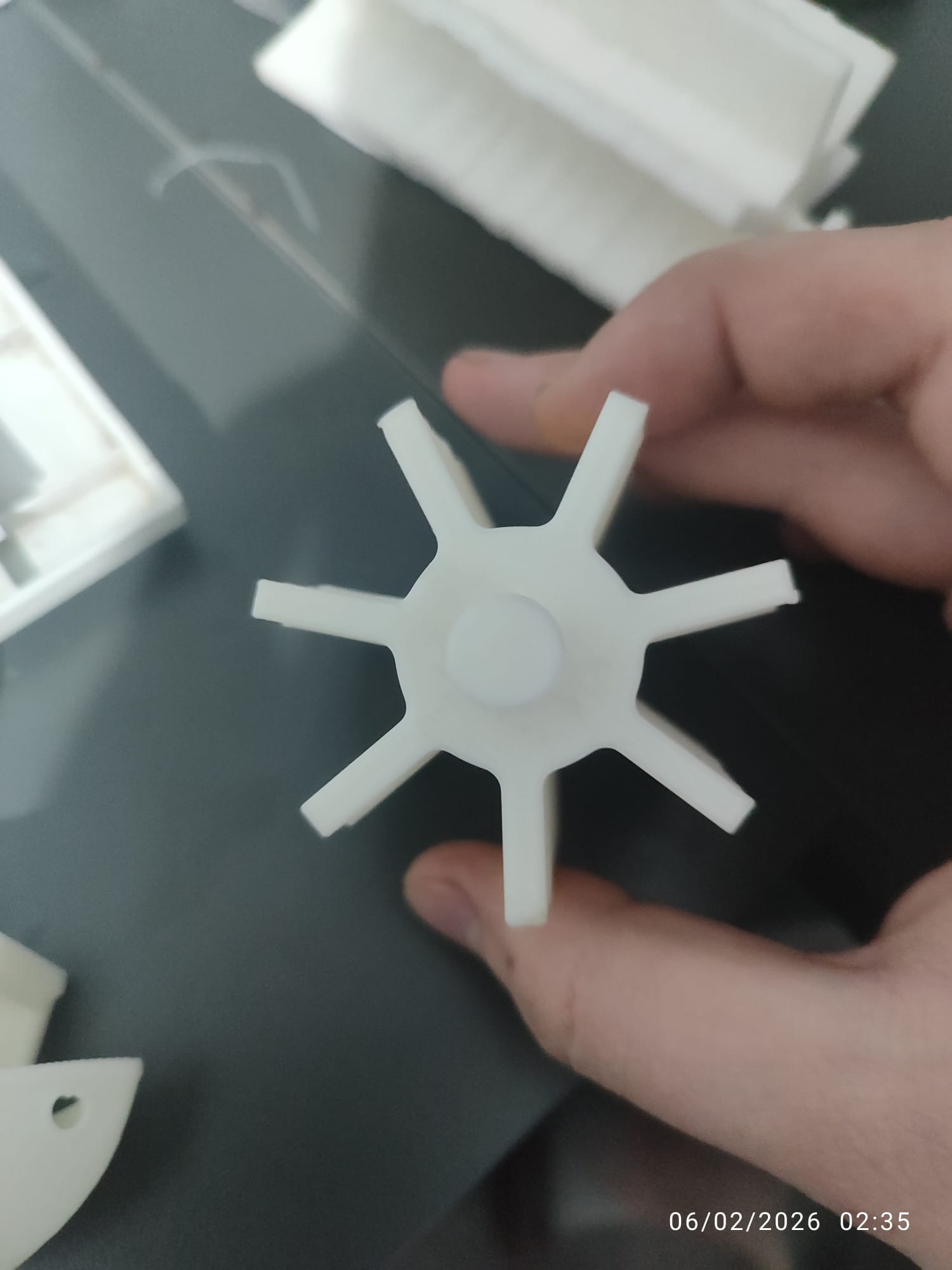

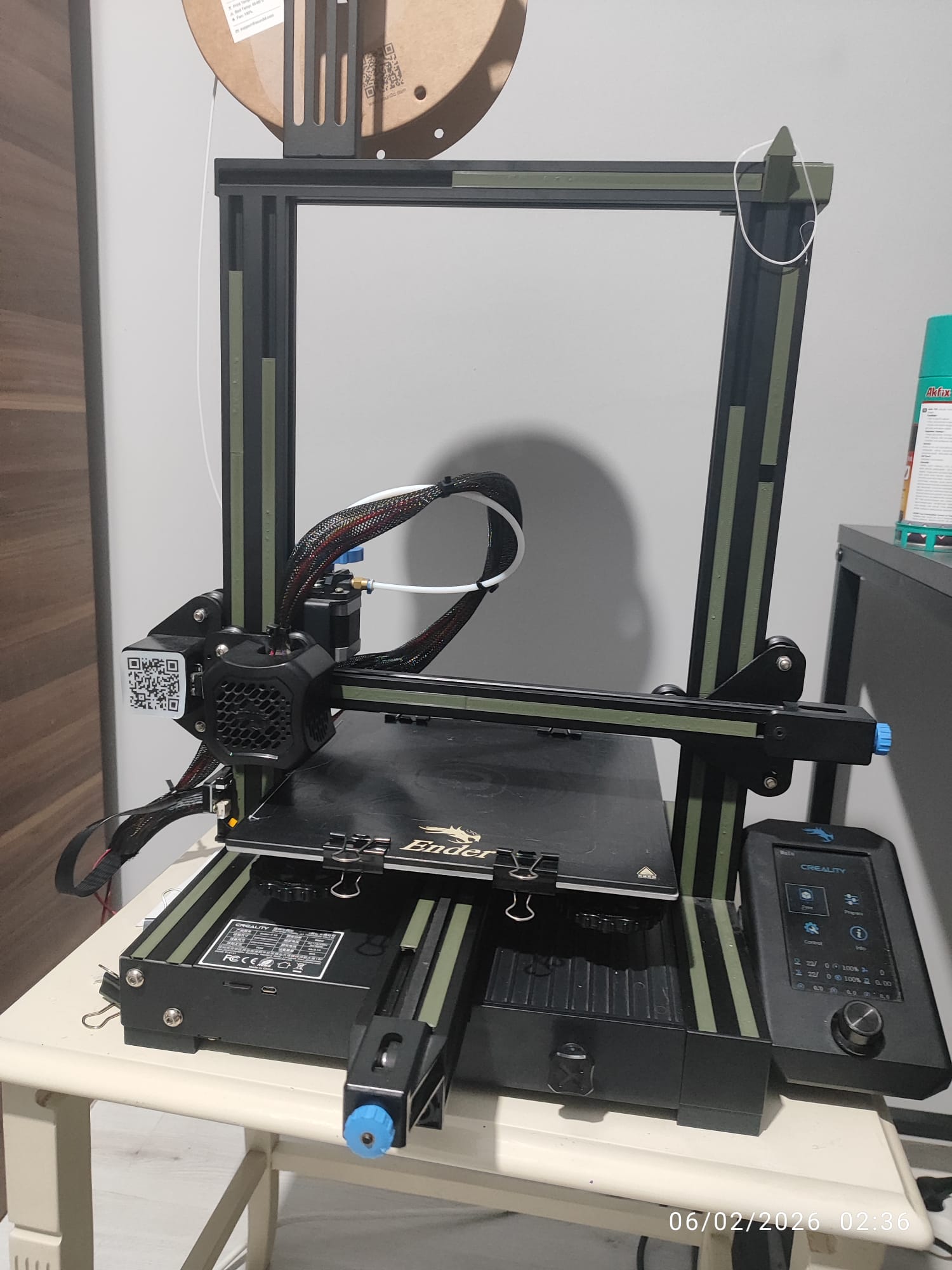

Hello everyone, forum members. I have an Ender 3 V2 printer. I replaced the X belt and leveled the bed. I checked the bed carriage and tried many different adjustments, but nothing has changed. I printed a Benchy and it came out smooth, but all my other models print with layer shifting. I’m asking for your help with this issue. For the two prints I tested, I used Cura’s default settings; the only change I made was setting the fan speed to 0 for the first 8 layers so it wouldn’t come loose. That’s the only modification.
My first thought was the print bed is moving. Is there another surface on top of the print bed? Is it secured? I use four clips to hold my printing surface to the bed.
Print speed? Looks like it is different between Benchy and your print.
