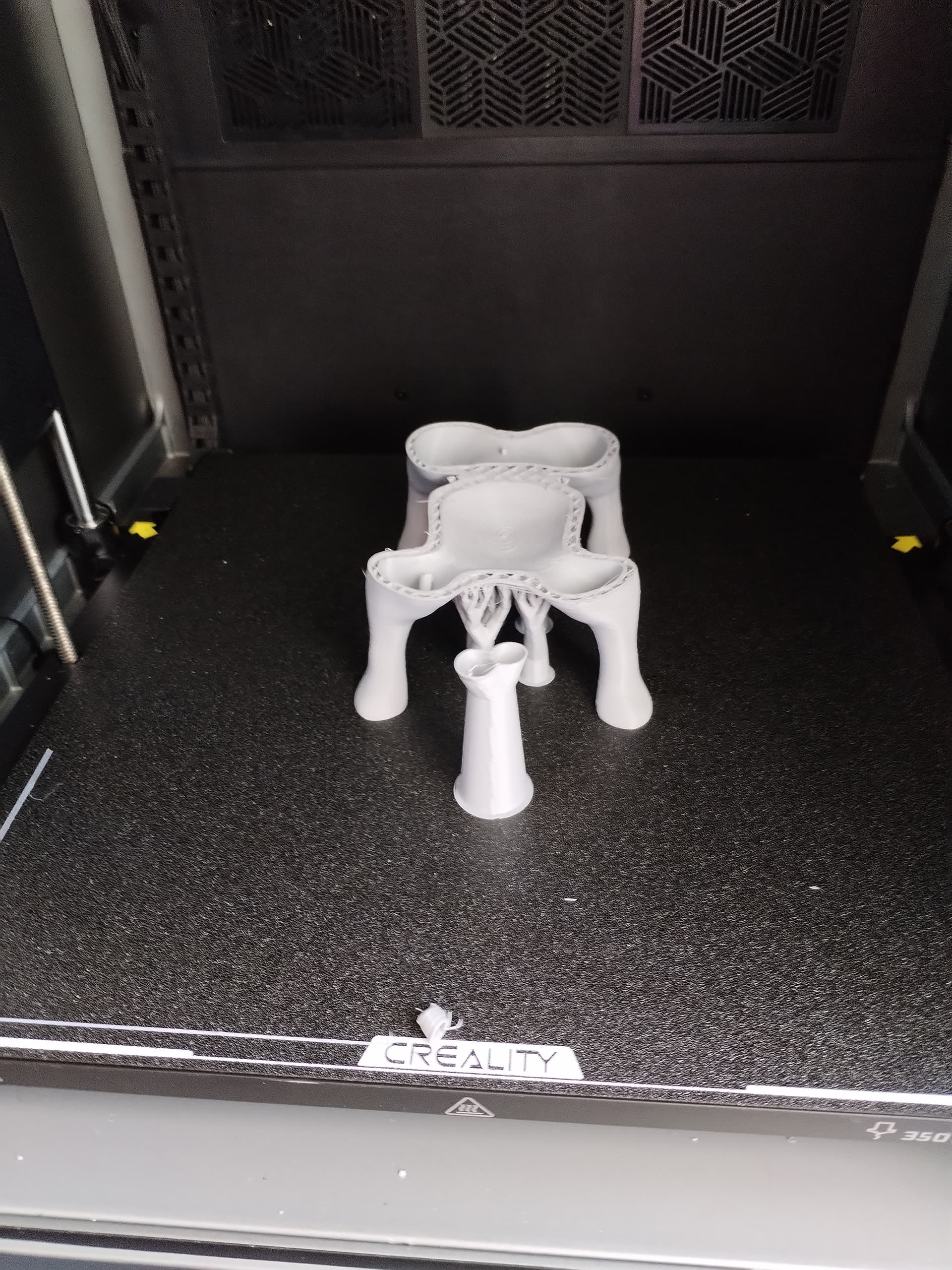

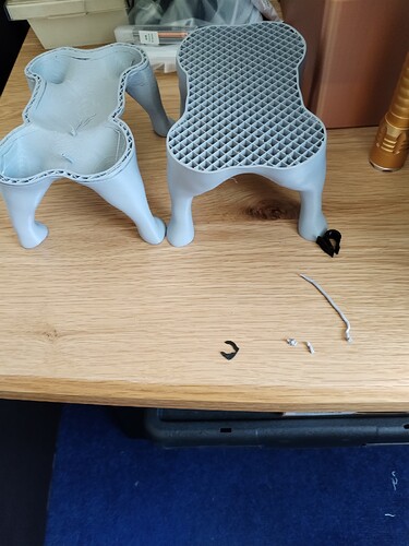

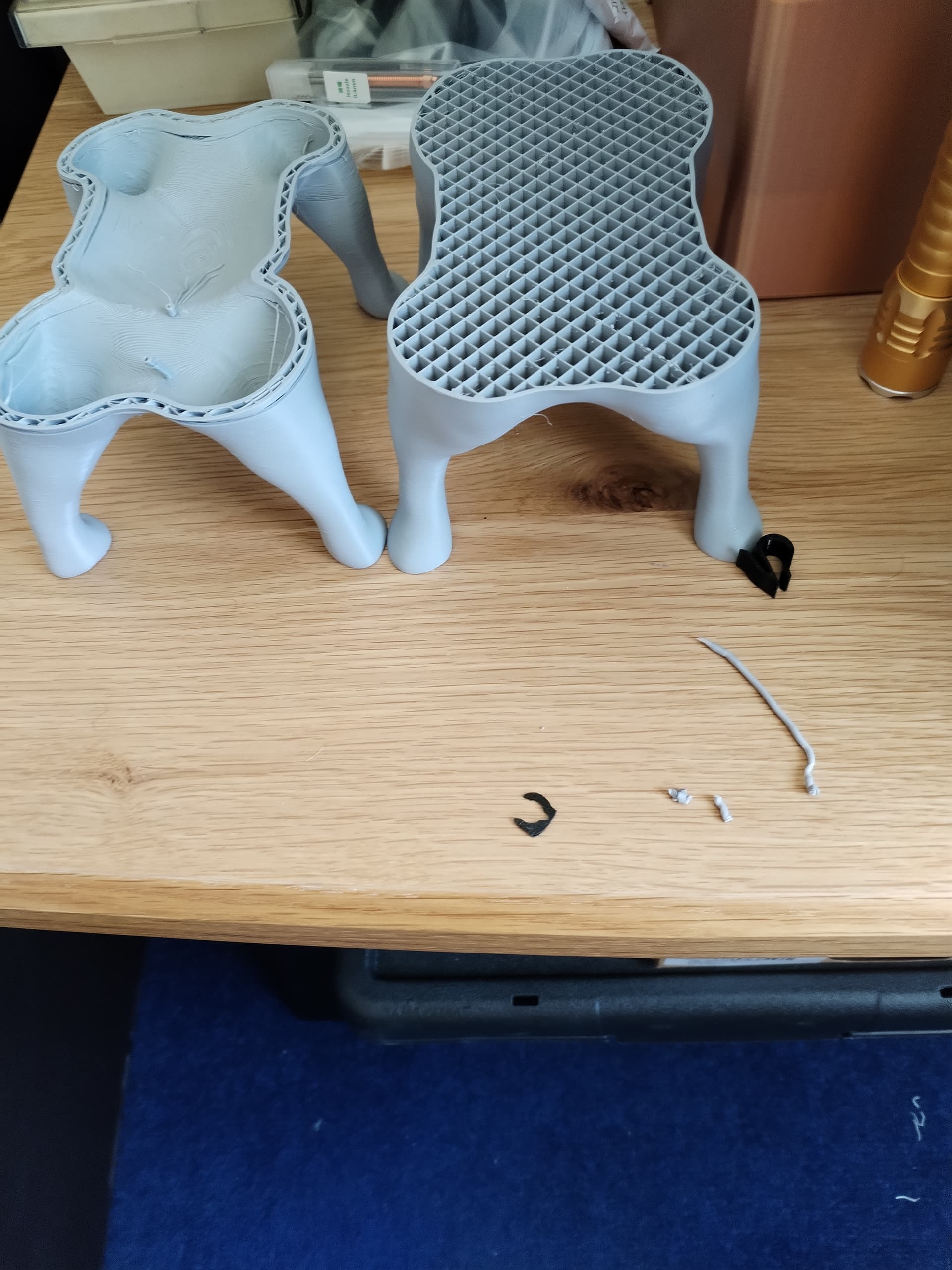

Those blue prints with poor layer adhesion suggest under heating of the filament.
FWIW All of my extruder jams have come about from using old (4+ years) of poorly stored and undried filament.
sorry took so long to get back to you creality sent a replacement extruder front i fitted it works a charm now
would explain why it looks like a problem with layer adhersion

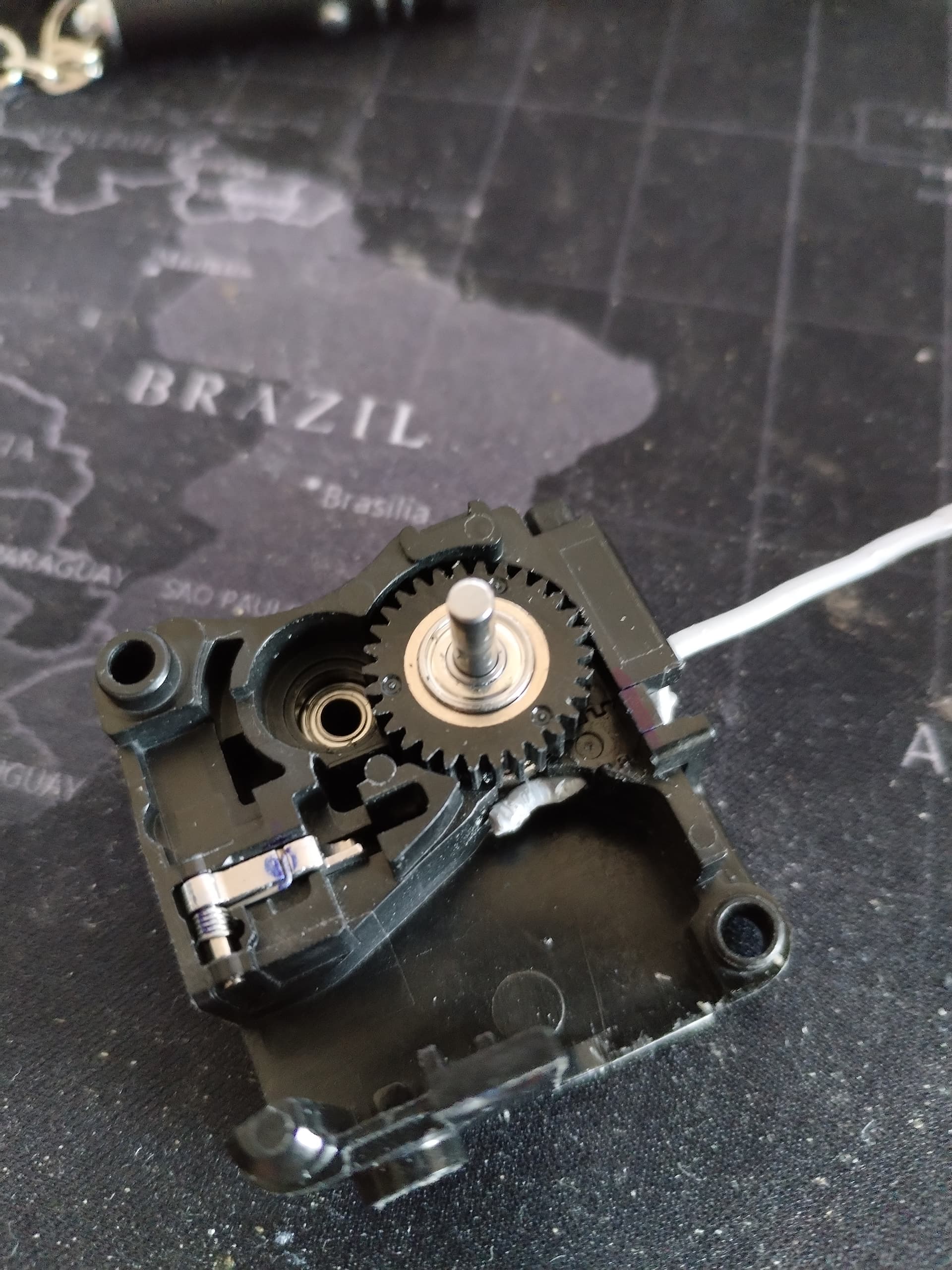

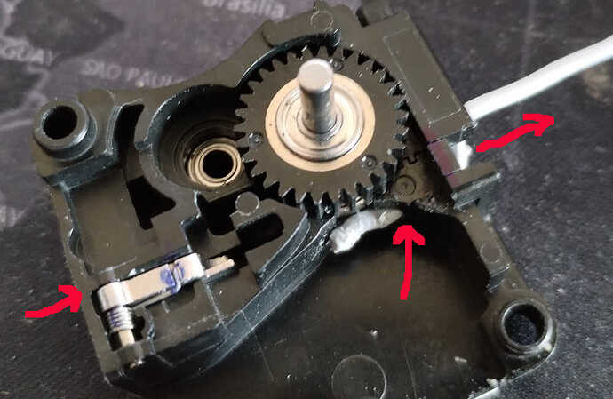

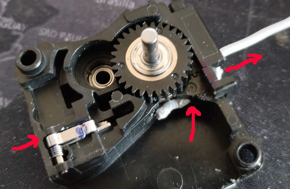

I’m also getting problems with the exit point of the extruder. FWIW for some reason it’s happening with ASA more than other filaments.
The filament enters the extruder (from the LHS), then runs past the knurled drive wheel and then doesn’t get into the hole in the exit cone (middle arrow). Perhaps the hole in the exit cones needs opening up ? I have a recently purchased extruder and it appears no different.
