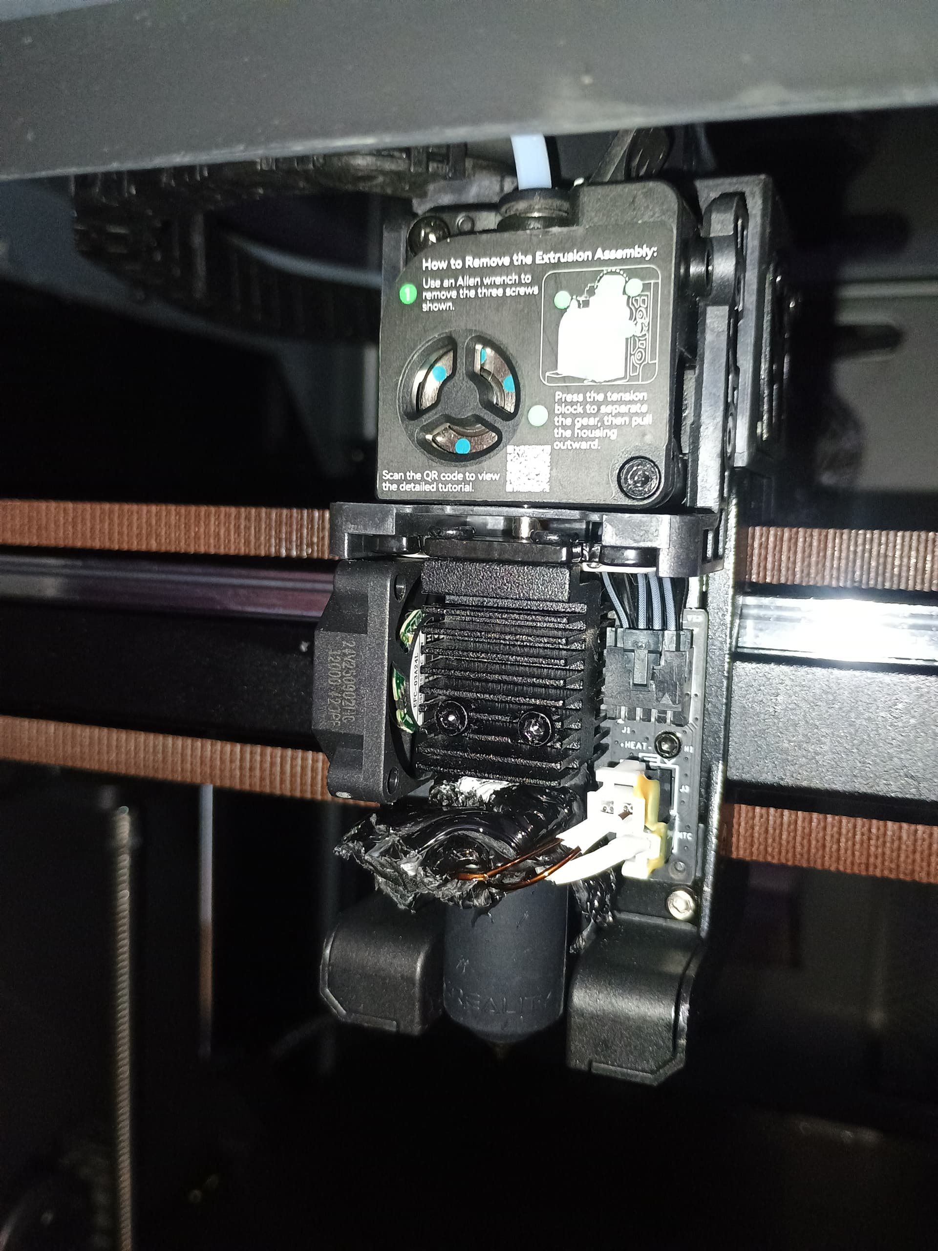

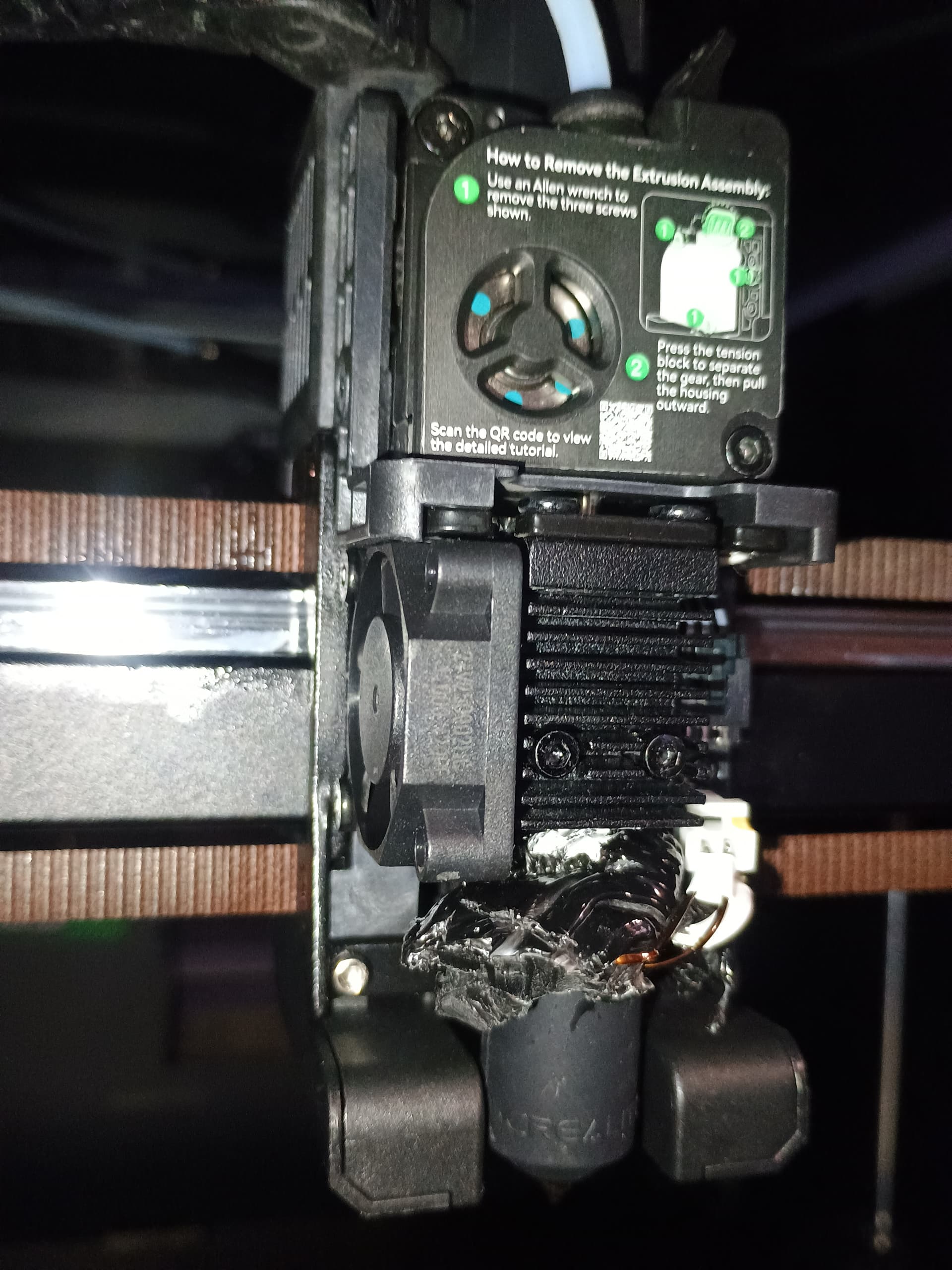

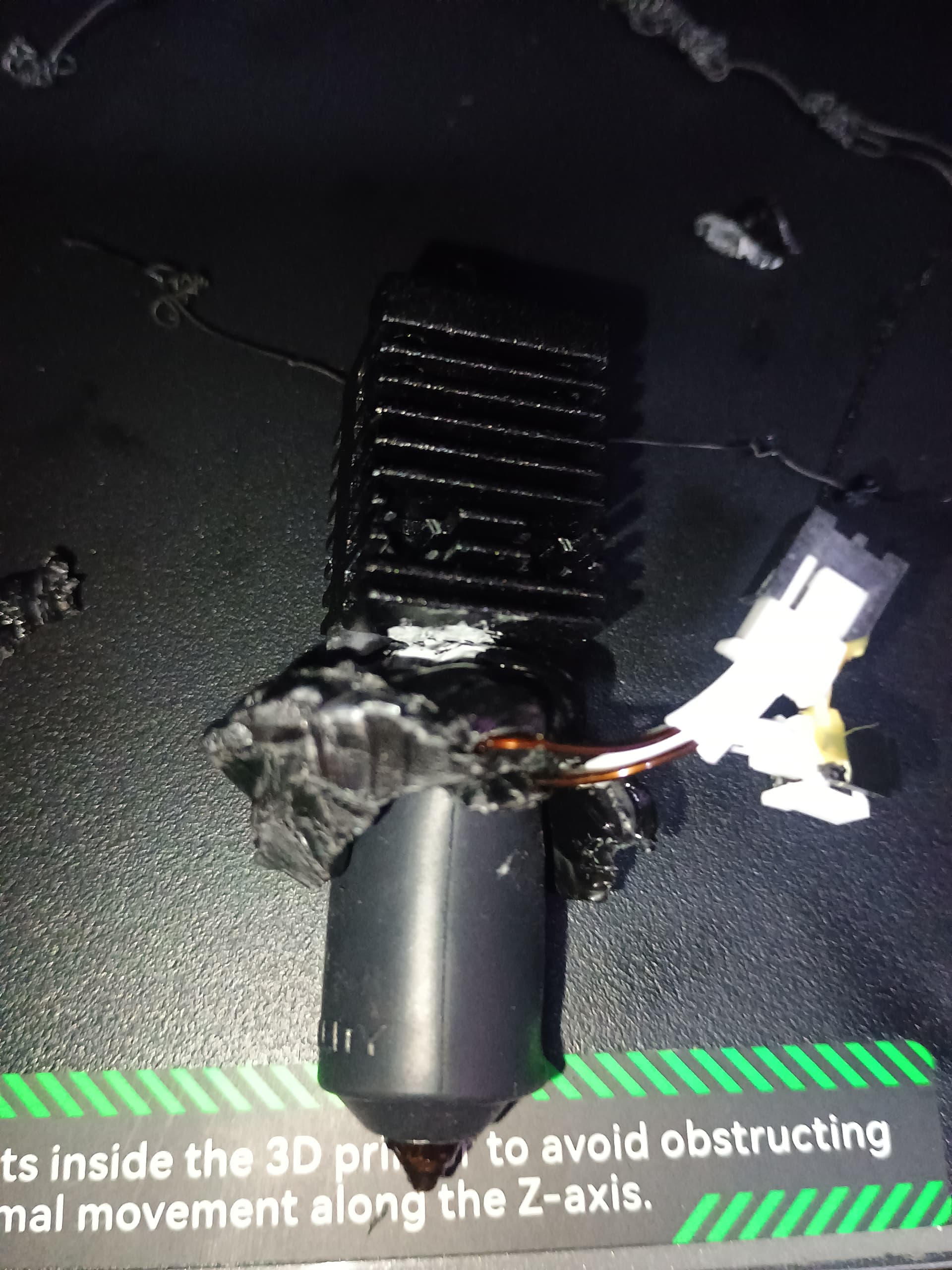

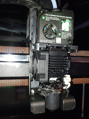

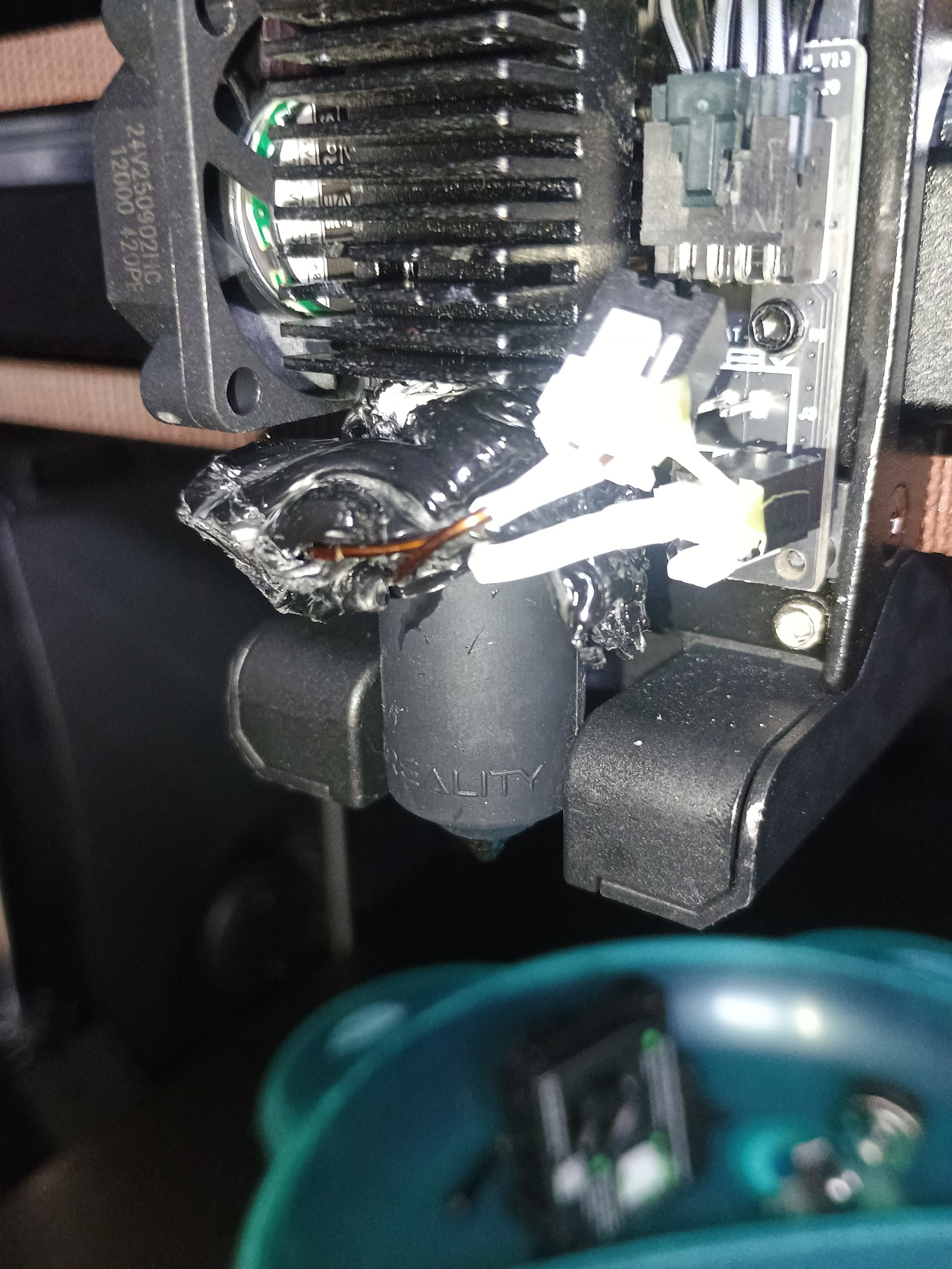

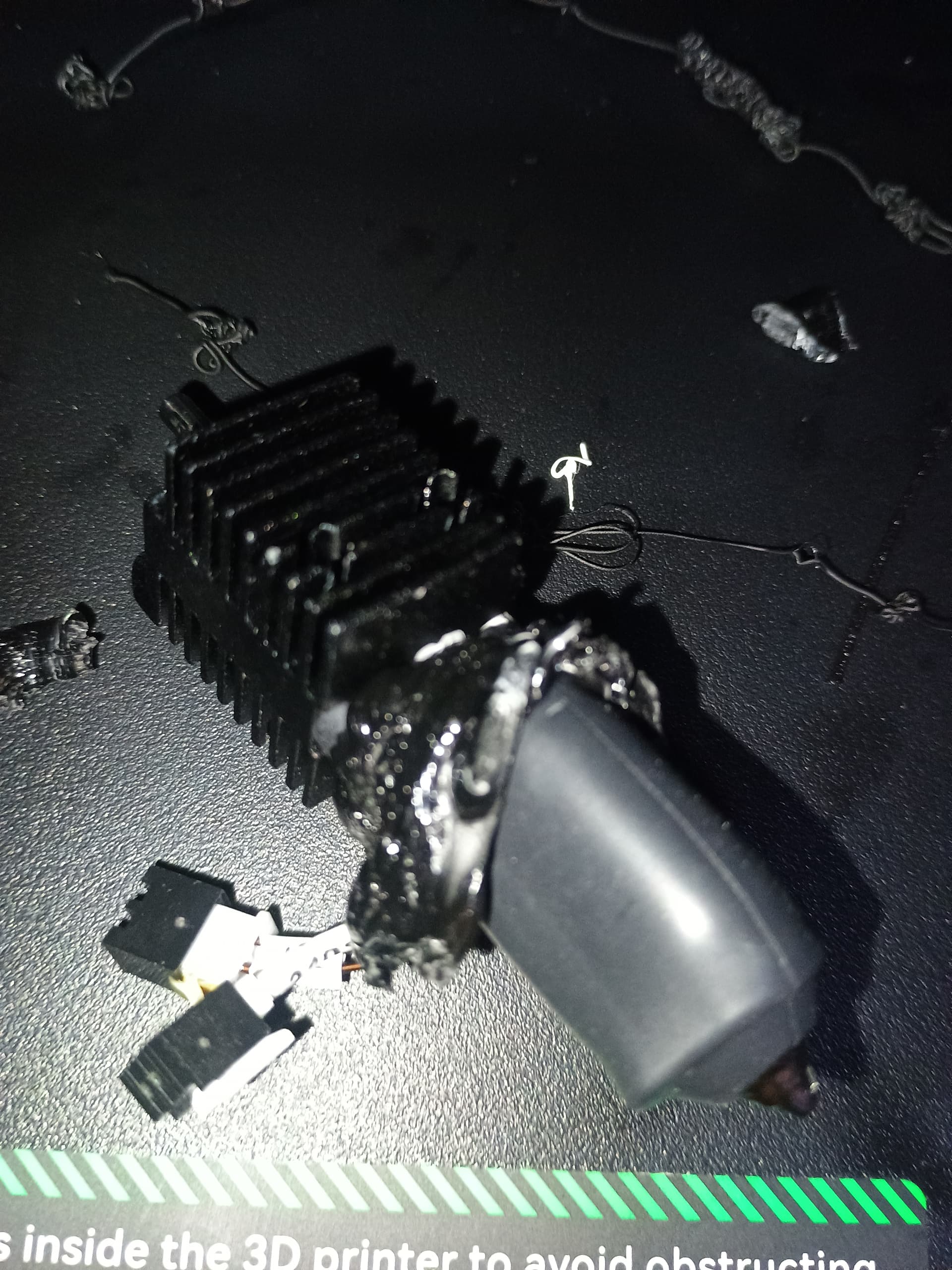

Hello. Two months ago, I bought a K2 Combo (basic model). Today, I loaded new filament and started a print. When I checked how it was going, I saw that a lot of filament had escaped the side of the hot end. I stopped the print and tried to remove it while the part was still plastic (soft). Unfortunately, after a while, the printer reported an error. The heater stopped heating, and I didn’t remove the filament completely. What could have happened and how can I fix it? I already had a minor issue with it, and Creality sent issue the store, which stopped responding. I replaced the filament sensor at my own expense. I think this time I’ll have to do this repair myself… I must by this K2 hot end ? This is the same like K2 Plus Combo?
Thanks for posting clear photos as this takes the guesswork out of what happened.
Welcome to the blob of death. If this is your first time, consider yourself lucky. Your photos show that you got off easy in that only the assembly appears to be affected, and that is easily replaceable, designed to be so, for under $25.
Your photos show you did 99% of the work by getting the assembly removed.
Here’s a link to the K2 assemblies that come with a nozzle. Assuming you’ve cleared out all the other molten filament, it should be a drop-in replacement with an Allen wrench. If your printer didn’t come with an Allen wrench, look for a hotend assembly that includes it in the kit.
Prices range from $13 - $32 for the “Creality Branded” version which often includes extra screws and an Allen Wrench. They all come with a nozzle usually 0.4mm but if you shop, you might find other sizes. It’s only worth mentioning because your current nozzle is salvagable and can be used as a spare, so if you can find lets say a kit with another nozzle size, you’ll now have two nozzles. Note, you should not attempt to remove a cold nozzle, it must be heated. A heat gun or jet lighter can be used to heat the assembly outside the printer but take safety precautions not to burn yourself.

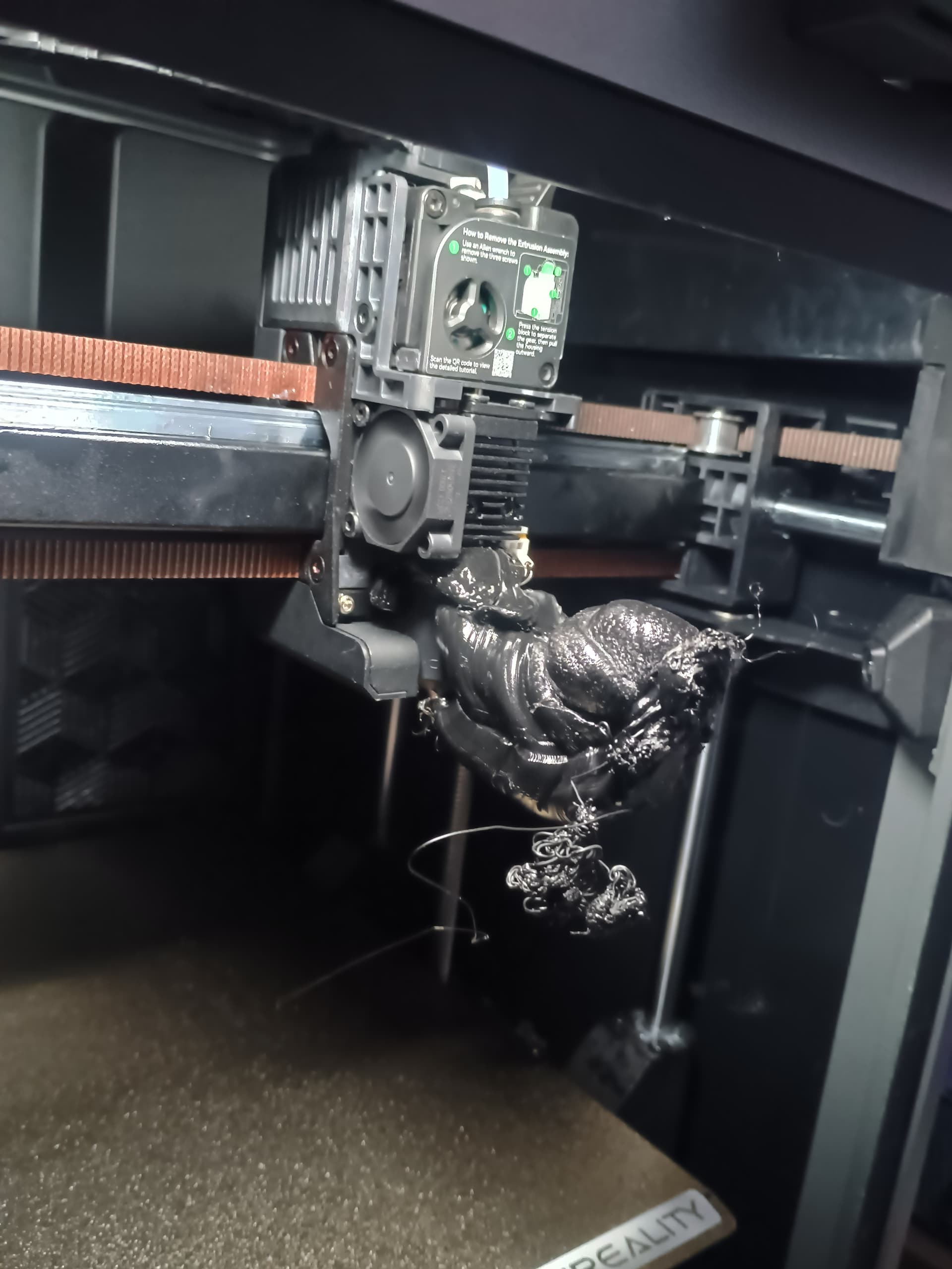

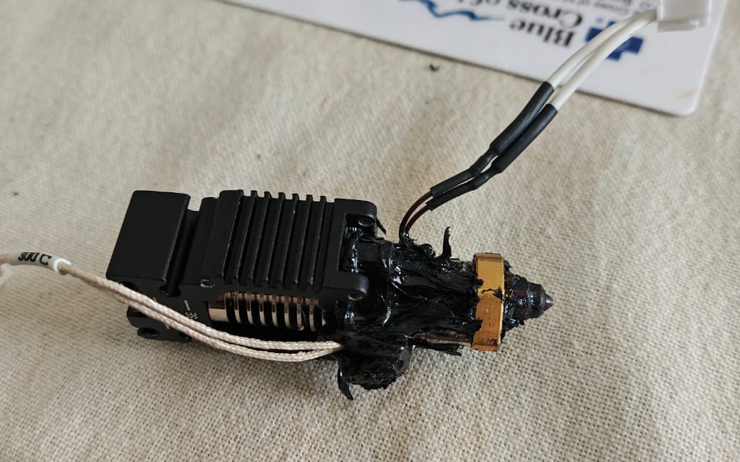

Ahh, the blob has struck. Don’t feel bad. It’s not IF you’ll get a blob of death when in the hobby it’s WHEN you get it.
I had a part fail and by the time I found it the part had detached from the build plat and was moving around with the extruder. Needless to say it was just a big blob.
This is after I pried the big part off. I cleaned it up by just picking at it then I used my heat gun to heat up the rest and wipe it off (be careful, don’t burn yourself). Once I had the outside clean I took the nozzle out and replaced it.
