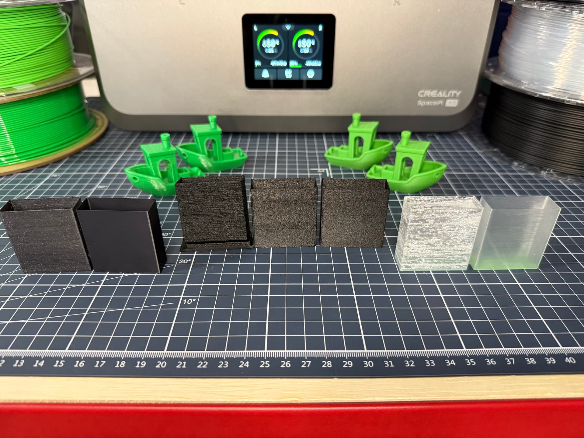

:test_tube: I ran full tests across:
  • Hydro-loaded filament (in a homemade Chaos Chamber)
  • Wattage + decibel readings under load
  • Timed temp metrics
  • Moisture recovery tests on PLA, PETG, TPU, ASA, and PPA-CF
  • Before/after print comparisons for each filament

This thing handled everything I threw at it — and then some… I even ran a 32-hour PPA-CF dry to see how it held up over long durations (spoiler: it did great).
