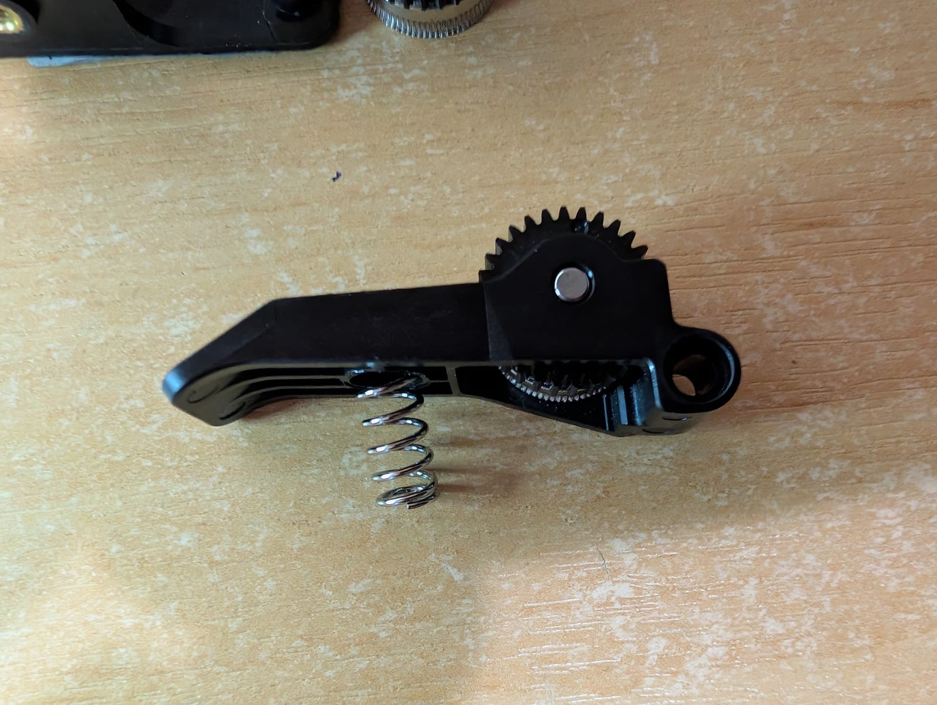

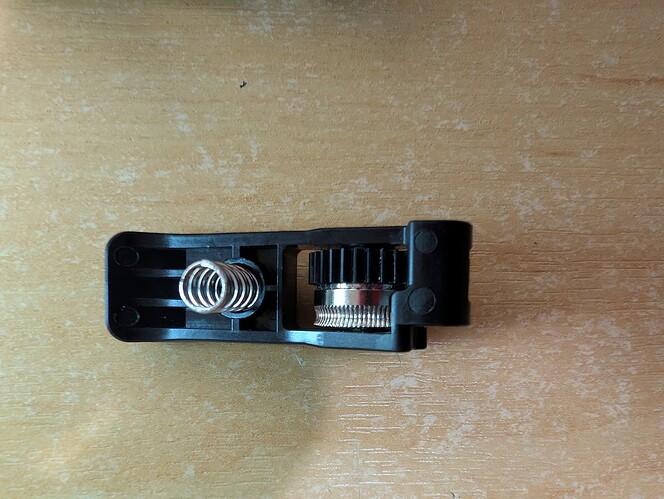

To reinstall, the trick is to put the spring in the lever, NOT the slot on the extruder body; it is more secure that way. Keep it in place with your left thumb whilst you “half-mount” the gear into it’s recess with your right hand.
Photos as promised;

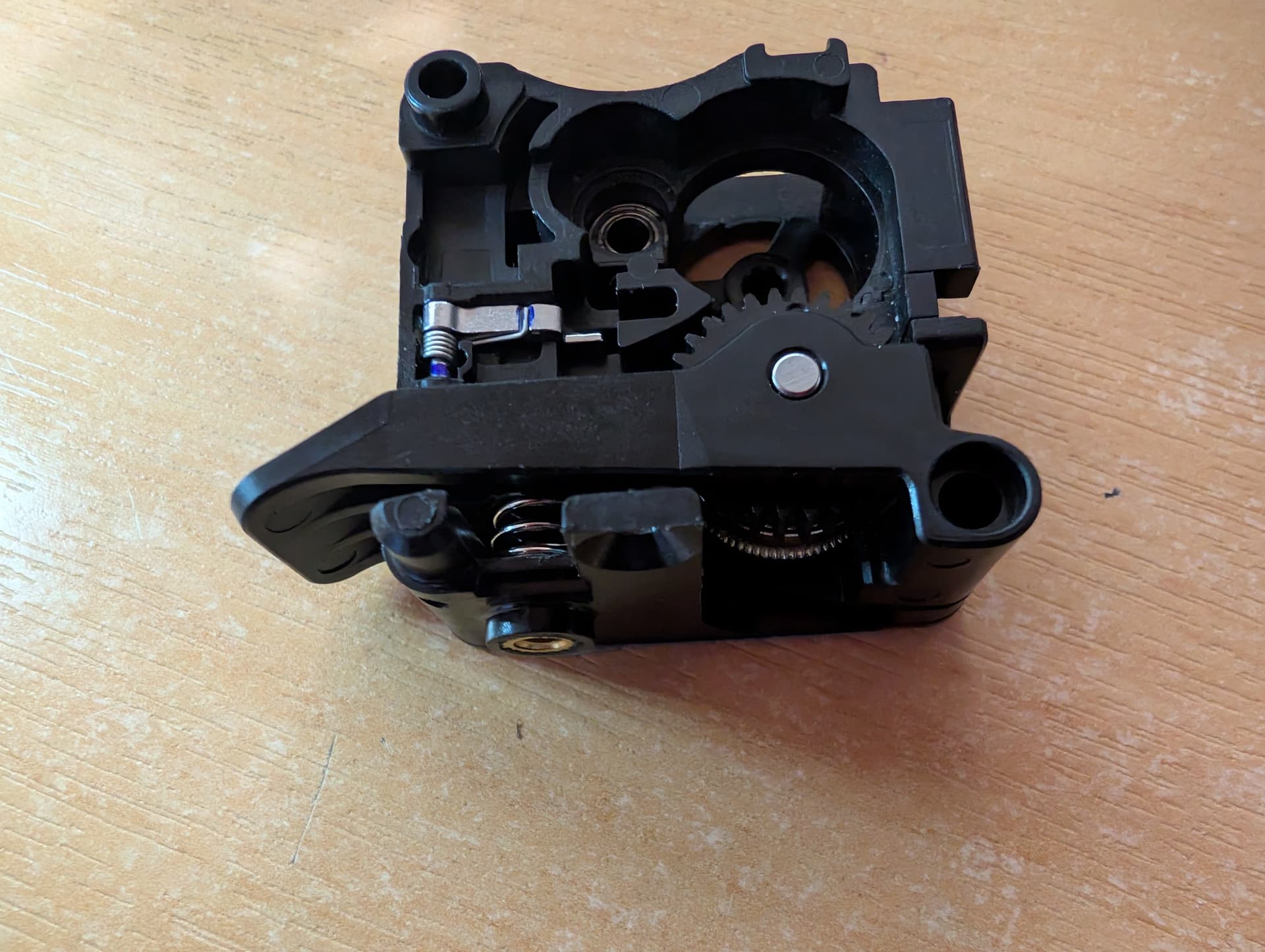

Then the trick is to bring the lever towards the body at a slight angle. With one end of the spring correctly located in the lever, you should be able to angle the opposite end of the spring down so that it rest inside the body where it is supposed to.

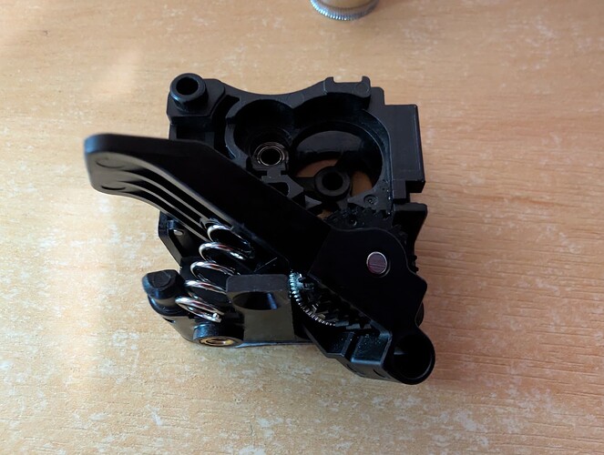

Using a reverse of the “lift and twist” method that removed it, you can “twist and press” the lever arm to both compress the spring into its spot and complete the mounting of the lever.

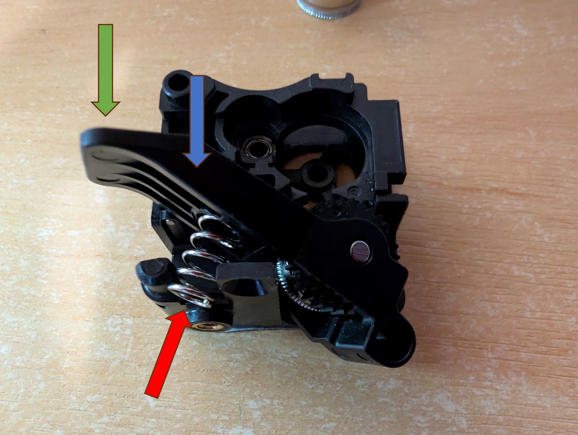

Additional instructions for following photo;
RED Arrow - use left thumb to compress spring and partially engage with slot.
GREEN Arrow - use left index finger to compress spring fully.
BLUE Arrow - use right thumb to press the lever down into the casing
It was surprisingly easy, but…disclaimer…I’ve done it once (Edit: twice! Yay!). The next time I have a clog (how I wish that was “if”, not “when”) I’ll try and video it. (Edit, no I won’t it’s impossible to do both!).
