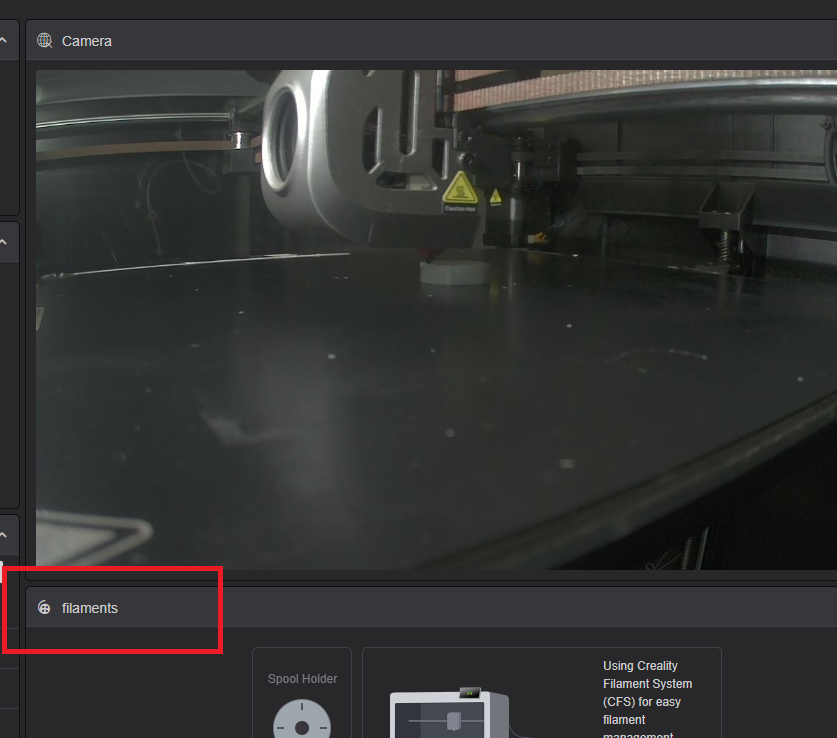

You do not have to revert the firmware settinmgs to fix this. In Creality print, click the Device Tab.
If necessary, click the Details button to show the full details.
Below the camera view, you will see a filaments section.

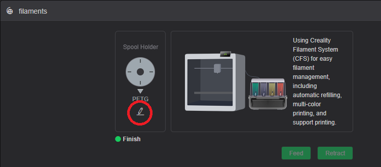

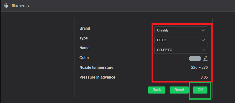

Click the pencil icon on the spool holder section and fill in the fields to match what is on the spool holder and click OK.
Now you can start print with out the message, as long as the print setting now match the printer supplies.
Thank you! It fixed the issue
