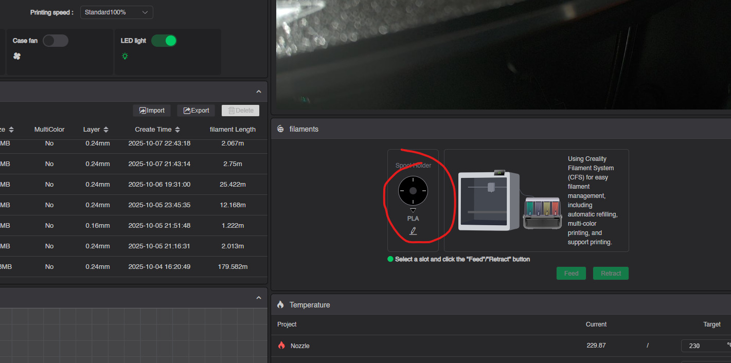

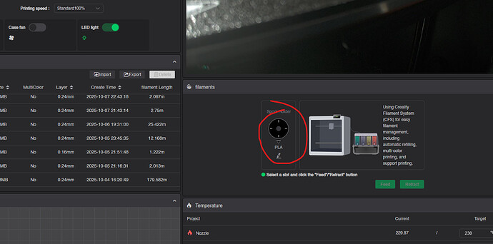

open Creality print
go to device
select the filament tab
select the single holder
select your filament
press ok
print will start :wink:

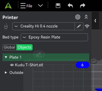

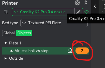

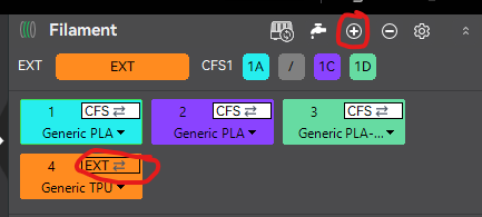

Before slicing the plate, make sure that the plate is set to the material that you want. In the image below the material is the blue button with the “6”.
It took me ages to find figure this out…
Dont forget to apply to object
After slicing select spool holder and send print.
I was showing the EXT filament but was unable to apply it to objects.

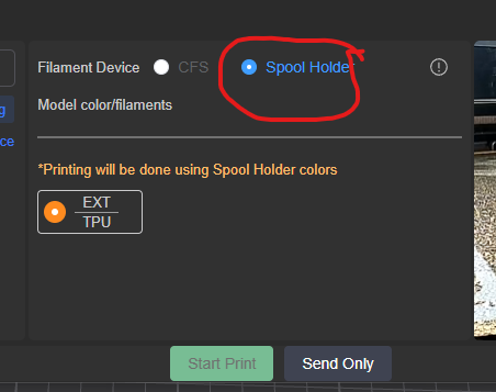

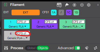

FIX

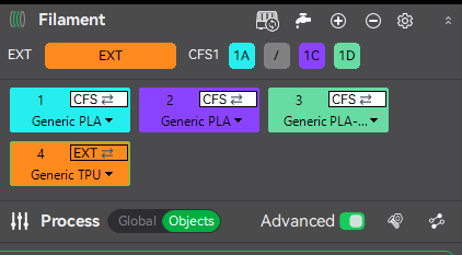

If CFS is connected you need to Add a filament.
Once added click the CFS on the new filament and change it to EXT.
.Click the plus. New filament will added.
Click the white CFS icon and change to EXT
this really help me. tq so much
This comment actually helped and was exactly the problem for me…. Creality needs to make this concept more user friendly so that I don’t have to scream and and rant and waste 30 minutes of my time.
Thank you very much. That was driving me crazy.
Thank you so much! This was really helpful. I didn’t disconnect the CFS. It’s possible that I initially had the TPU go from the top instead of through the tube, which is why I didn’t have the CFS on. I remember reading that it’s best when printing with TPU, and now I’ve gone ahead and started the print, hahaha.
Let’s see if it fails; then I’ll start over and feed it from the top….
