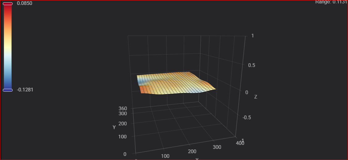

You will collect N mesh matrices, each representing the measured height of the nine points. In a perfect world, the matrices would be identical, but no measuring instrument is perfect. The only real question is whether the observed deviations are acceptable given how the measurement is used.
I ran the experiment 10 times (you should try it—it’s quick since there are only nine points). Your results will differ from mine because every machine is different, but you will likely see the same pattern. Here’s what I observed on my machine:
  • The maximum deviation between the 10 measurements for any of the nine points was 0.068 mm, which is 34% of a 0.2 mm layer height.
  • The average absolute deviation across the 10 measurements was 0.032 mm, or 16% of a 0.2 mm layer.
With a supposedly constant flow—which already puts the extruder under pressure to compensate for pressure variations—it’s easy to see how this leads to ripples and lifting that ruin the first layer. The measurement error at each point of the bed is simply too large to produce a reliable first layer.

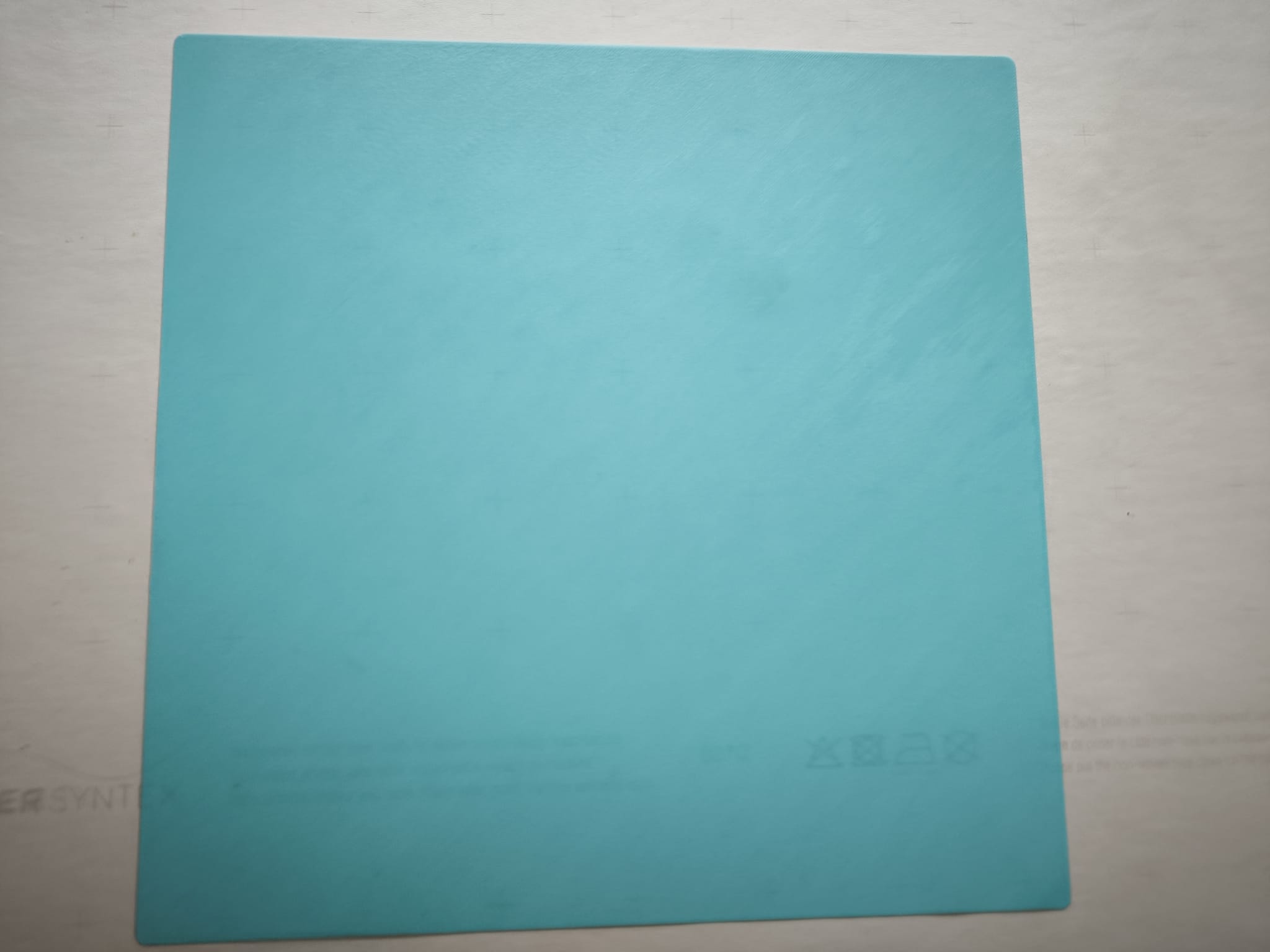

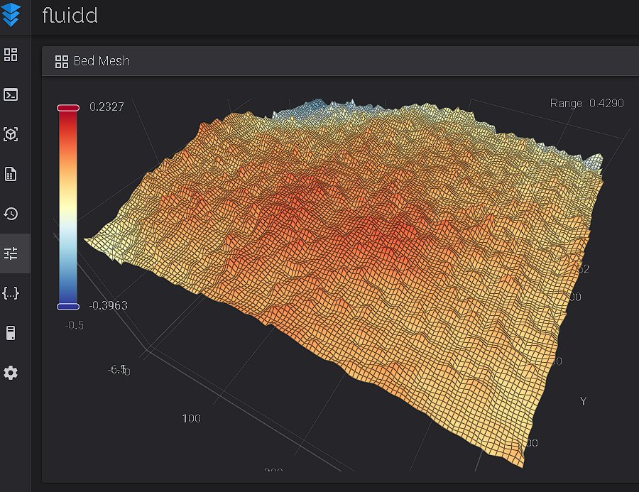

MY RESULTS
After validating the method with a 13×13 grid measured 10 times, the resulting mesh produced an almost perfect first layer up to a 250×250 mm square. Minor defects appear beyond that, more visible as the print size increases. This is due to a fundamental limitation of interpolation algorithms: they cannot interpolate accurately near the edges, and even less near the corners.
With a 13×13 matrix, the outer 25 mm border is poorly reproduced. The closer you get to the edge, the worse the approximation. To print larger areas, you must increase the matrix size, but measurement time grows with the square of the grid size.
Being a compulsive perfectionist, I pushed things far beyond reason. With a 65×65 matrix (4225 points) measured 17 times (two full days of measurements), here is the resulting mesh (range 0.4290 mm—not impressive on paper):
But in practice, it allows me to print a 348×348 mm first layer (leaving room for a skirt) with perfect repeatability, as shown here:
I’ve been using this mesh for two weeks. I’ve printed large PLA parts and smaller TPU parts. I will never repeat this experiment—it produces a level of perfection no one actually needs—but this will remain my reference mesh until I’m forced to modify the bed. (As a precaution, I never touch the magnetic build plate.)
This experiment makes one thing unmistakably clear: the machine itself is not the problem. The K2 Plus delivers excellent flow control, applies mesh compensation reliably, and is mechanically solid. The only real flaw is a software decision — CREALITY’s choice to prioritize mesh‑calculation speed over mesh quality. That trade‑off cripples first‑layer consistency, and users shouldn’t be forced to live with it. CREALITY should simply give us control: a parameter that lets the user decide how many times each probe point is measured. One small change, and the entire first‑layer experience transforms.
