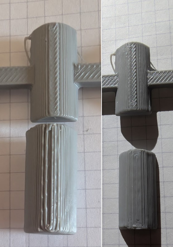

Having managed to improve this;
to this;

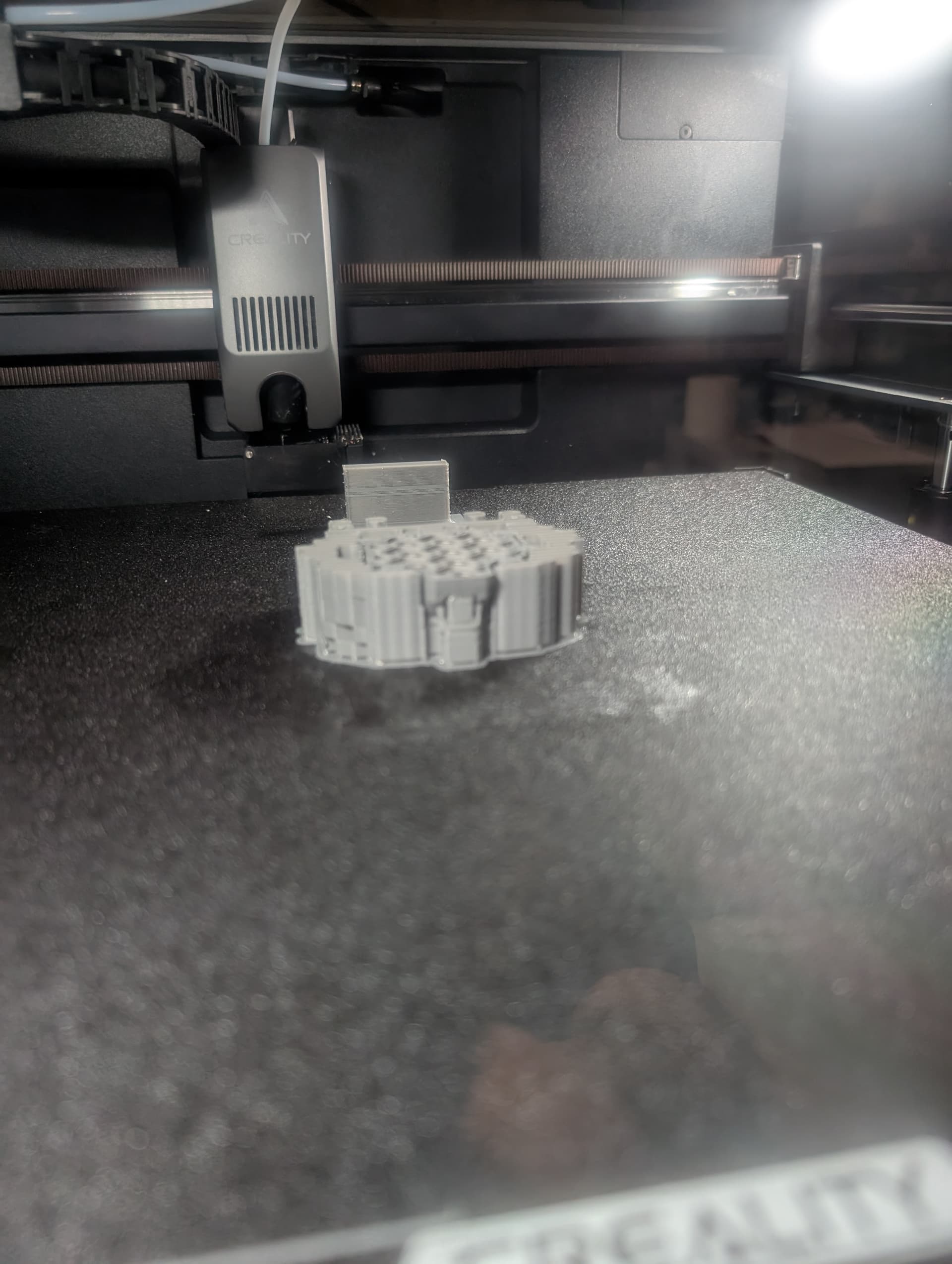

I’m trying to print the perfectly-supported-but-not-damaged-by-removing-it print. Right now it looks like this;
Is spending more time at the waste chute than an Englishman who has tried a Thai Jungle Curry for the first time;
…and still has six and a half hours to go.
Yeah, I’m not sleeping tonight, am I?
Or, a dunny if he was in Australia.

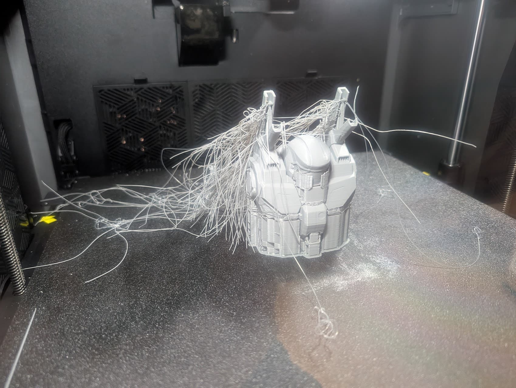

Couldn’t keep my eyes open so went for a nap. Just gone back to it and the purge block has toppled (the model being not the only thing with weak interfaces of course) I’m going to take a risk on the spaghetti and leave it running. It says only 26 minutes left but I’m not sure I believe it…

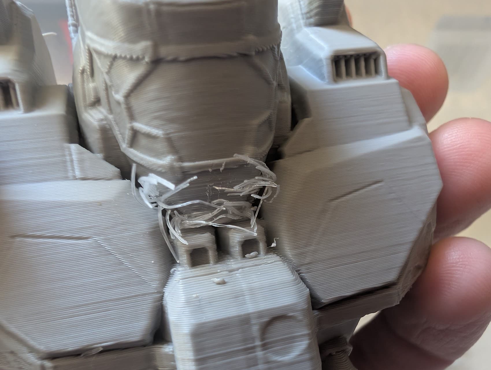

Well, it finished and it looks like the nozzle threw streamers to celebrate…

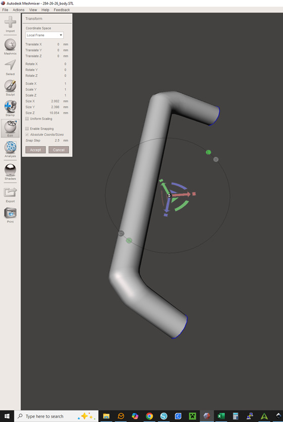

The improvements to the cylinder in the OP made me think it might not be,
The idea was that the quality was so poor because in supported areas the nozzle wasn’t working on a solid surface. You can’t make the support 100% solid and intimately close to the model because then it’s not support any more; it’s part of the model and you’ll never get it off.
So - support material. Something that will form a good enough surface, but not stick. There are a few of them, including water soluble ones that have the advantage of requiring no force to remove. But I decided to try the “Support for PLA/PETG” by Bambu.

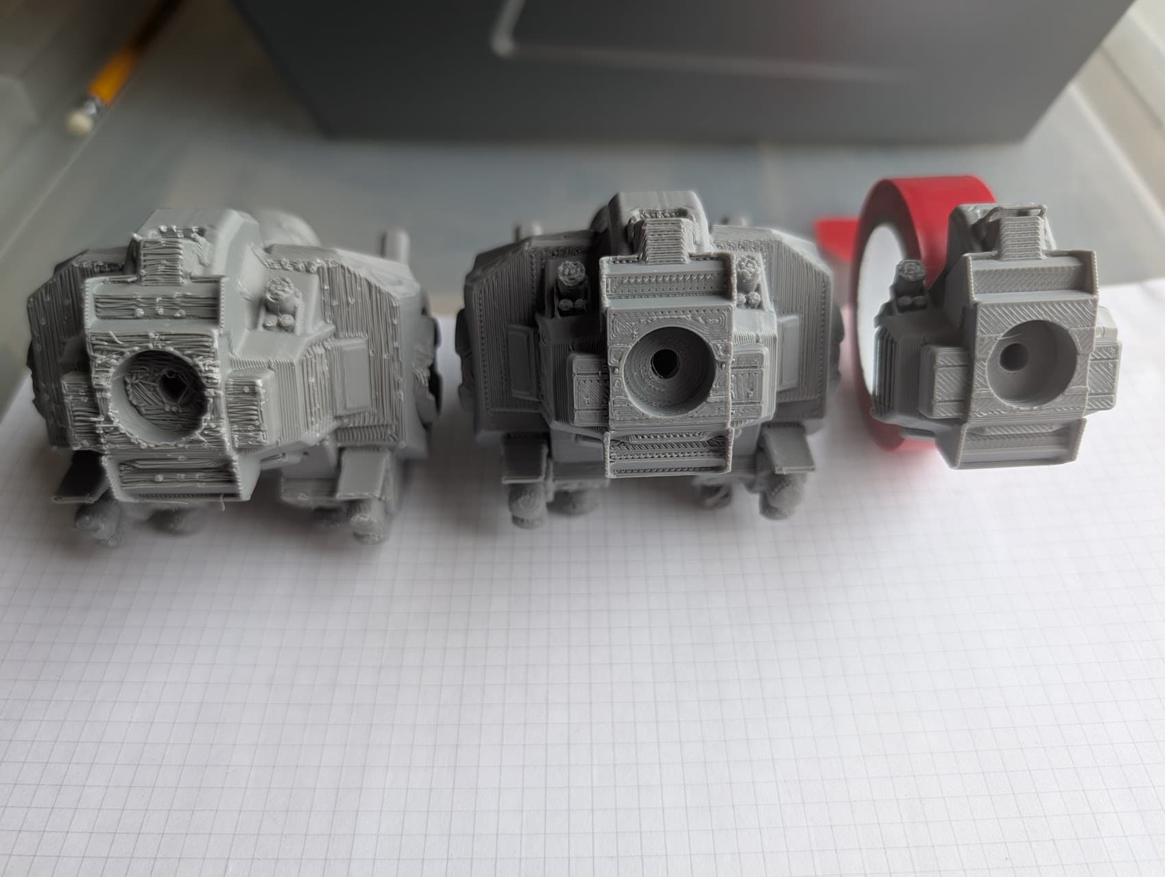

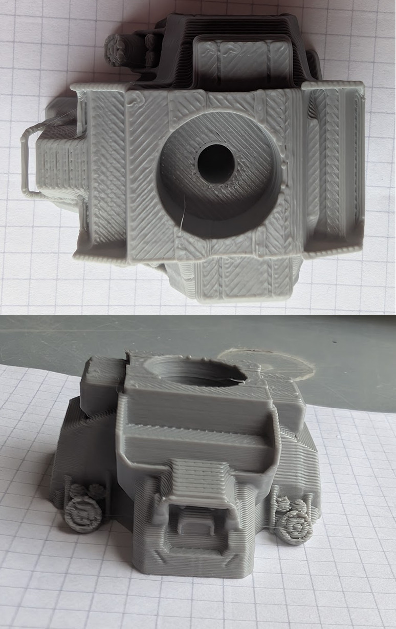

Right…on to the good stuff. Remember that last 15-minute print? Here it is;
It’s just the bottom of the Mech, sliced off and turned upside down, printed without supports. This is my target. Note it includes the handle detail (far left of the top pic) and reveals that there is detail in the exhaust ports, which I hadn’t even noticed before.
A nod here to the K2+. I can’t overstate how impressed I am with it’s ability to print a 0.83mm diameter handle over a 10mm distance with a 0.4mm nozzle. The room for error must be precisely zero. Round of applause for the Creality team please!

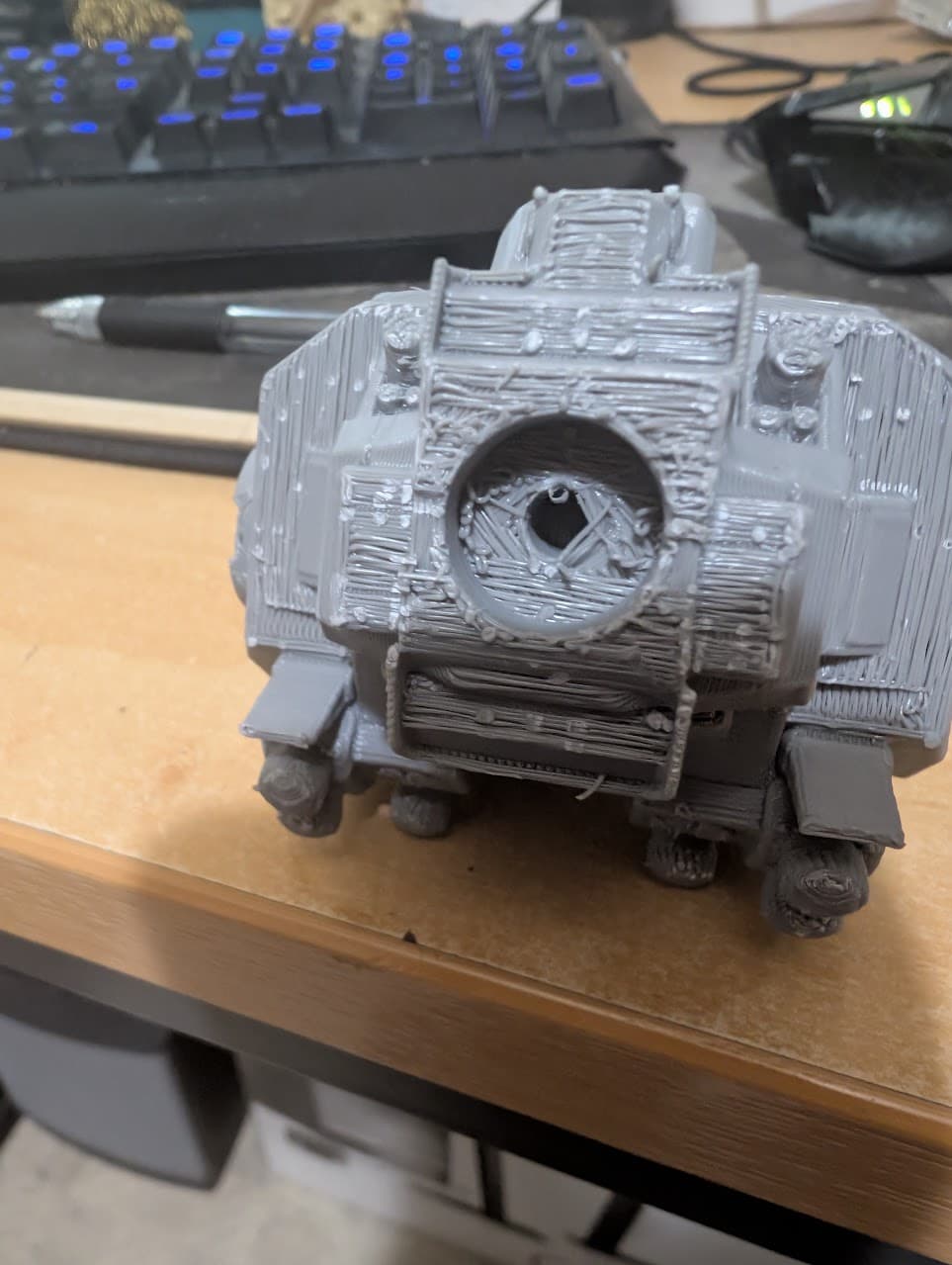

Here, sad as it may be, is the surface I was getting from using “traditional” support methods…
Note the complete absence of handle (should be at the top of this picture) which was long ago lost in removing the support.

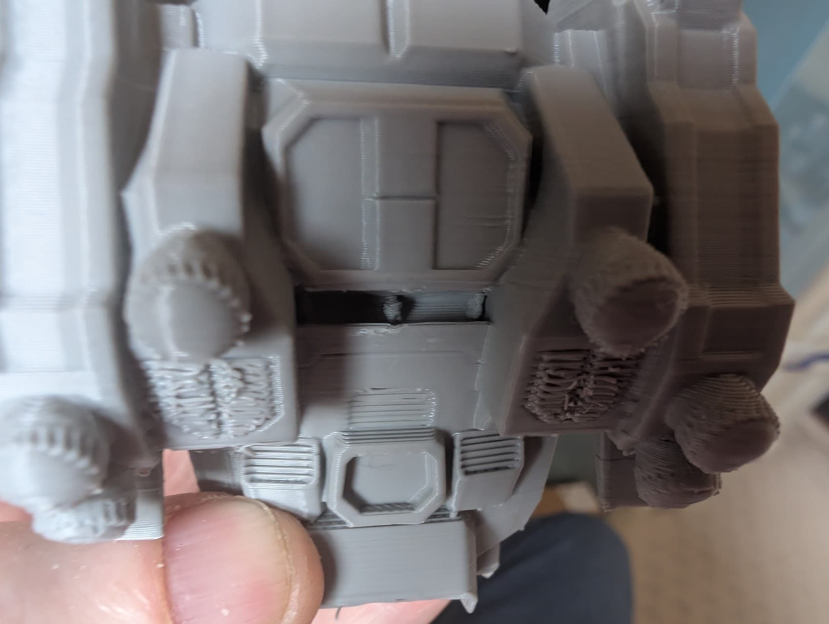

So, a side by side comparison;

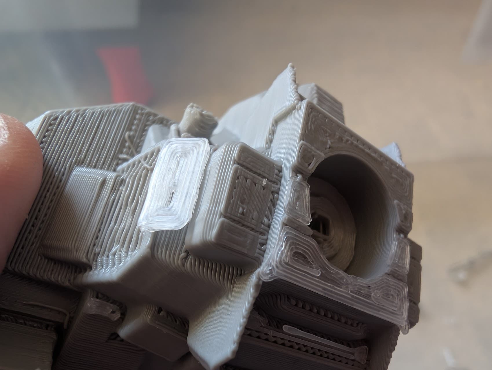

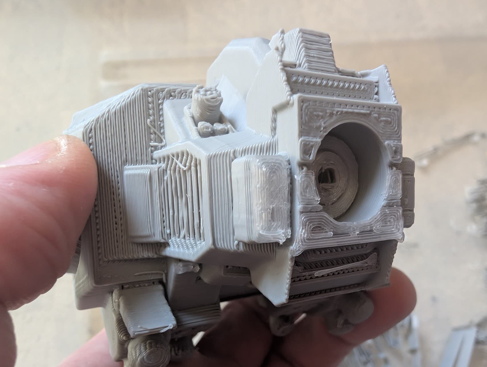

There’s definitely areas where the support filament has worked wonders…remember the stuck “tree” support? Well, this WHOLE VOID was filled with the support filament…and with a tug, it just popped out…
Obviously the same pic shows a failure too, where the support had prematurely come away. If you look closely you’ll also see that the upside down vents are no where near as detailed as the “right way up” one partially occluded by my thumb. This is because I set the X/Y clearance at a massive 0.8 (two nozzles worth) to avoid getting the support physically wedged in places, but it meant that the towers supporting the pods effectively blocked ANY support being given to the vents

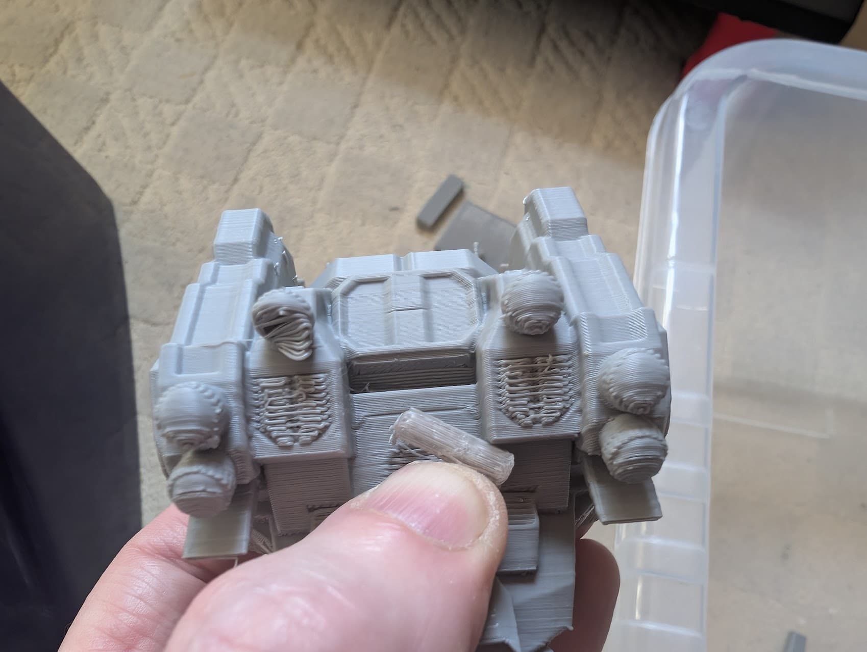

And yet, it still did get wedged elsewhere…

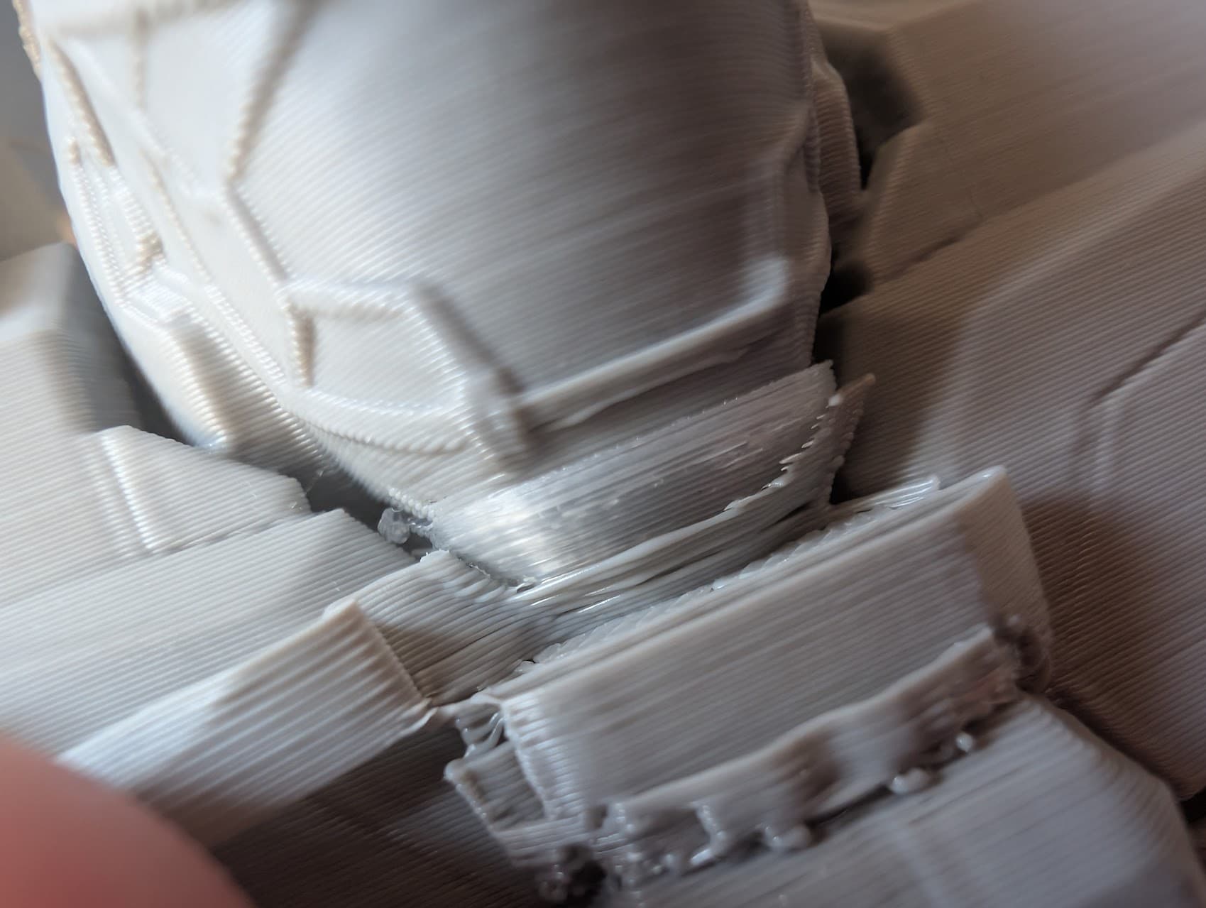

You can see the clear support wrapped snugly around the model’s chin here…
Which sounds ideal, except it led to this…
Because behind that chin is a 5mm void stuffed full of support filament - but only a 1mm or so void to be able to remove it through. Colouring the support filament pink clearly shows this problem in the preview page in Creality Print;
