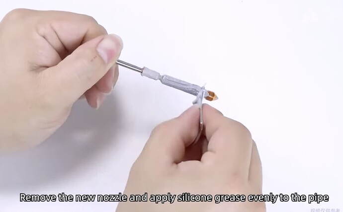

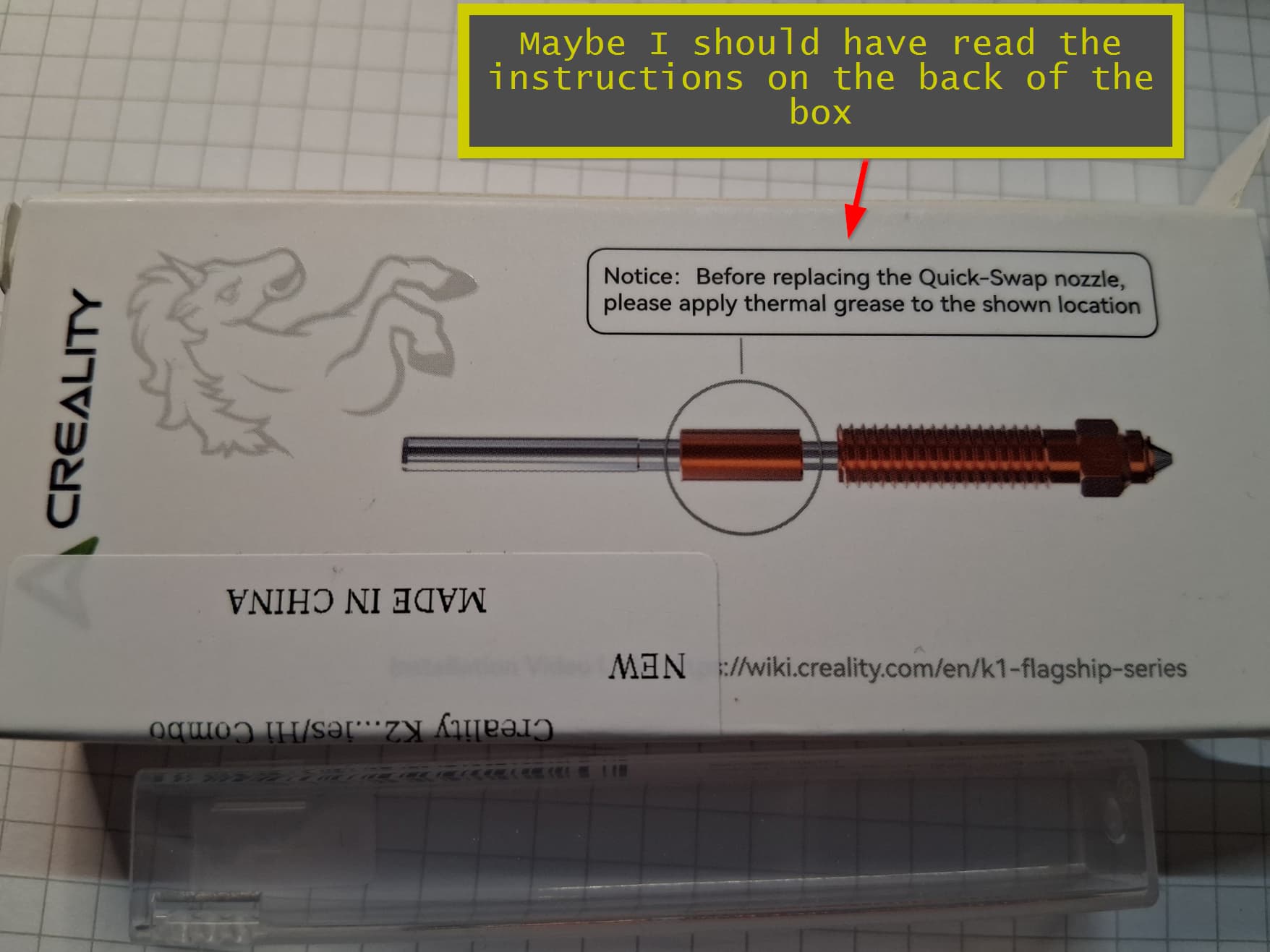

The latest K2 Pro service video shows smearing thermal grease on both the heat break and the nozzle threads. Am I mistaken or has grease on the threads been added to the replacement scenario?. Also any thoughts on the Phaebus nozzles and would the grease protocol be the same? [Getting ready to install]
You do NOT want to install thermal grease on the threads. First, it does not buy you enough in thermal transfer to make it worth it. Second, after a few hours of use, the thermal grease will bake onto the threads and you will not be able to extract the nozzle. Ask me how I know. :angry:

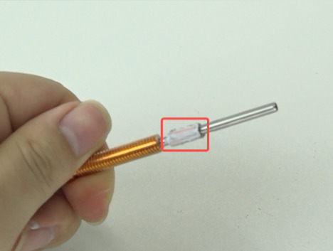

The thermal grease should only be applied to the top half where there contact with the heat sink for purposes of acting as a heat break. You may have noticed that the nozzle there is smooth which allows for easy removal.
This photo taken from: Replace K2 Nozzle | Creality Wiki
Also, there is no thermal grease I have used in the last 30 years that does not eventually transform into ā€œthermal baked-on crustā€ after exposure to long term extended temps. Which is why I say you never want to use it on threads unless you never plan on removing it.

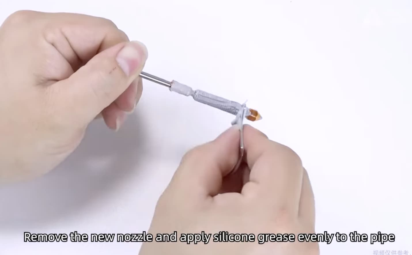

Thanks, That was my thinking too. But take at look at this from Creality:
Thanks for posting that video.
I am speechless. There is no sugarcoating this. The video they show is just categorically bad advice and plane wrong.
The only explanation I can think of is that the video was produced by their marcom department without supervision by a subject matter expert. In all likelihood, they read the script notes incorrectly. I would bet that the written instructions said something like, ā€œfocus the camera on the nozzle threads while smearing the grease on the nozzle,ā€ without understanding that the intent was to apply it only at the heat break. This leads me to believe it was not reviewed before being posted. Someone in their marketing department has some explaining to do. Anyone with even a small amount of experience using thermal grease will have seen it become hard and caked over time. This is particularly true when the product is operated at temperatures closer to 300 C.

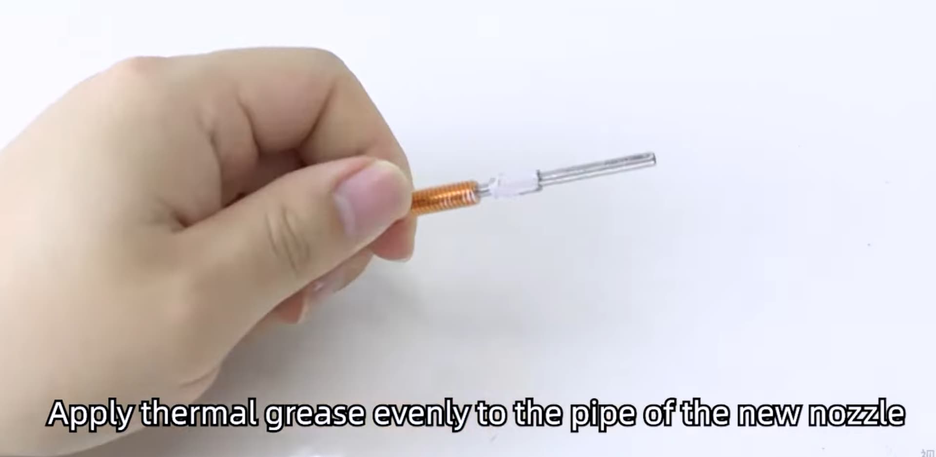

As further proof, look at this other Creality video on their YouTube channel which shows the correct way to apply thermal grease. Time index 1:19 in case it does not automatically start there.
Screenshot from that video.
Sadly, this is not the first mistake I’ve seen on their wiki and YouTube videos. There production value is pretty low in that they seem to take little care in providing video accuracy. More than once I’ve seen examples of sequence error where they clearly included B-roll footage from another video of another printer that can really confuse a newbie if one was counting on the video being accurate. Don’t get me wrong, I’d rather have a Video than none at all but when I consult their video, YouTube always suggest other videos on the same topic. I view those too and then compare which one I believe to offer the best advice.

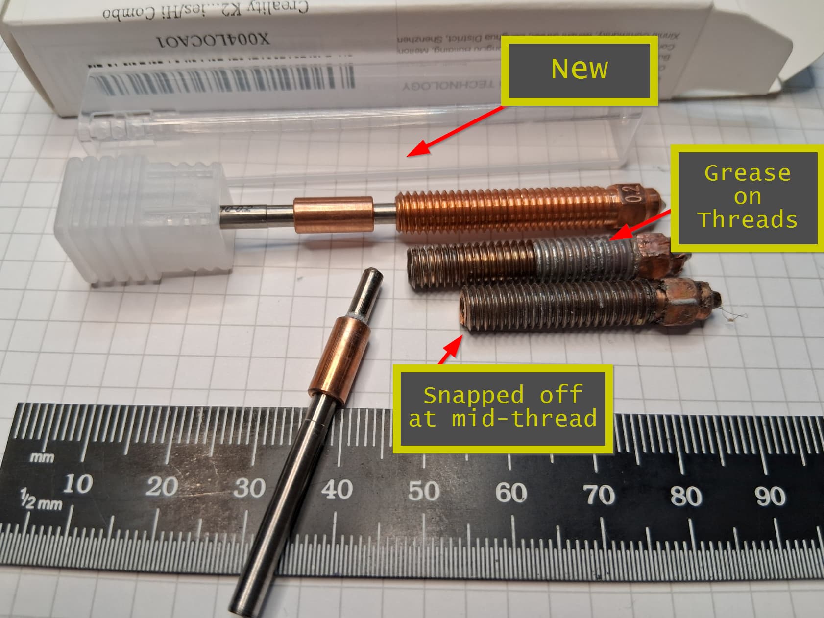

What happened in your scenario did you have to use excessive force e to remove the nozzle or were there further complications?
What happened in my scenario? Did I have to use excessive force, you ask?
You be the judge. :joy: This didn’t happen once but twice to my K2 Plus even after I let the nozzle heat soak at 300 C for 15 minutes before attempting to remove it.
I tried to clean off the thermal grease after removal to see whether the nozzle would operate with a damaged thread. Although it did work, I replaced the entire assembly as soon as the replacement arrived from Amazon. I only kept it in service long enough to complete the swap (2 days), as it was not worth the risk of potentially causing additional damage.
It was valuable lesson that cost me $50 in replacement nozzle assemblies but I am wiser for the experience.
If I can save just one person this kind of aggravation by warning them off this bad video, I will have done my good deed for the day. o7
I have seen the damage done on the nozzle when the thermal paste is on the thread. It pretty much acts like a locking agent.

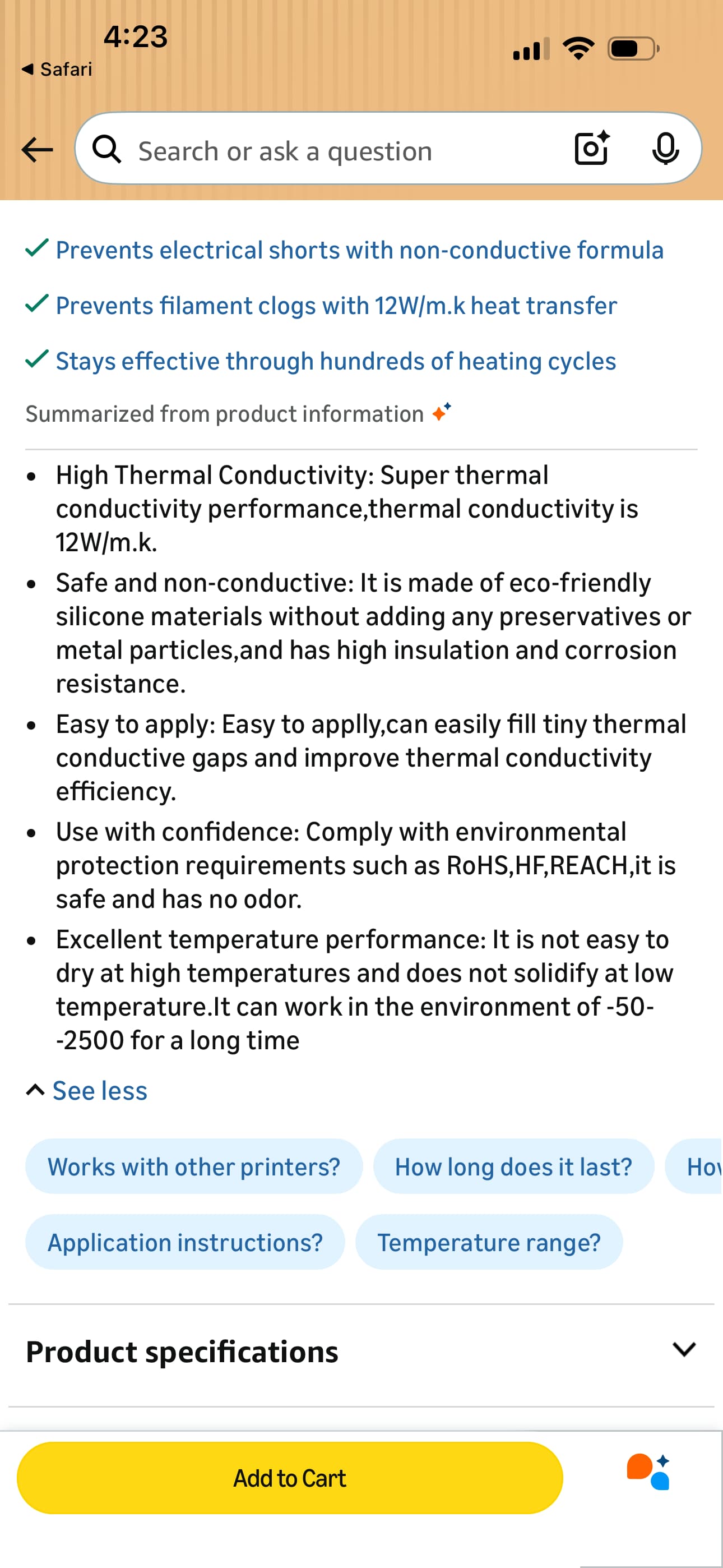

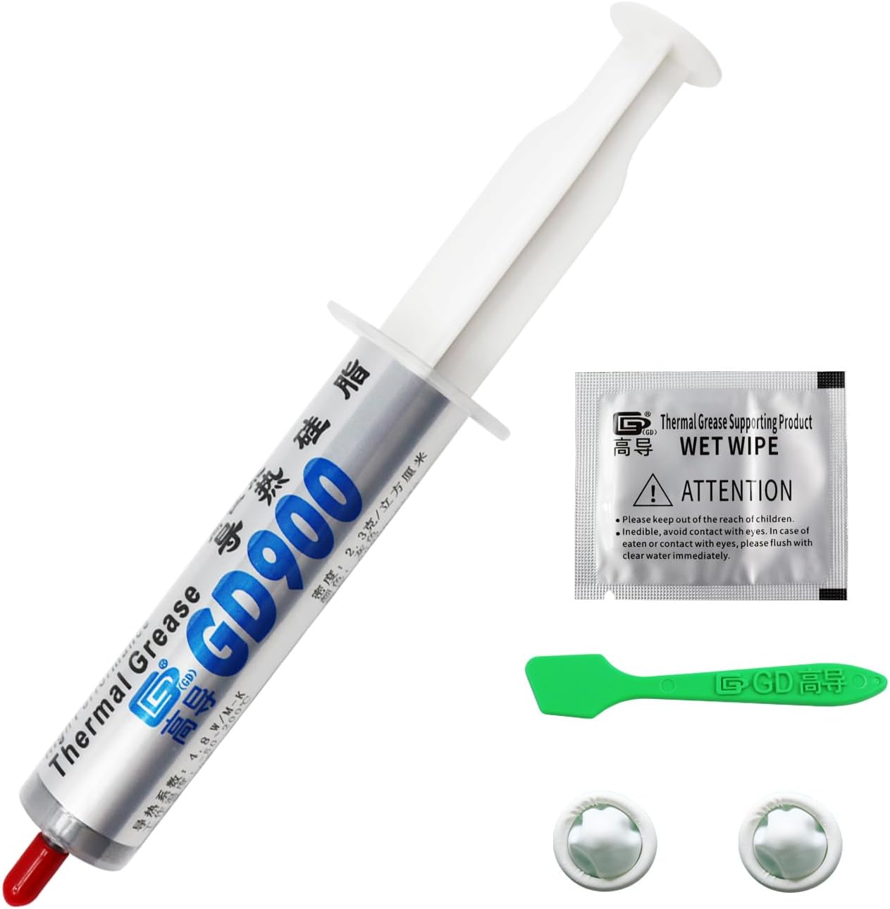

Most of the companies use a variant of this brand(GD900) or similar knockoff. There’s enough YouTube videos that have tested many brands and the main advantage to this one is price, it usually comes in as the second best in performance, the best being Thermal grizzly at 40X the cost. (Thermal Grizzly won’t work on nozzles though as it is a liquid-like material, not paste).
https://www.amazon.com/s?k=gd900+thermal+paste

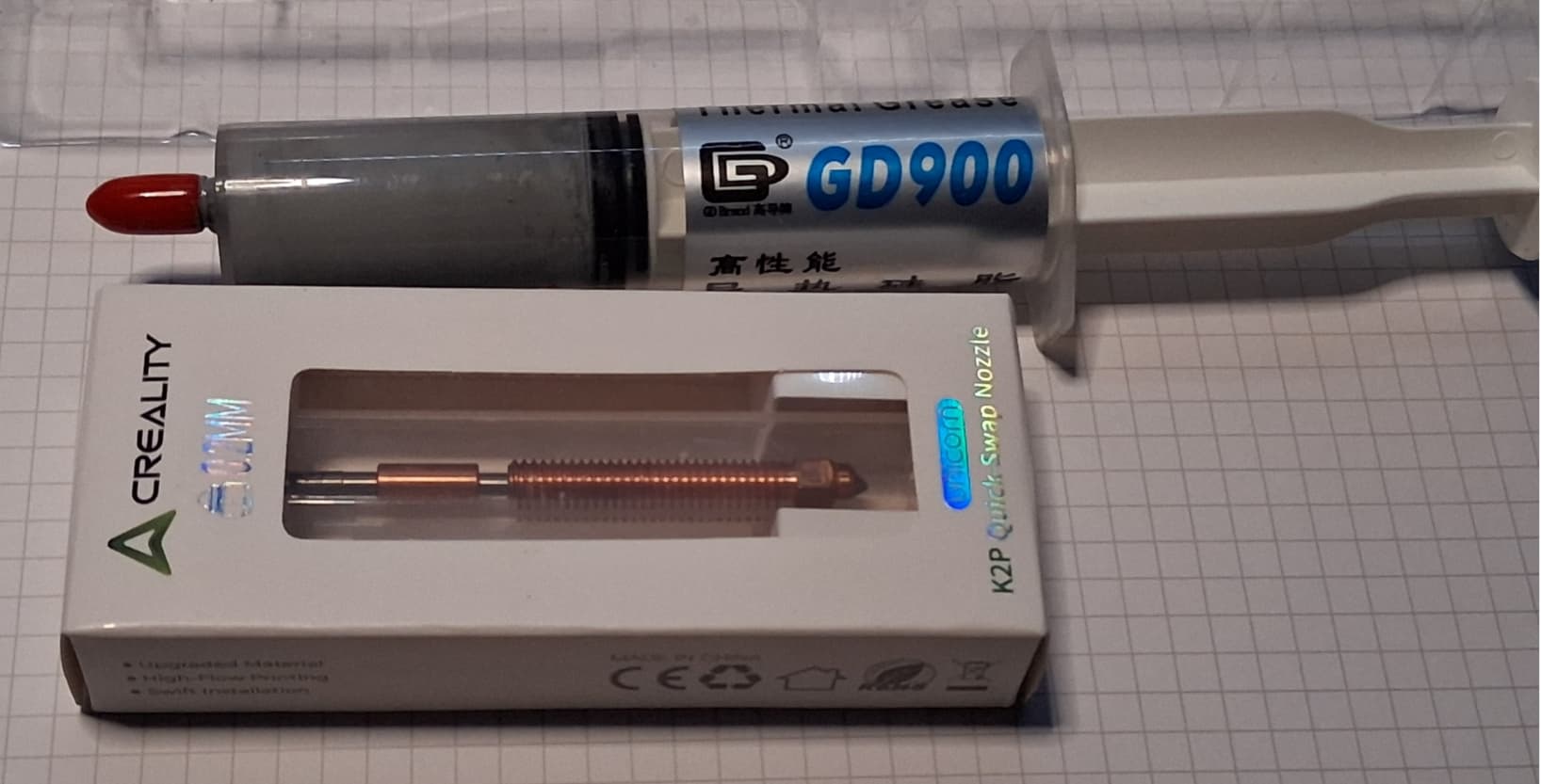

To give you an idea of what a 30g tube looks like. Here it is compared to a K2 nozzle. I’ve been using this one for the last five years and it has never dried out. I keep a couple of them around the workshop.
That is the answer to the magic question. Most of the concerns here were about the paste drying out and seizing up. the paste supplied by Creality definitely dry’s out, but I haven’t had any trouble with it ceasing up. Thanks for the tip on GD900. I’ll give it a try next hot end swap.
