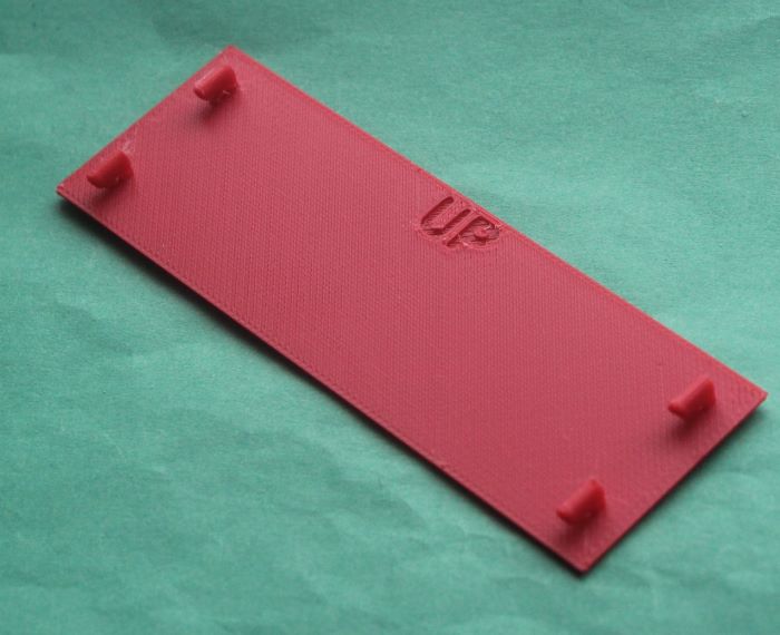

What the heck is going on? I don’t ask much from my printers, and my models are simple; this one is a holder for 1”x3” self-stick labels. It’s just a 1”x3” flat rectangle 0.05” thick, with four hooks on the rear; photo attached. It prints face-down on a smooth metal build plate (with glue) to get a smooth front face for the label.

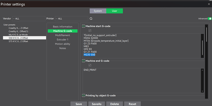

I also found that slowing your print down can nearly always fix most prints. On my printer, I set up two new printer settings that I title S50 K1C 0.4 nozzle and another I title S75 K1C 0.4 nozzle. All you have to do is create a copy of the printer setting you have been using then add the g-code at the end of the start string “M220 S(percent of normal speed you want)” . I usually use 50 if I have a layer shift failure, and 75 if I am having other quality problems. Below is a screen shot of what the g-code change is that I’m talking about. By the way, this seems to just reduce top speeds and it doesn’t increase print time all that much.
I hope this helps you some. I rarely get feed issues anymore, although I do sometimes get problems with the filament breaking or getting stuck in the buffer but they’re relatively infrequent and easy to fix and I haven’t been able to find a fool proof fix for that yet but I’m working on it.

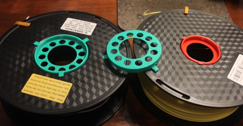

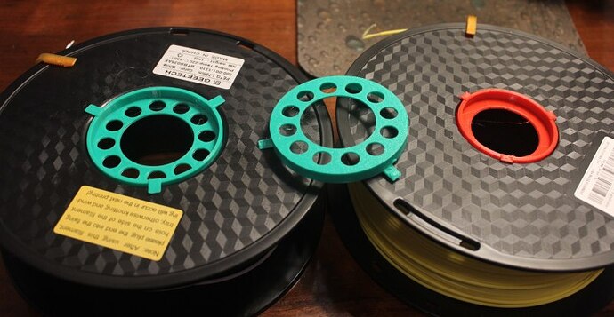

My K1C doesn’t have CFS, just one spool on the OEM spool holder. Long ago I designed “hub bushings” that I glue to every spool of filament. The thin profile produces less friction than a full-width hole. Photo attached. I use “amazing Goop” to attach them so I can remove them for reuse when the spool is empty.
Needless to say, each pair of bushings is unique to a specific spool. Vendors can’t seem to standardize on hub sizes. 8^(
