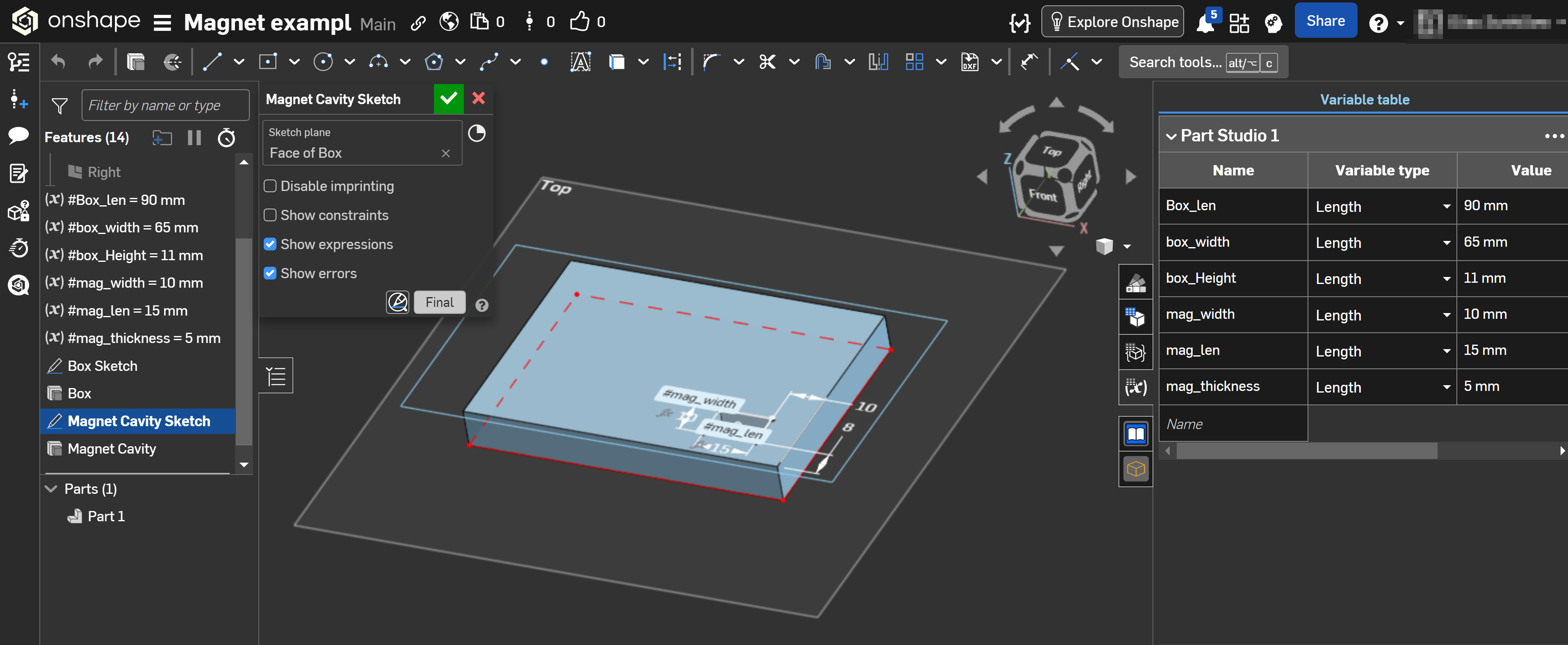

What parametric CAD tools do that TinkerCAD, SketchUp, and Blender can’t:
  1. Maintain a full edit history so every operation is revisable, rearrangeable, or copied.
  2. Assign parameters (length, width, diameter, etc.) to any feature.

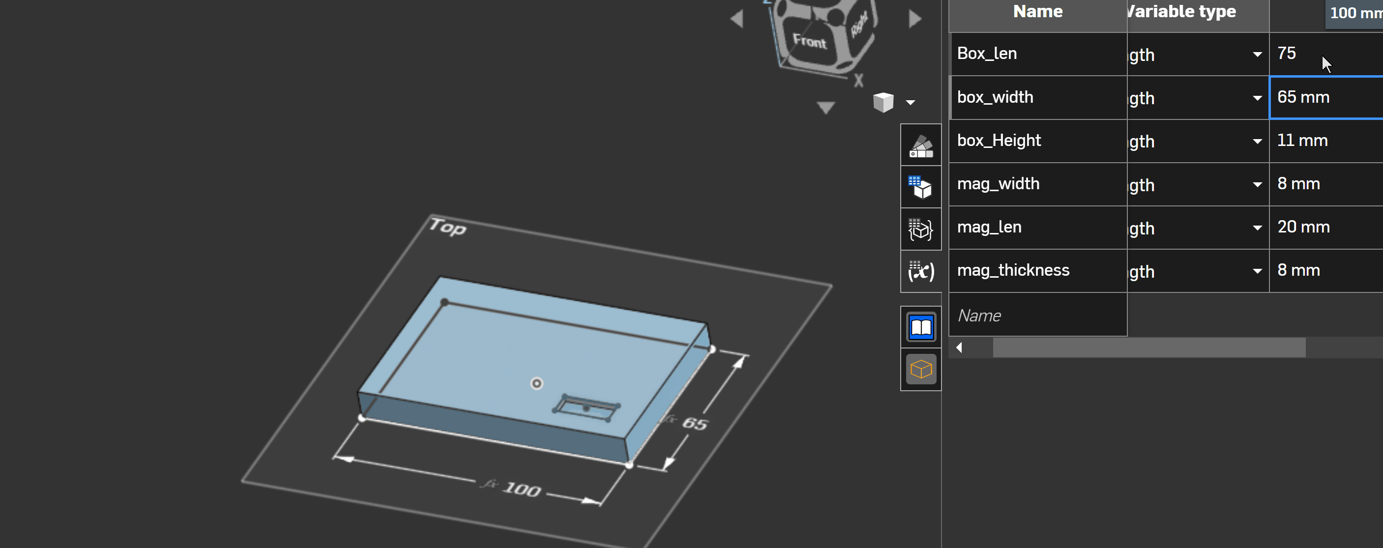

  3. Use variables and constraints to link dimensions, so changing one value updates all related geometry. Example: if a magnet slot is constrained to the edge of a box, resizing the box moves the slot accordingly without further manual edits.
Example: A simple box with a magnet hole anchored to the bottom-right corner. Define parameters and variables up front, so later edits (like changing box or magnet size) update everything automatically—no manual corrections needed.
ONSHAPE
For solid tutorials, see Teaching Tech on YouTube: https://www.youtube.com/@TeachingTech/search?query=onshape
