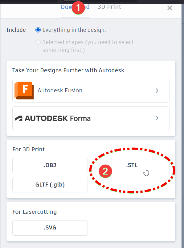

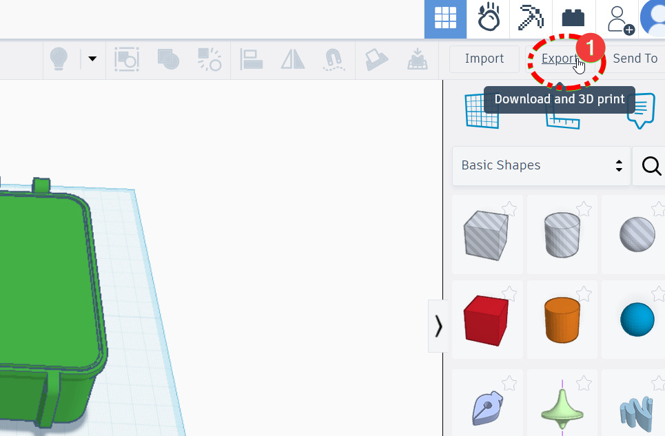

On ThinkerCAD you can export to a STL file using the export shortcut on the upper left part of the screen:

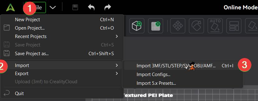

this generate a SLT file which can be open on the Creality Print slicer

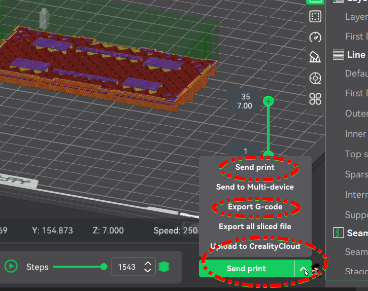

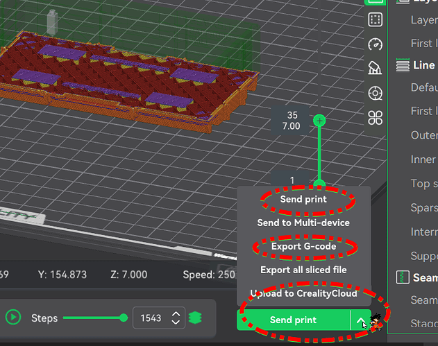

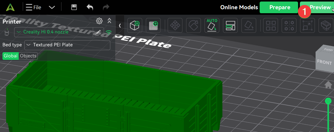

Once you imported the file you can go to “preview“
to test how the printer will create the piece.
From there you can print, create a file with the code or upload the printing to the cloud and print from there

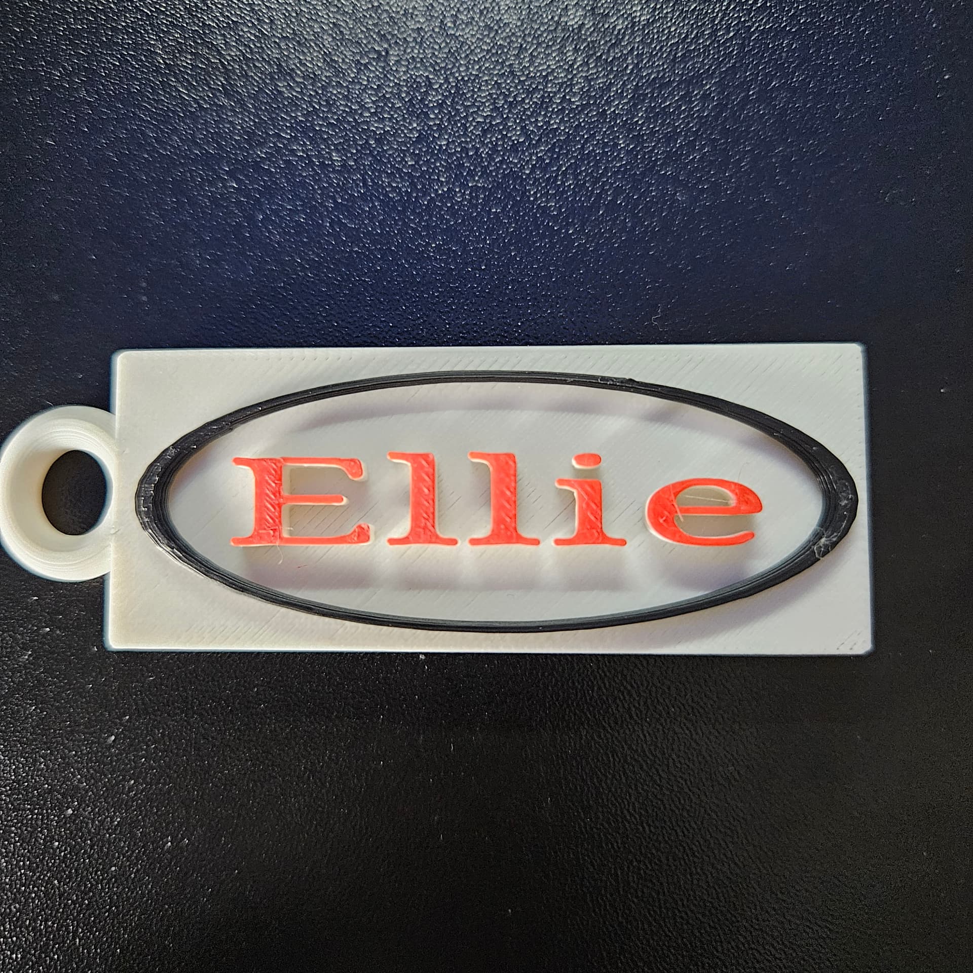

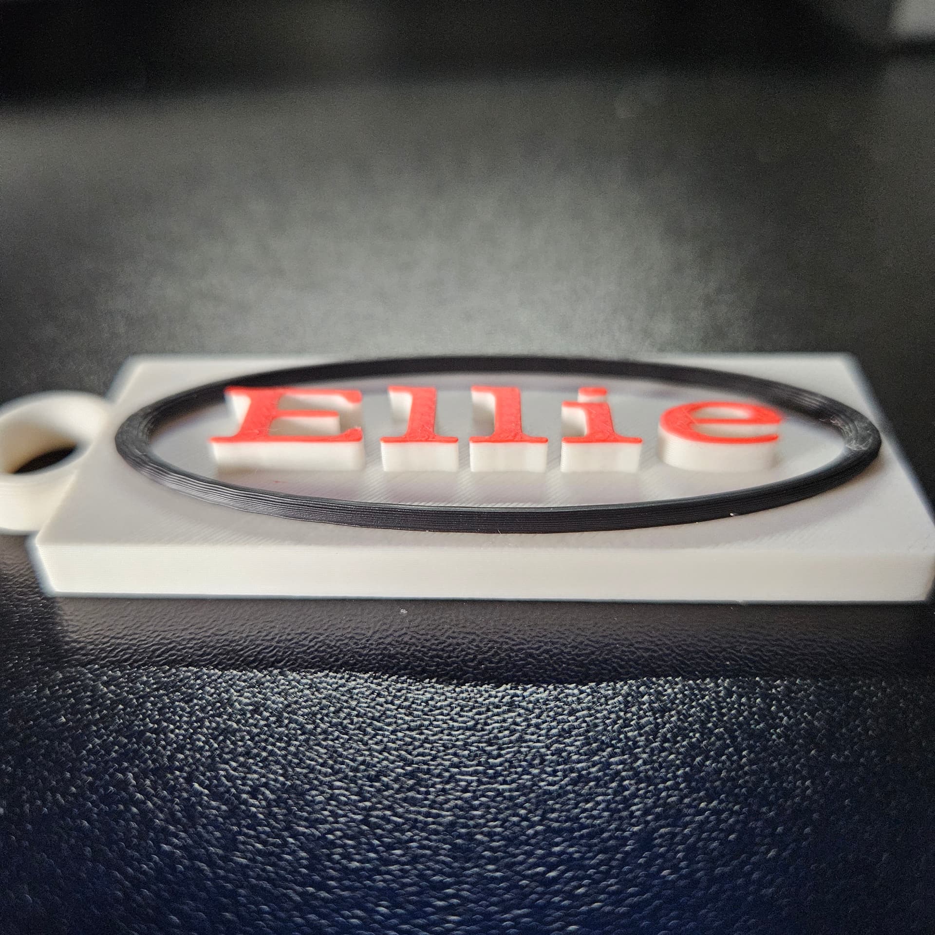

Finally figured the transfer out. Thanks to everyone for their help. Love this learning experience.
Hopefully these pics come through .
Thanks again!

Nice work!! well done.
