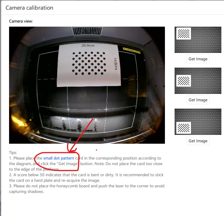

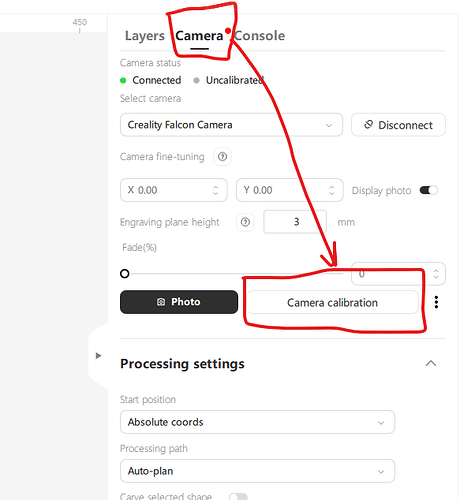

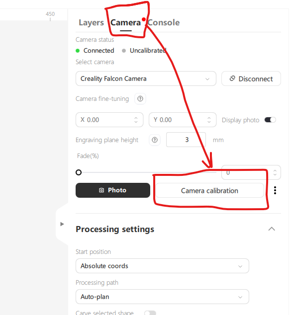

First, go to the camera tab and select “Camera Calibration”
In the camera calibration dialog, there is a blue link called “small dot pattern”. Click on that and give it a name. This will create a PDF file of the calibration card.
Note that when you print it out, you need to measure the size of the rectangular frame. The first time I printed it, my printer dialog scaled it down to fit on the page.
Hope this helps, good luck.
