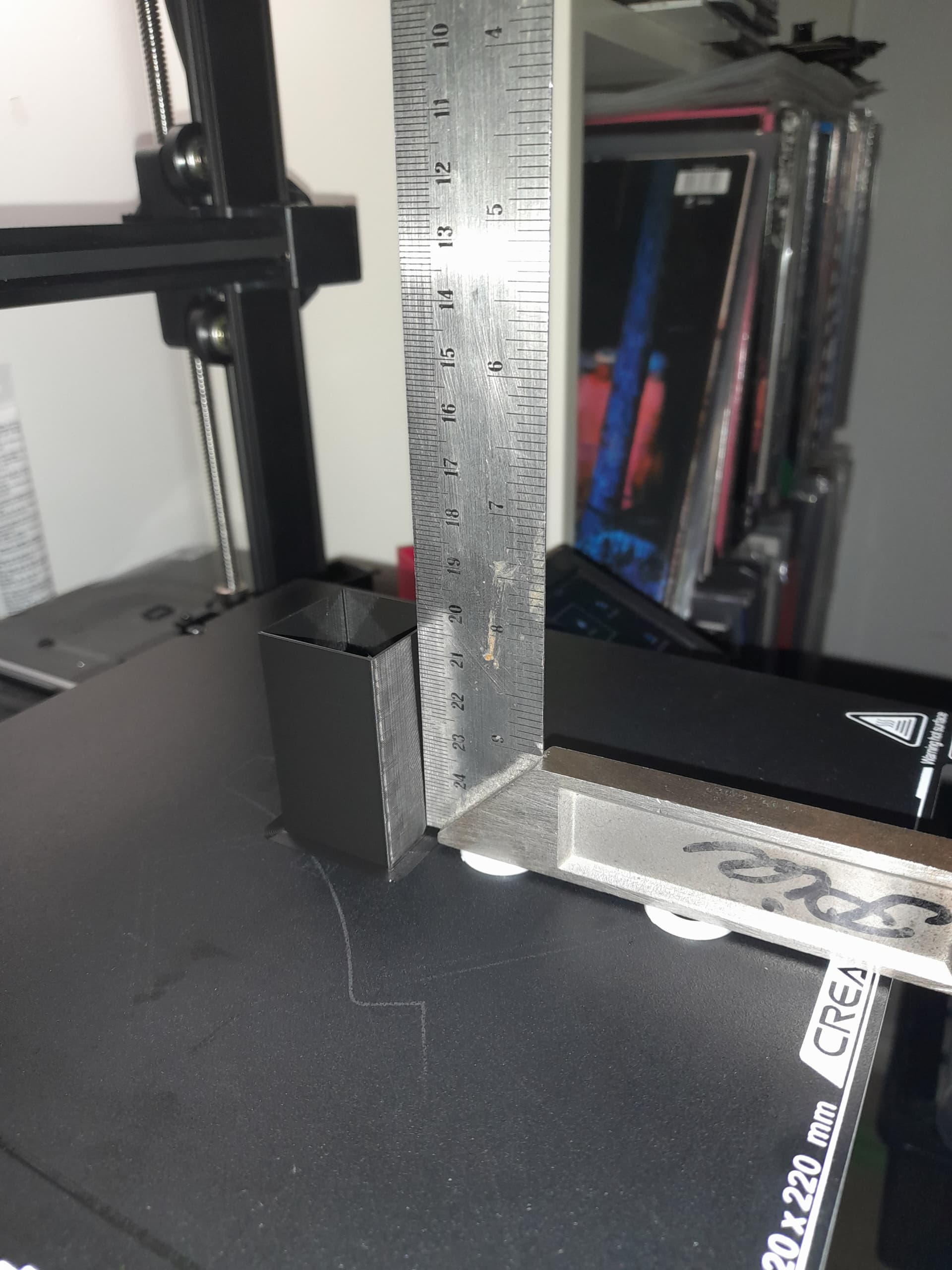

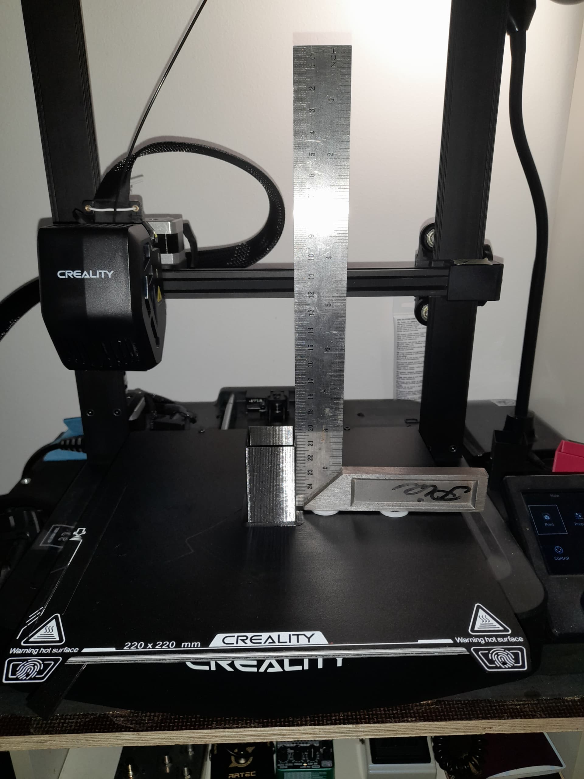

Hello, someone might know right away what causes this, but I have tried tighten and loosen Y-axis belt and nothing, reset factory settings and Pisa effect stays, what can I try to do to fix this? First I had vibrating problem so I dissambled whole printhead and tighten all screws, now can get very good print quality, no vibrations etc, but now is this skew problem. There is 2 photos, first taken front of printer and other from side.
Im trying to do modular parts and its impossible now, prints starts to lean backwards, please someone help me.

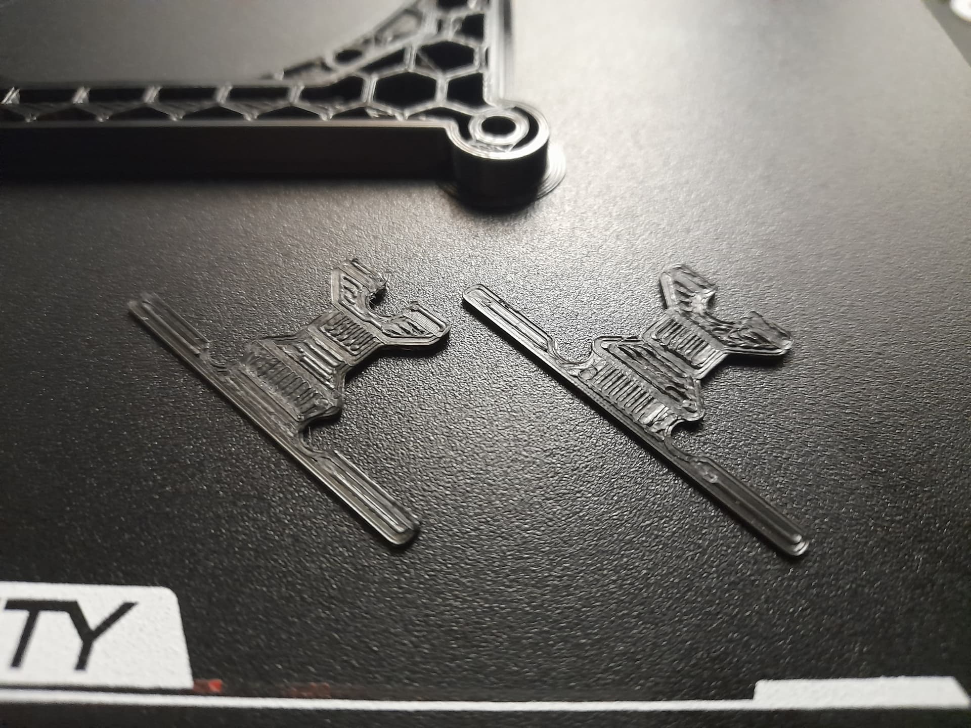

So I figured out, it was Z-axis guides leaning backwards so I printed (trial and error) small washer plates, those are 0.5mm skewed. Now its almost perfectly straight :slight_smile: So if somebody have same problem, you can try to fix it with those, I put .stl file there
