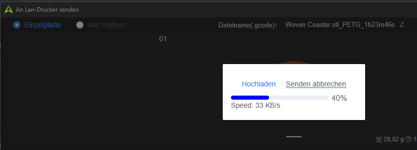

Hello. Anybody haveing the same issue. The transfer-speed from the slice to the printer is a joke. 32kb… I have a 300mb line.

I doubt that it would change. As its the same PC, the same network, concentrating on the transfer. And I fear its a problem with the cache or something at the printer and somewhere in the cloud. Sometime when I turn the printer off for a few seconds (or longer) and turn it back on, the speed is much higher. Over time it slows down. And out of the suden speed is back up

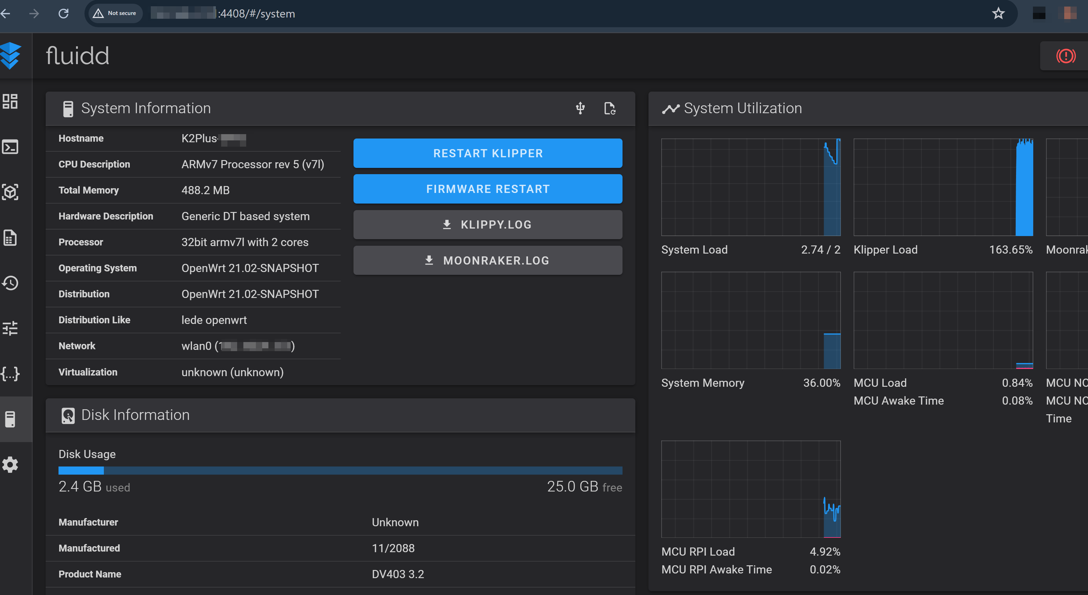

For me, after testing with a CAT5 connection and verifying that the MCU is not saturated, the next step would be to look at the Fluidd console and monitor CPU utilization.
Try an upload while the browser is open and watch for any significant increase in CPU utilization or other performance hits.

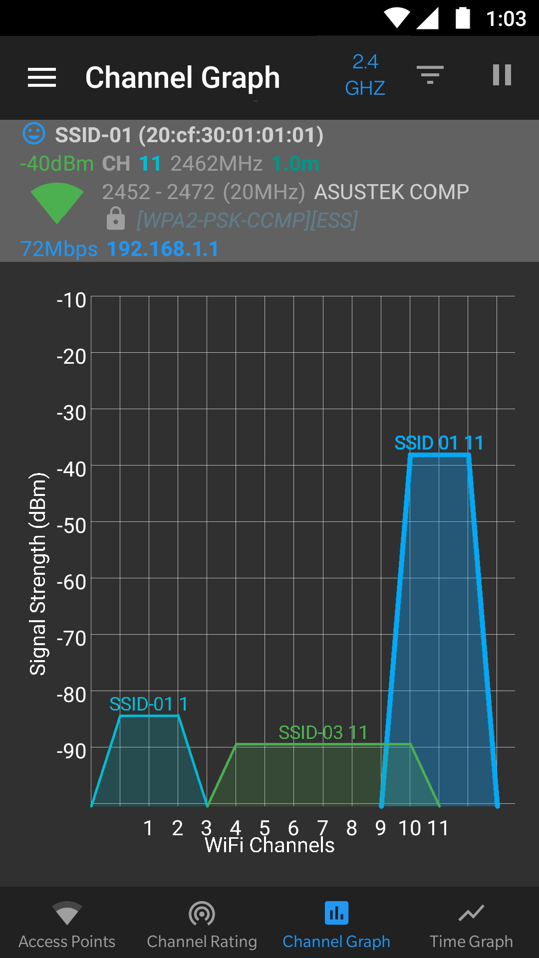

Last, if you have an Android device, run a WiFi scanner and look at the channel your LAN is using and the amount of congestion around it. If necessary, change the access point to a less congested channel.
I would consider that a later-stage diagnostic, however. The first priority is to rule out MCU saturation and WiFi itself. The CAT5 test does exactly that: it removes the wireless connection from the equation and rules out one of the most obvious variables.
There are many open-source WiFi scanners on the play store. Here is one I’ve used but there are others. I prefer their mapping of overlapping channels. If you have congestion, this will show it. I know of no such resource for the iPhone but perhaps someone here on the forum can suggest one.
