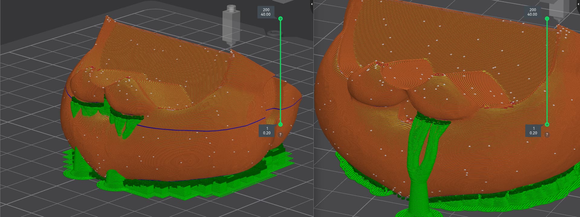

I’m trying to put tree and normal supports on the same object. I cut it and put one object above the other, using add part to keep distance from the bed. However, when I slice the plate, the tree supports are going through the bottom object. If I slice the object without all this prep, the tree supports are created perfectly, around the object. So, when Creality Print 6.3 adds the tree support, it’s only considering the target object, but it should consider all object on the plate.
On the left image, it’s the prep plate with the supports going through the bottom object. On the right image it’s the same object but without the prep, with the tree supports going around the whole object.
@dalmirnogueira I have had this happen as well.
