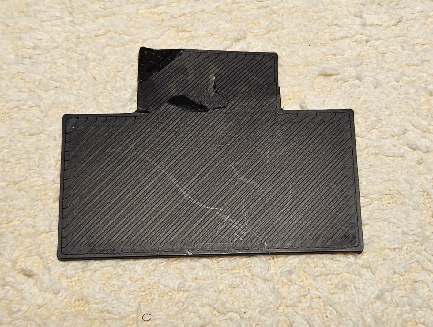

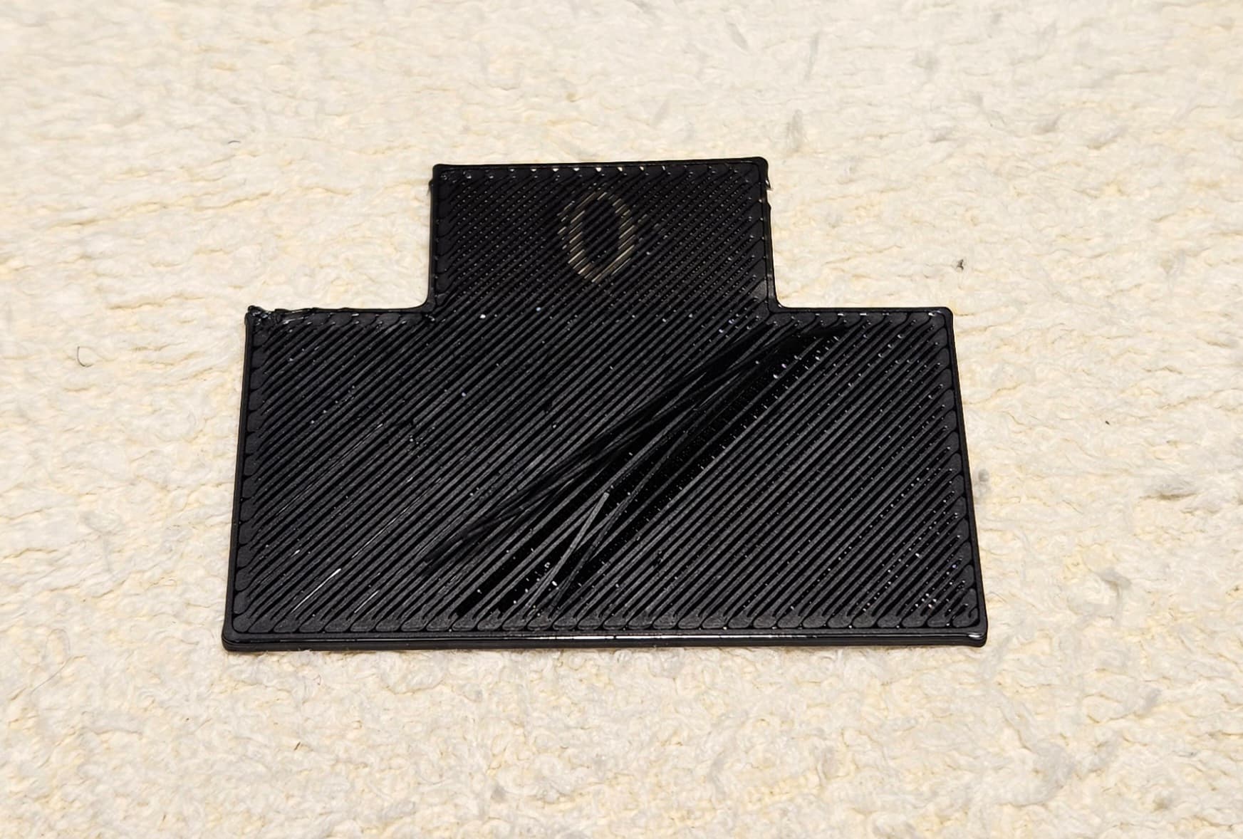

However, after performing the second pass for fine tuning, all the samples printed have little to no adhesion between the first 2 layers, the first layer on all of them also does not appear to have extruded as much on the bed and has some gaps between the lines, I will post some photos here, but I dont know how well they will show.
They adhered to the bed OK, with parts of the first layer being left behind, but unsure why the second pass is like this when the first test print was fine.
On v5, i went with -7 on this second pass, but in v7, none of them are acceptable.

Here is -15 on the first pass

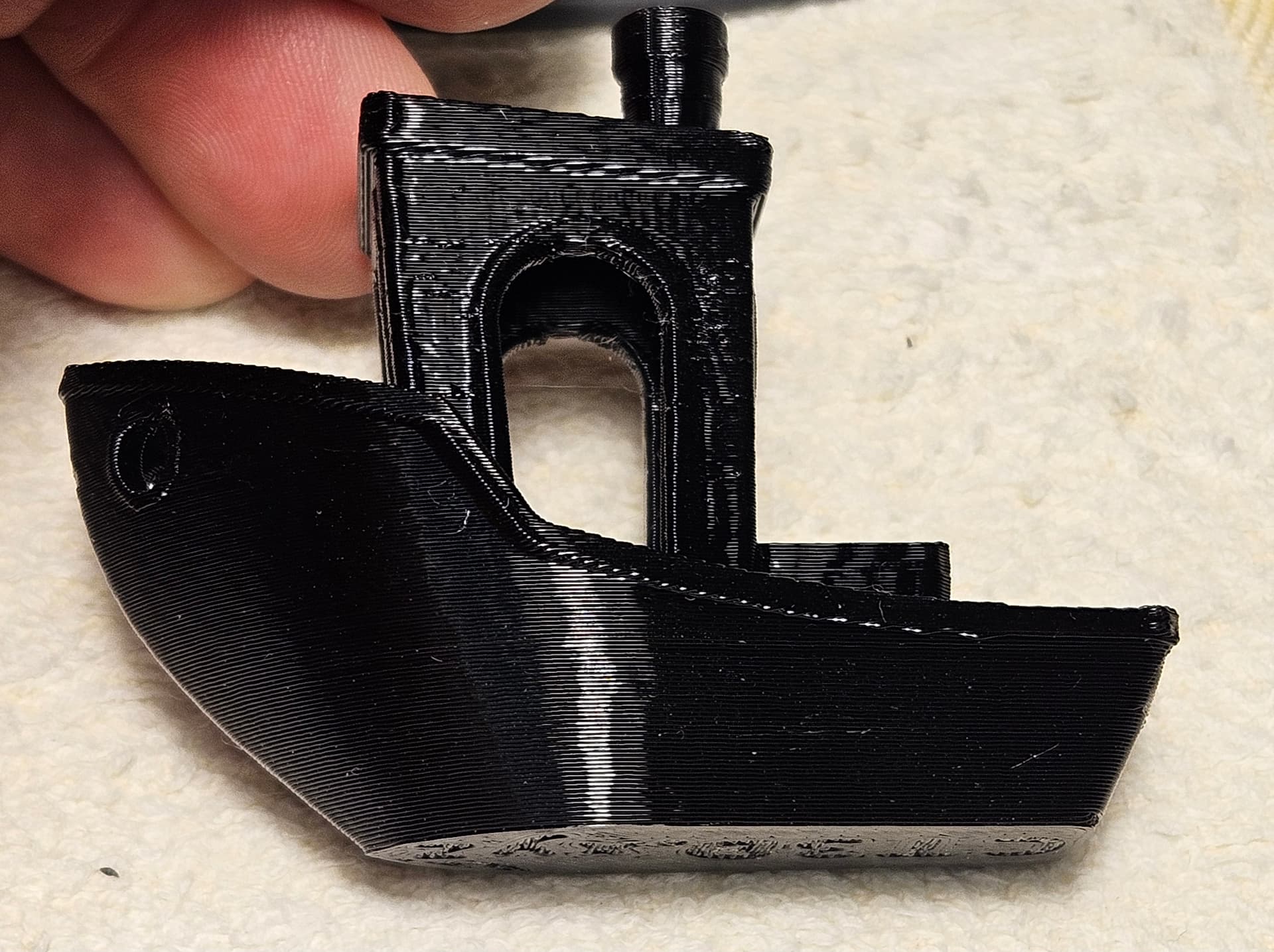

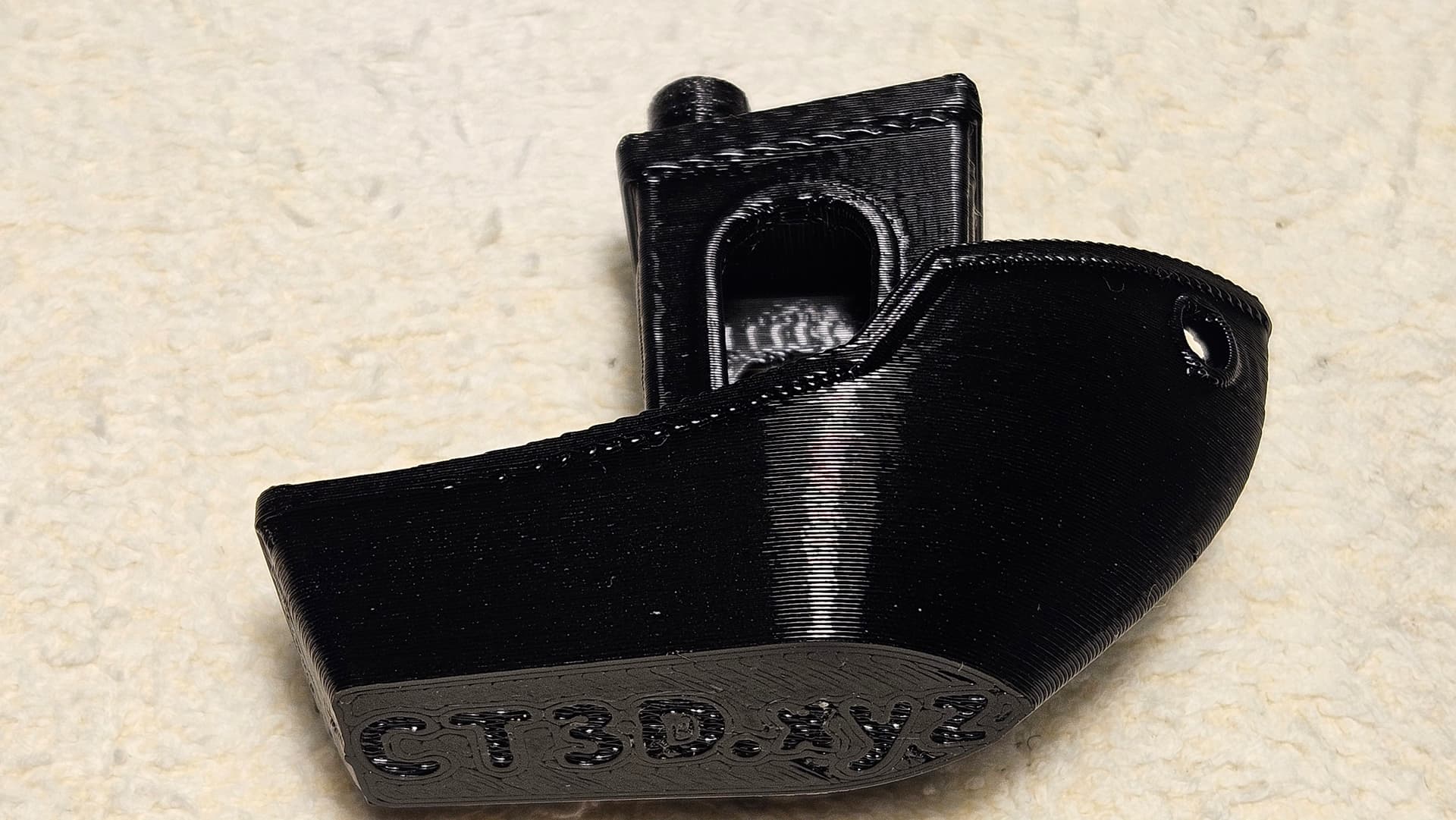

Benchy printed in v7 with hyper petg profile, looks possibly over extruded around the cabin. Bed extrusion appears a bit less too, has some gaps and not quite as smooth in appearance. Overall its still pretty good for petg with no tuning performed.

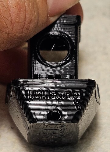

Same benchy printed in v7 but showing some of the ghosting at the back

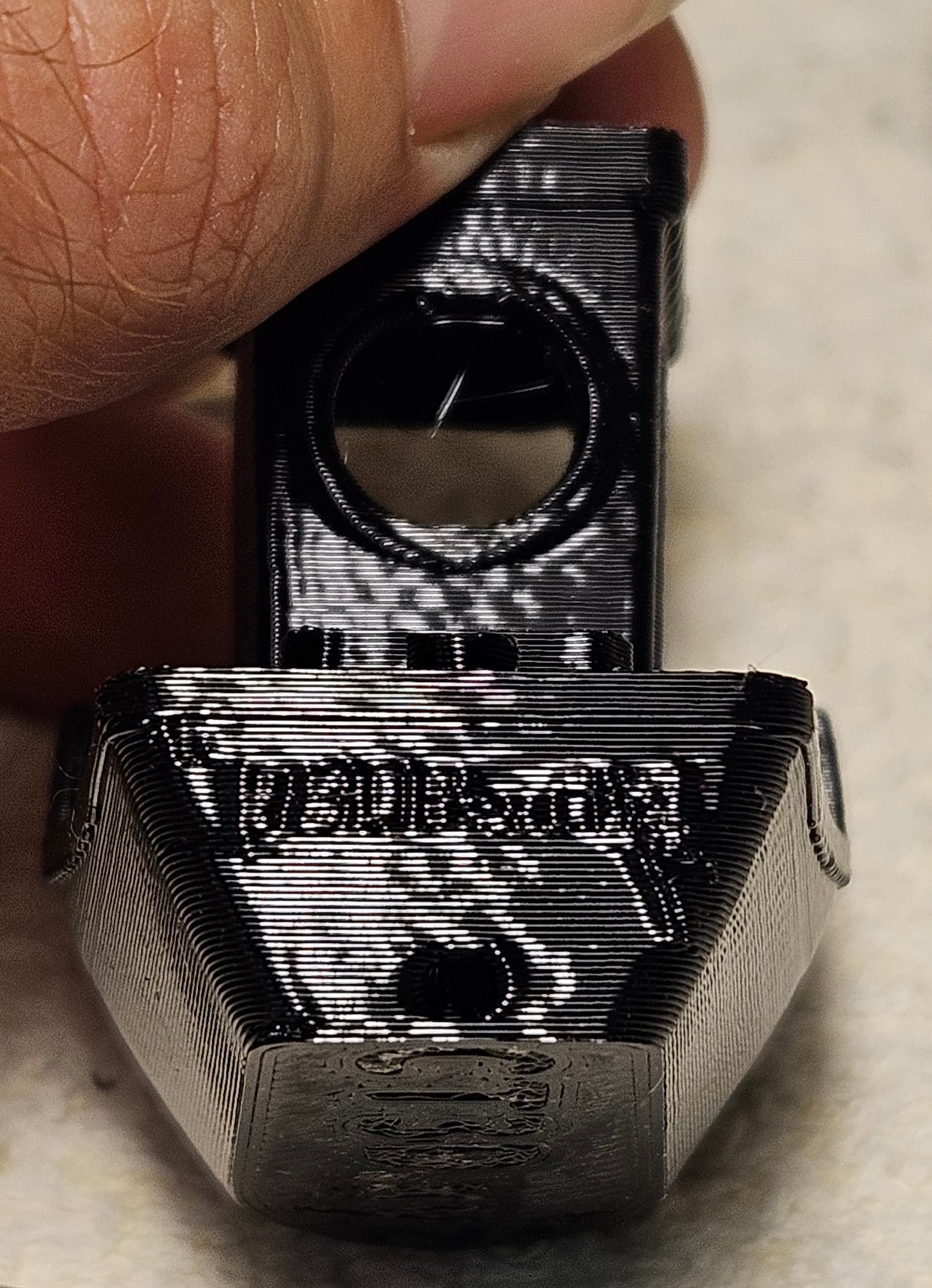

First benchy printed in default profile in v5, largely ok, but slightly over extruded on the outer top edge
Sample of layer separation on second pass, all were like this.

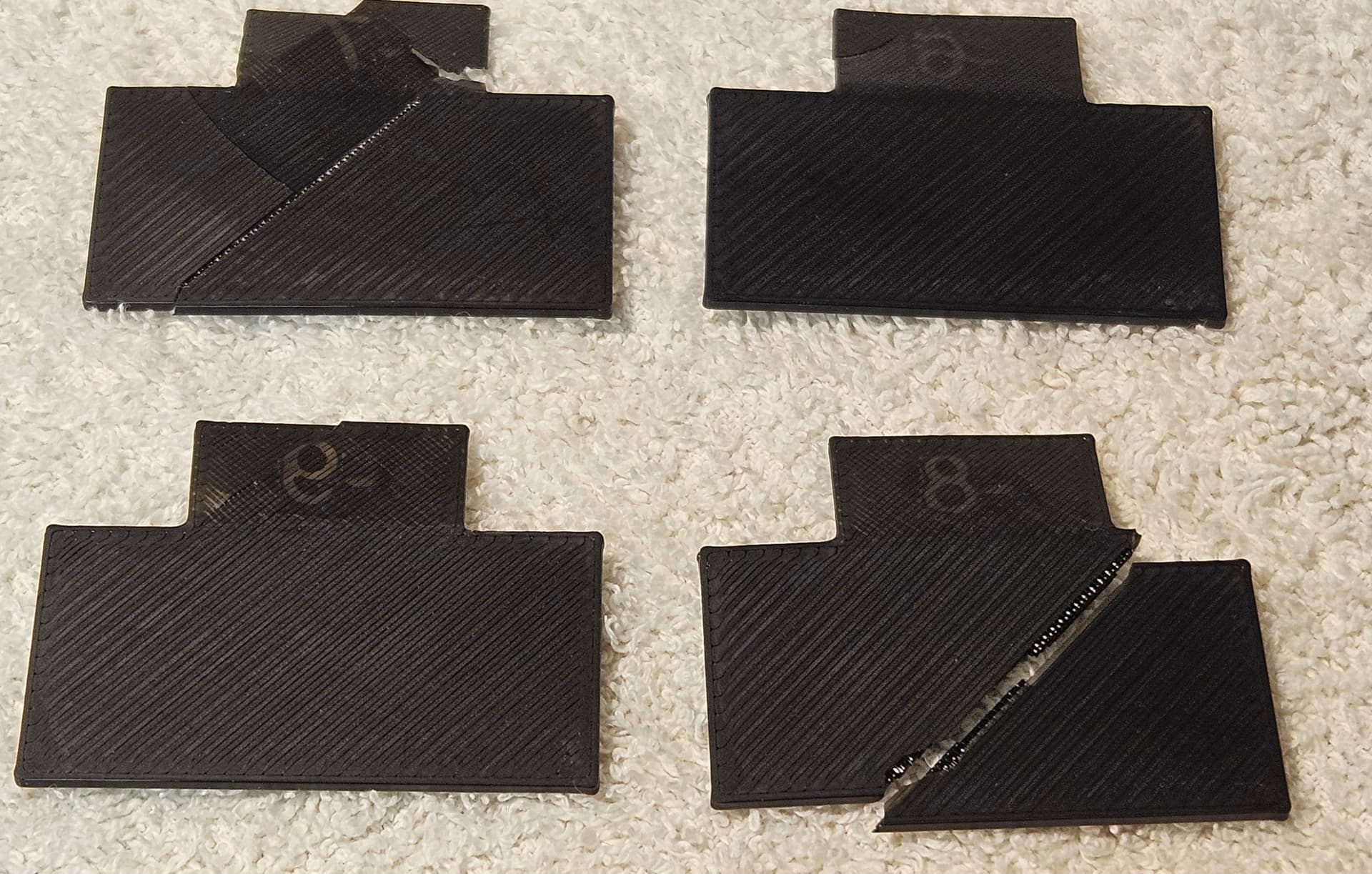

Have performed this calibration with the CR PETG profile and they print normally.
The broke trying to remove but are solid.
These ones are -6 to -9
