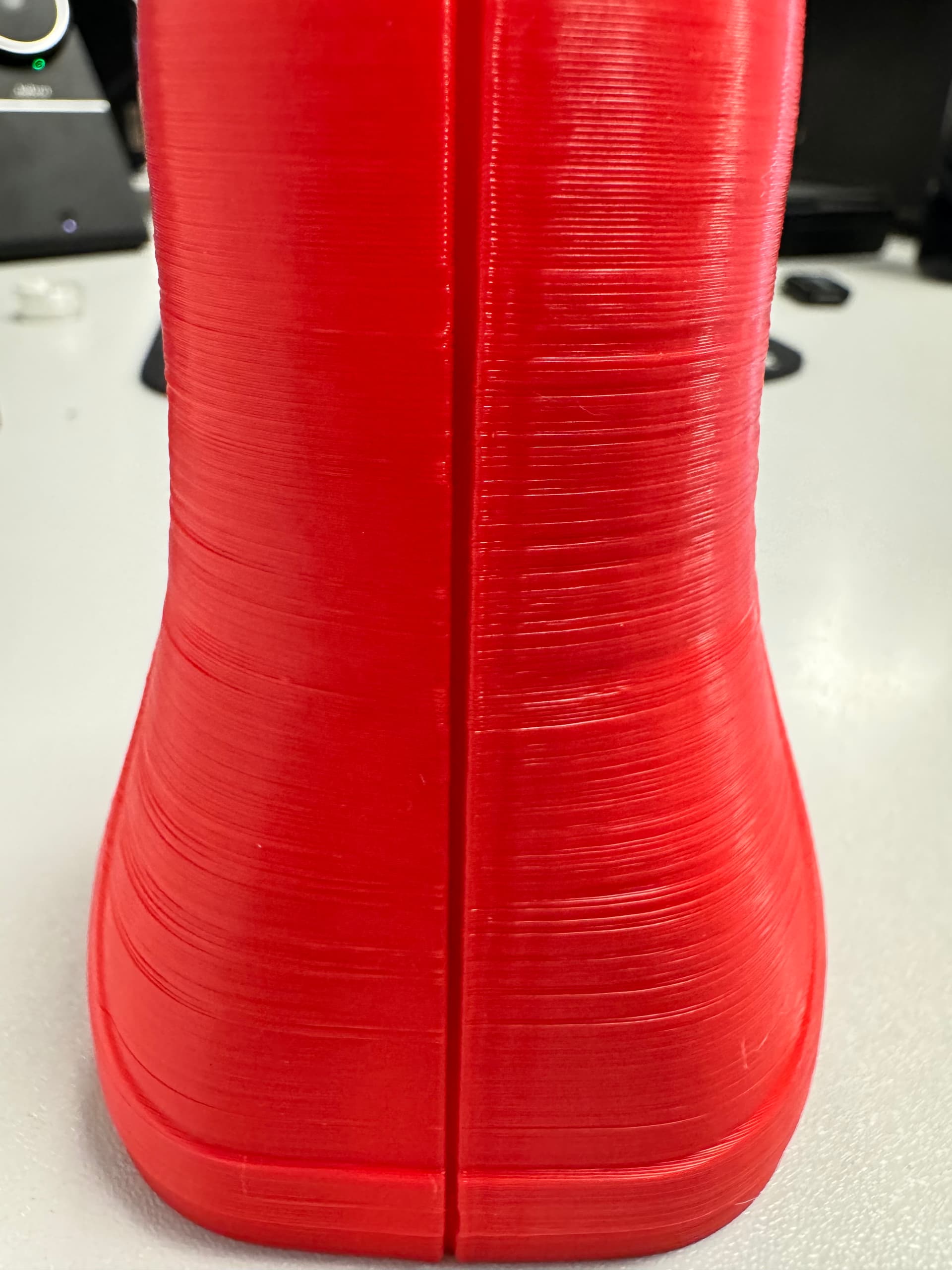

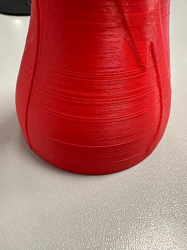

Hello all,
I’ve got an K1 Speedy for 1 month or so, and since then I’m strugling with this kind of layers shifting and rounded corners, I’m printing with the basic settings from Creality Slicer 5.0.3. I chose 0.16mm layer height profile and basic setting from the HyperPLA.
Any tips to improve this?
Thanks!
What filement are you using? Could be a variation in the thickness of the filament, changing the amount of plastic being laid down or maybe you need to run the input shaping again.
I use HyperPLA from Creality. I will try to run the test again, but this is happening since the beginning with all kind of prints, from the 20x20mm cube up to this more complicated shape.
