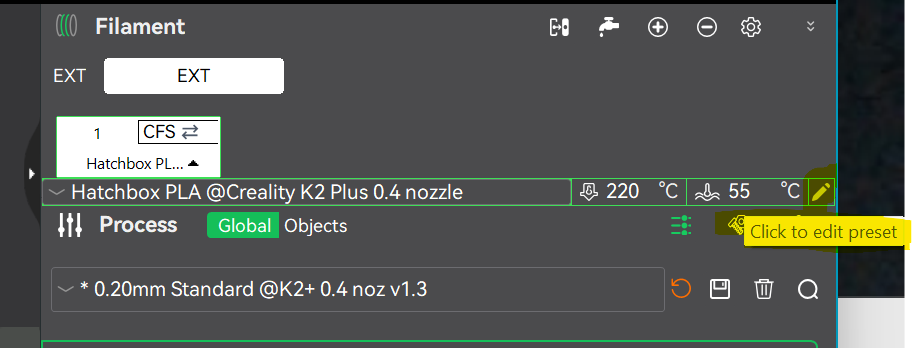

Is this in creality Print 6.2? If so, in the preview page under Filament, select your current filament and click on the pencil at the right.
The Edit filament pop-up that opens will work for all Filaments and has a “Save As” option. Select a filament similar to the one you are adding. Maker the needed changes and save as the new filament.
