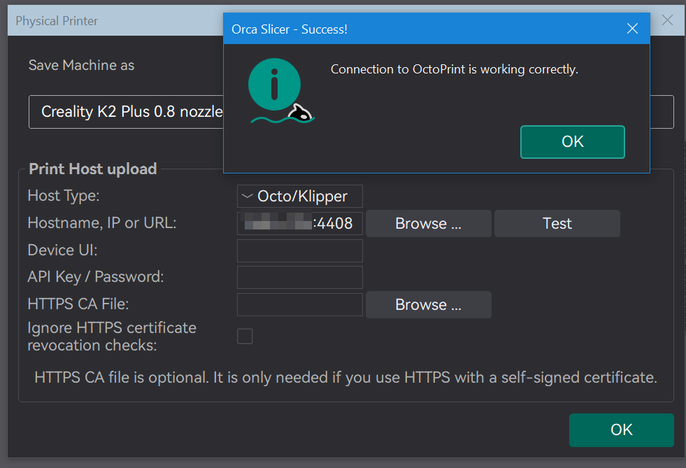

That’s not the proper configuration for Orca slicer. You are trying to connect to the browser port 80.
This is the correct format for the Host URL. Note port 4408.
http://<Printer_IP>:4408
