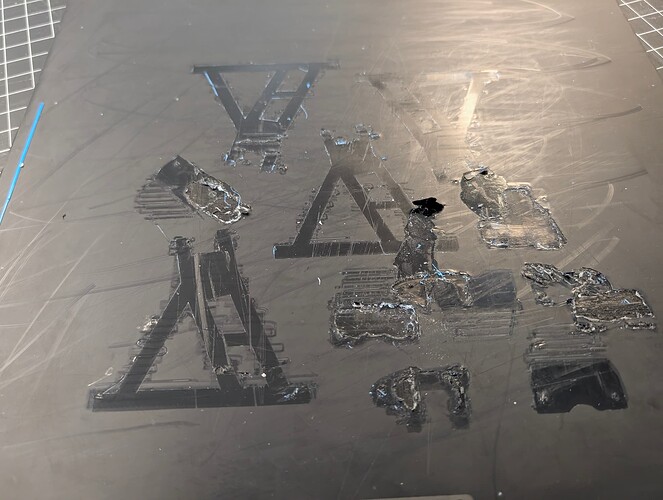

Hi, I bought the upgraded print head for the K1Max, I made a couple successful prints and then I had a failure of the new head. It seems as thought the screws that hold the nozzle on to the heat block are too short and only hold on by a few threads. This caused the filament to push the print head out and destroy the print bed. Has anyone ever heard of this before?
If you have purchased the upgraded head for the K1Max I would check that these bolts are not too short on yours to prevent this from happening to you.
