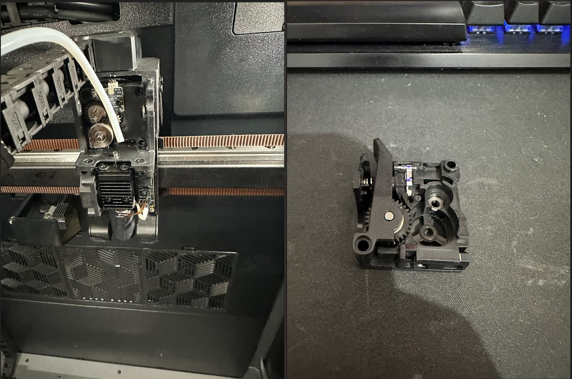

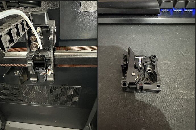

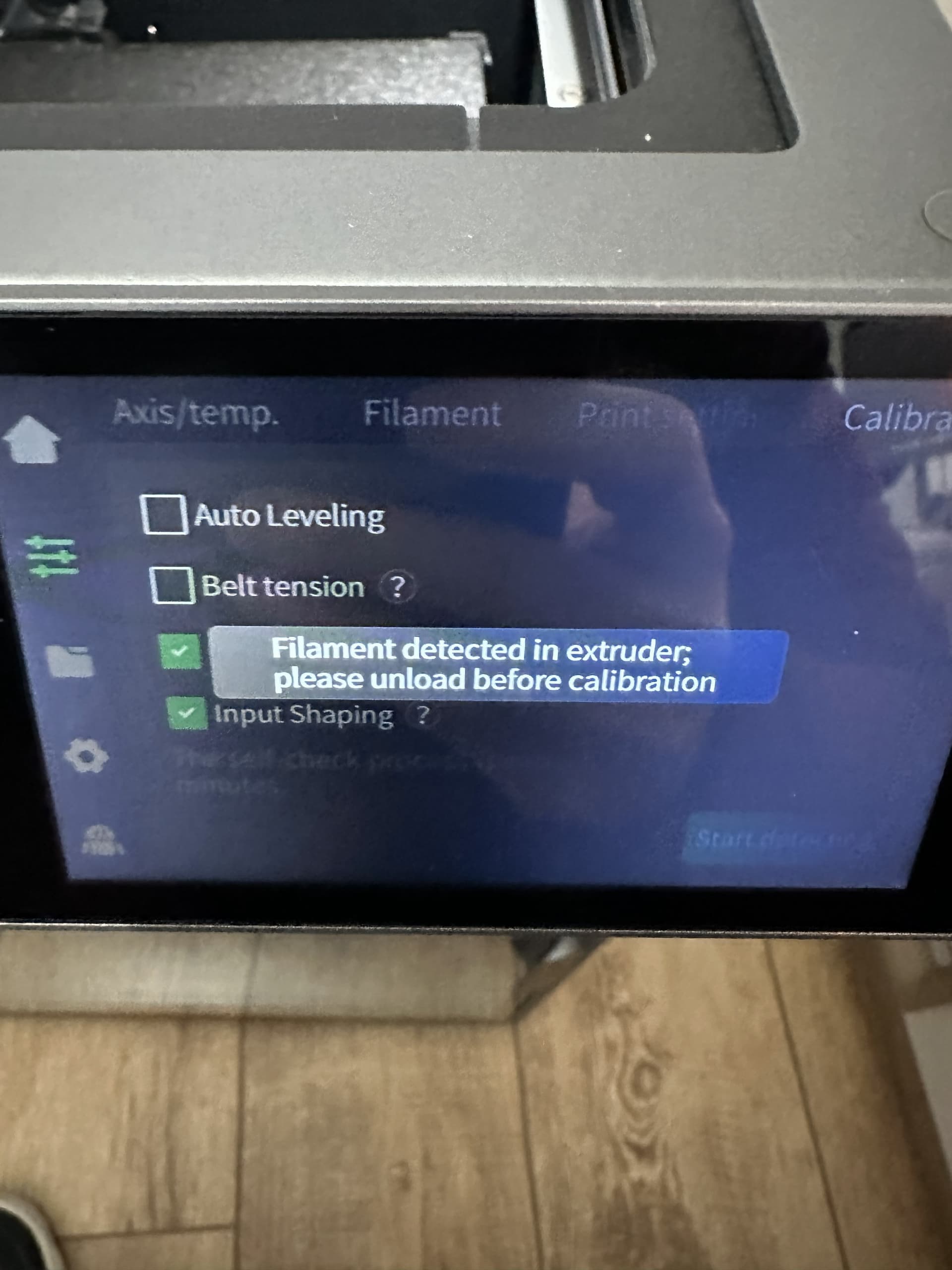

For a few days now, I’ve been having a problem with the K2 Plus, which I purchased on Amazon on December 3rd and received on December 10th. For a few days now, when I try to calibrate the cutter, I get the message “Filament detected in extruder; unload before calibration,” which I’ve attached in the image. I can’t print at all with the CFS. I get errors on the display, but from what I understand, it’s not due to the CFS but rather to a problem with the printer.
Without the CFS connected, I can print, but the printer won’t let me adjust the belt tension, calibrate the cutter, or restore factory settings because it always displays the same message: “Filament detected in extruder; unload before calibration,” which is very strange; it shouldn’t display this message.
I purchased a new extruder for the K2 Plus and a new hotend for the K2 Plus on Amazon and replaced both of them following the instructions on the wiki, but the problem persists.
The extruder has no filament inside (the blue light indicating the presence of filament in the extruder is off, but if I insert PLA filament, it turns on correctly).
I’ve tried removing the filament several times, both before and after replacing the entire extruder, but the problem persists.
I’ve tried removing and replacing the cutter, following the instructions on the wiki, but the problem persists. The printer has firmware 1.1.4.8, is new, and has 140 hours of printing.
I need to fix this; the printer is unusable due to this issue. Could you help me or give me some advice on how to fix it?
I’m posting some photos of the error message, of the open extruder with no filament inside, and of the new extruder I just purchased and replaced.

Unfortunately, when I try to calibrate the cutter again, I still get the message: “Filament detected in extruder; please unload before calibration.”

Your problem seems a little different than mine. The toolhead board is fairly inexpensive so you could try replacing it. I think the initial spare parts kit comes with a spare filament detection module as well. When replacing the extruder you might have pinched some of the cabling so could inspect those. I also had a bunch of bizarre, different errors recently until I unplugged and replugged the main hotend cable.
If you haven’t reached out to Creality support yet you might want to get it started… the back and forth can be slow but they usually can recommend next steps and send free parts under warranty.

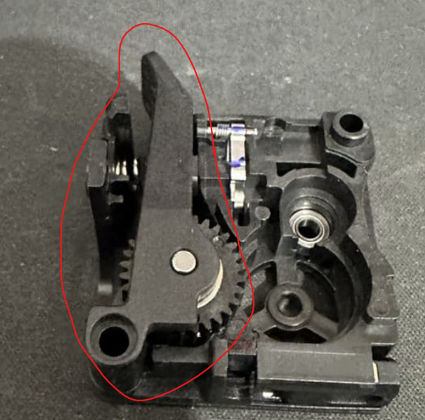

Hi,
I had the same issue and i found some material behind the lever circled in red. Watch out for the spring when you take it out!
