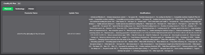

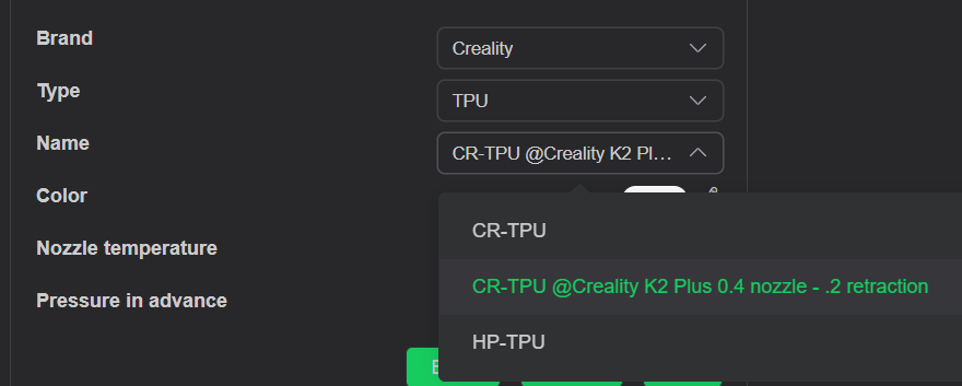

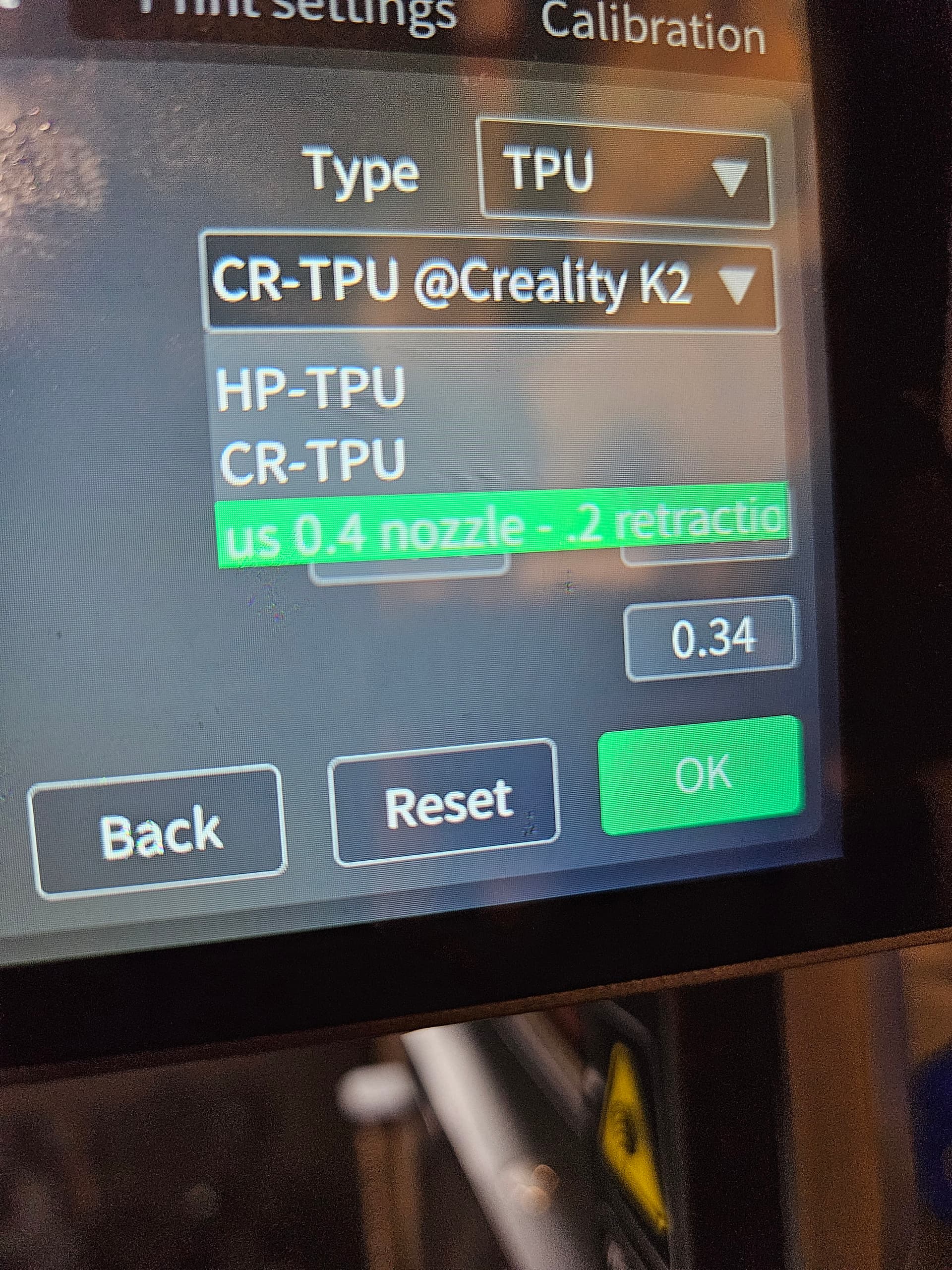

I have my user profiles available from both CR software as well as on the printer…
Slicer :
Printer:
so it does work, but maybe its version dependent or some sort of sync issues between your printer account & your CR account..

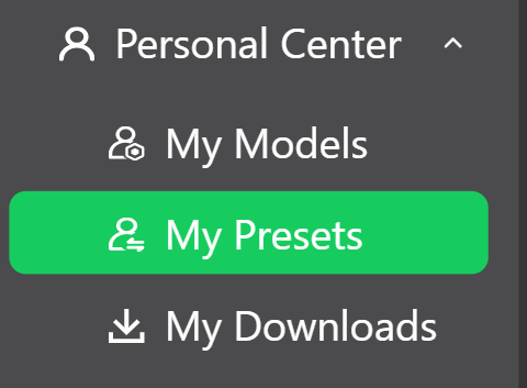

if you look in CR in your “My Presets” does it show all your profiles ?
if this page is empty, then thats your issue.. it all goes from your computer → creality Cloud → printer.. until they are all syncing, you don’t get your user profiles on the machine to use to re-print locally stored prints
Oh that’s good to know thanks for the info!
I do have the custom filament show up under My Presets.
But it doesn’t show up on the printer side. I’m missing a sync somewhere and have no idea how to start it

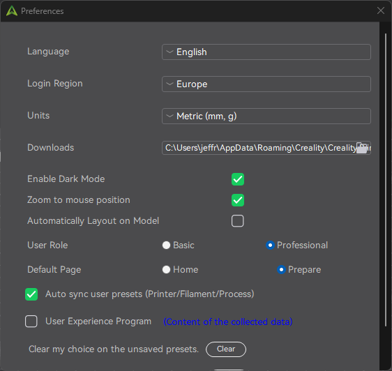

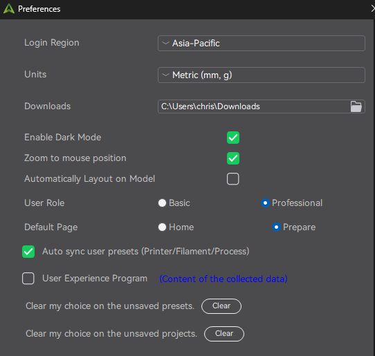

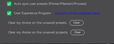

Do you have this setting Under the gear/preferences settings Icon set ?
The Auto sync setting? Yeah.

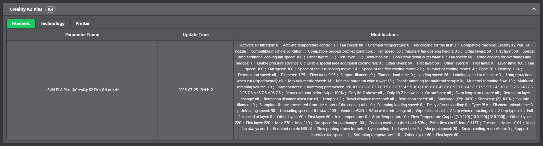

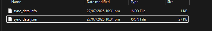

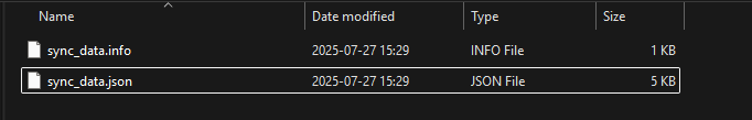

Maybe a quick question, are your custom filaments saved at
C:\Users\[usname]\AppData\Roaming\Creality\Creality Print\6.0\user\[userId]\filament\base
or
This location
edit, ah that latter just seems to be the recent history of the app..
I logged out of CR 6 and logged back in, doing that I was prompted with
I also have this folder, but the files inside are a lot smaller than yours
And yeah I did say yes on the prompt too :pensive_face:

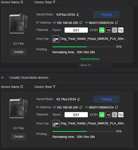

have you tried manually removing both local & Cloud bound devices from CR & manually (or scan) readding them back in ?
ah ha.. may have it.. try running these 2 clears. In combination of removing and re-adding the printer back into CR.. I was just having a printer → CR CFS C4 sync issue.. it kept wrongly linking hyper PLA instead of my custom profile..
ran these 2 as well as removed and re-added printer and it fixed the sync issue.
I’ve done all of this. I even uninstalled and reinstalled Creality Print completely. Didn’t help. I have Go Filament Sync running now and that’ll have to do until the problem magically fixes itself with an update.
