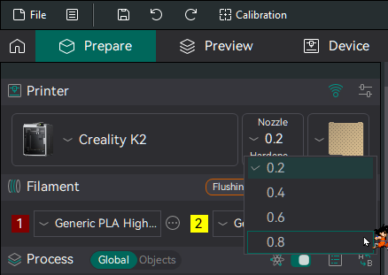

I have the K2 Combo and would like to use a .2mm nozzle except there is no preset for the K2. There is for the K2 plus.
Is there a way to add a .2 mm nozzle preset to the K2?

you should create and copy the profile manually. I had the same problem on my Creality Hi for .6 and .8 nozzle. where upgrades 6 months after.
Also you can use Orca Slicer, the most recent version have profiles for 0.2, 0.4, 0.6 & 0.8 nozzles, you can use them as template or directly use Orca.
Thank you so very much!
