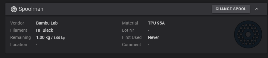

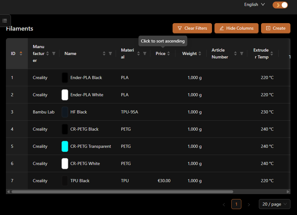

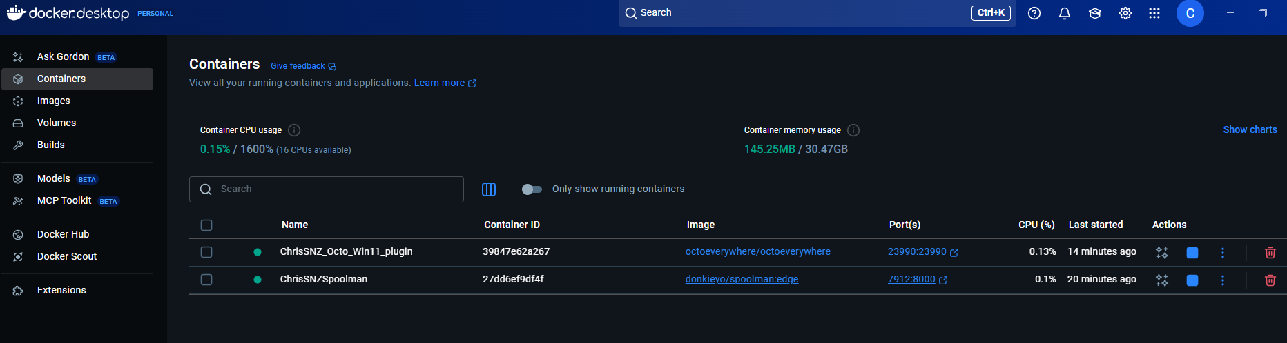

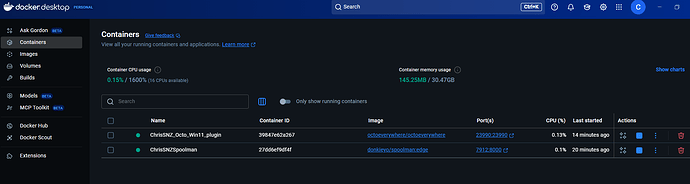

    setup spoolman this morning, using windows docker / seems to work Ok..
used windows docker to pull/run then added the moonraker config
save_config & reboot and it seems to work
clicking on manage spools loads the spoolman page to add /edit also
whole process took about 30 minutes (to setup Octo & spoolman both), probably a lot easier as I have static IP’s assigned to printer & laptop already..

I use octo for remote management, console- fluidd access when out and about, and the AI detection is a lot better than the built in one.
