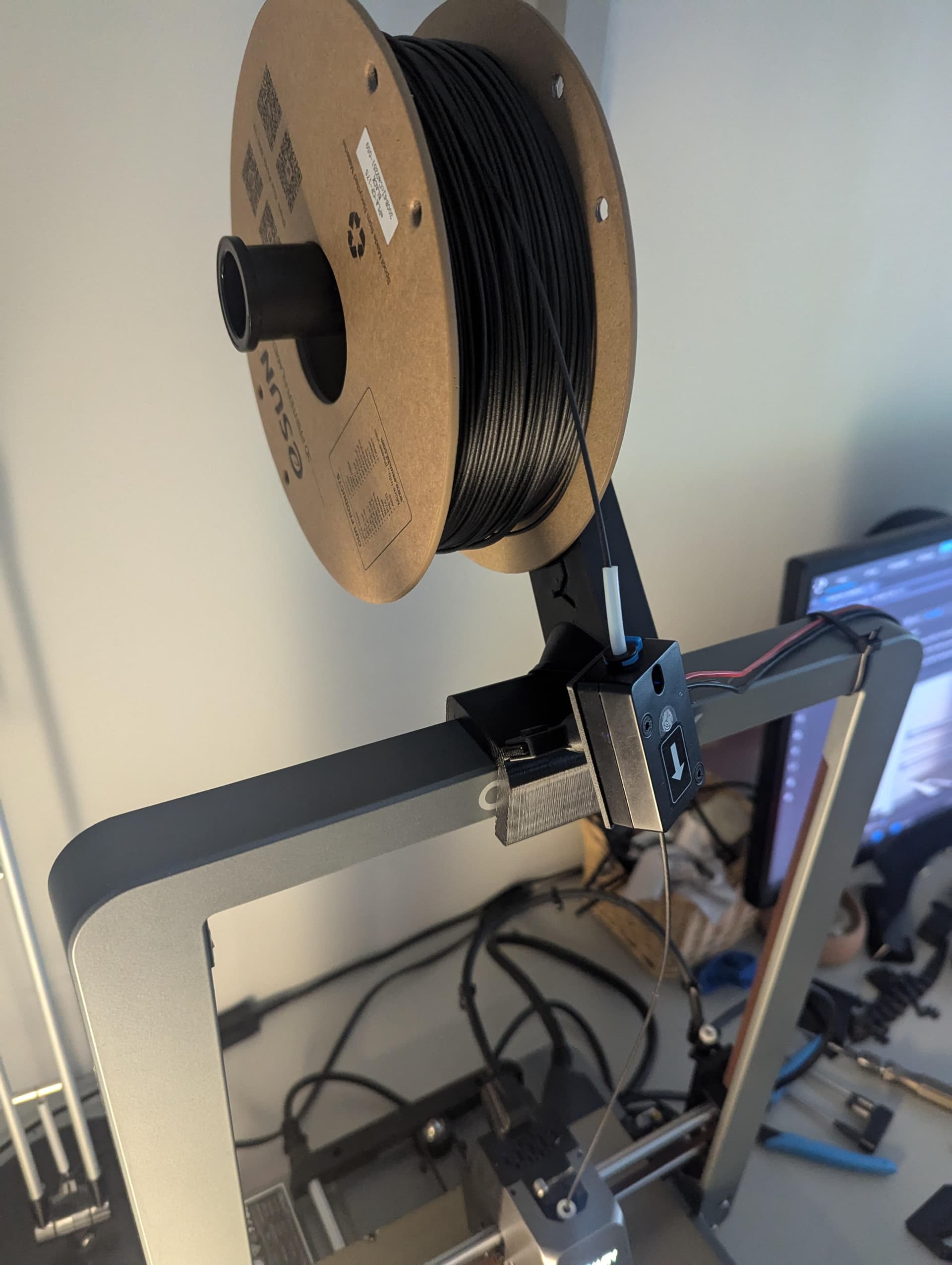

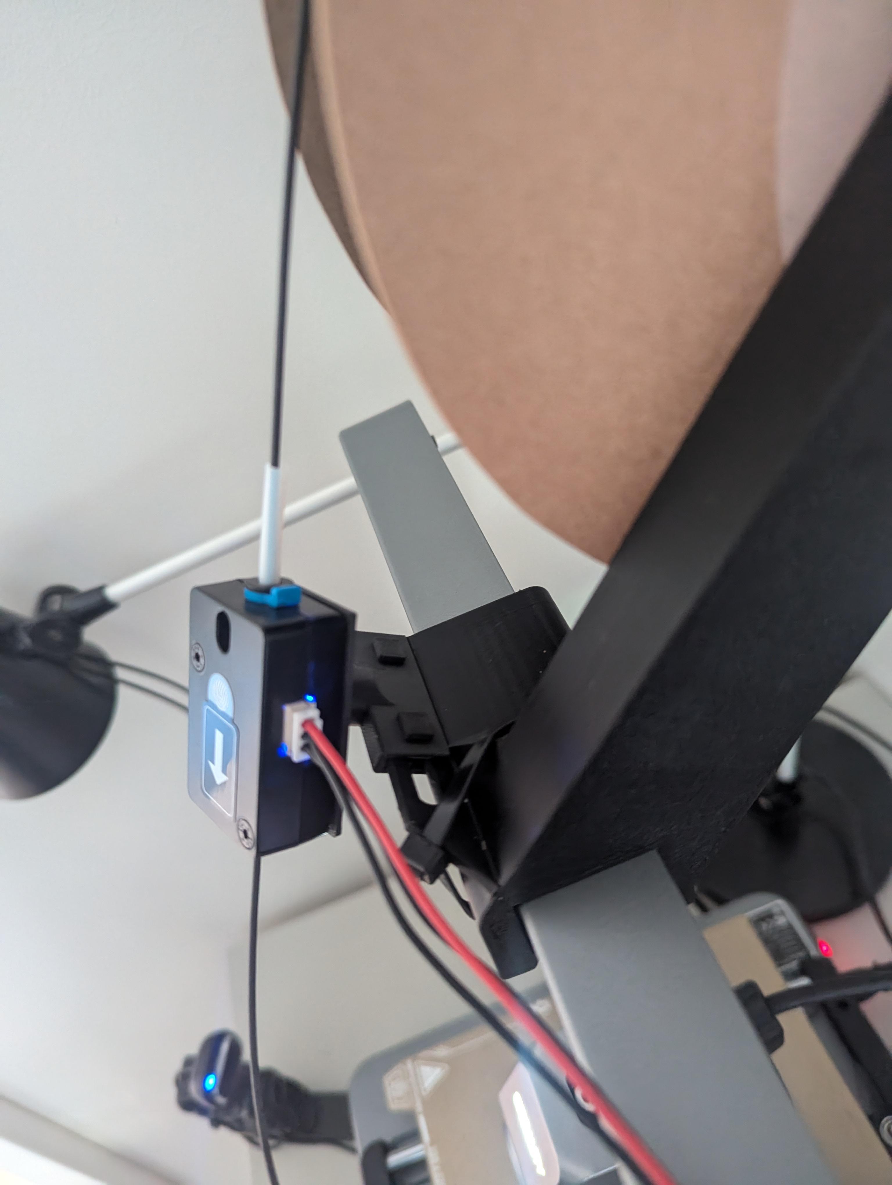

I have also been using the included (included usb stick) top spool holder without the runout sensor. However, I made a quick holder (ball mount) for attaching to the existing top spool holder. It works for me and posting it here if anyone want to test/use it.
You will need an extension cord for the runout sensor (I used a 300mm 2S battery extension cable with JST-XH connectors). You will also need 2 M3 nuts for attaching the sensor on the mount.
It has a holder that you press-fit two “nails” (plugs) into and that way it can slide in the existing filament guide. The ball-joint will make it freely spin around when the extruder moves around.
Found here: https://www.thingiverse.com/thing:6706312
(Does not include the spool holder as it is not my design and it is already included on usb stick that came with the printer)
If you still have not moved the sensor maybe you would like to test this? Works nice for me at least.

Sorry Jimmy, you must not have an E3V3 (coreXZ) and don’t understand the problem. Creality E3V3 naming structure has created a lot of confusion. This printer has a runout sensor on the X crossbar and homes in the upper left corner which pulls out extra filament as the sensor rides up. When it comes down to the print bed all that extra filament is left to tangle or catch on electronics. The fix is to fix mount the filament sensor to the side rail. there are a couple mounting clip model options out there including one I posted.
