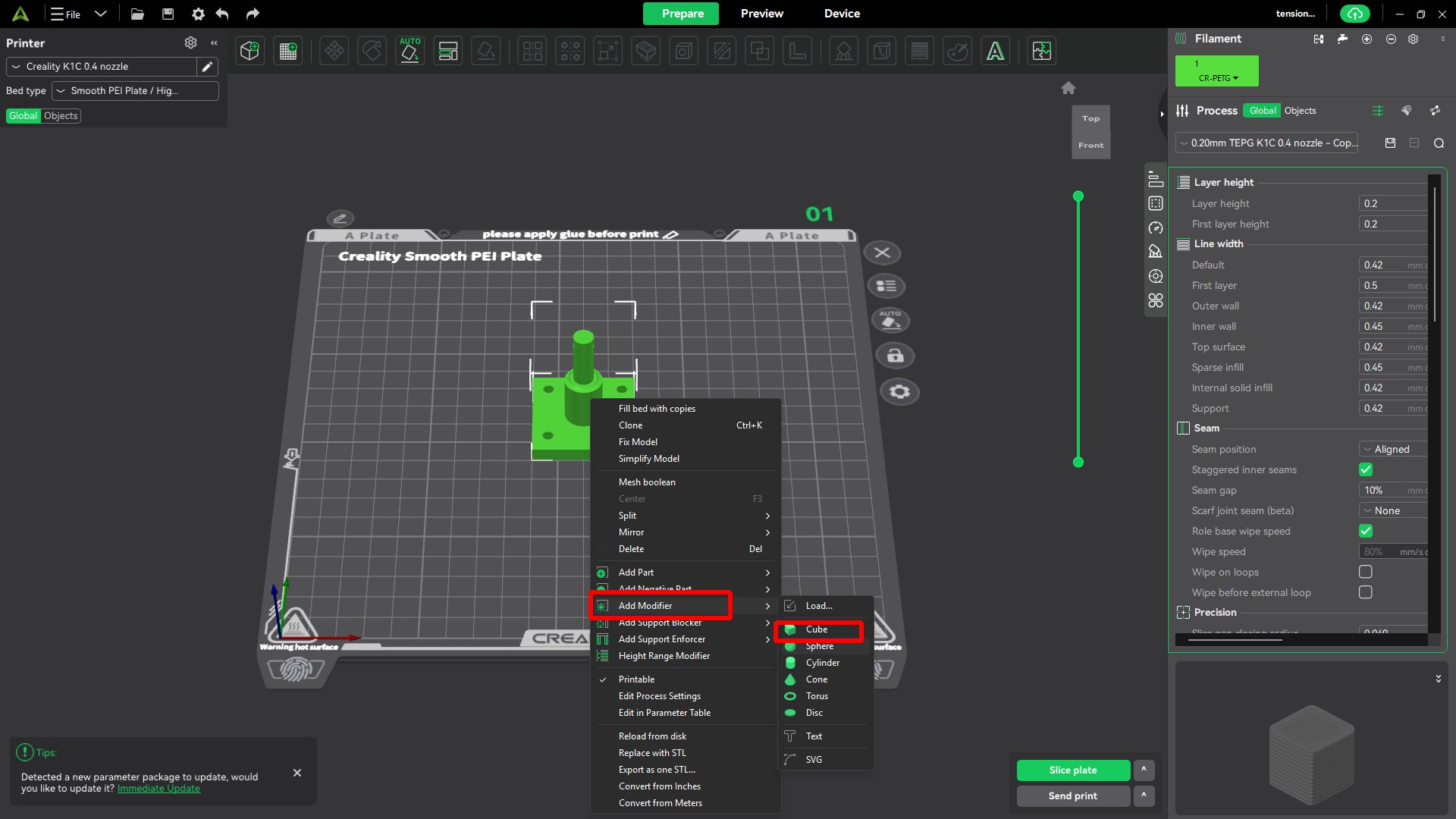

Right click the object and select modifier , then select the shape required.

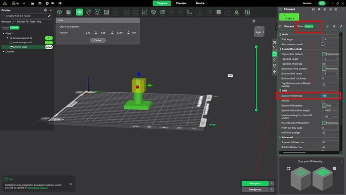

Position the selected shape over the section of the model you need to modify, You can resize the selected block to suit. Select the required infill then re slice.
You can use the modifier to change other parameters such as temperature, line count etc.
