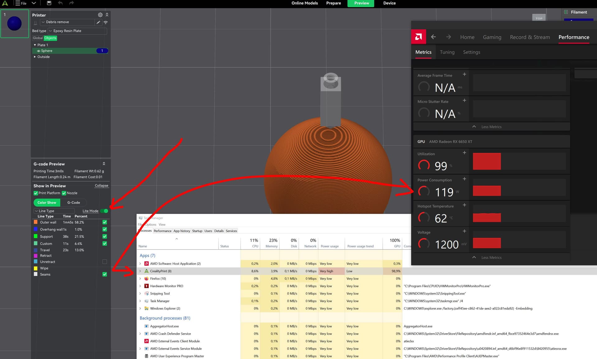

My low end Radeon RX 6650XT is hitting 100% each time i run the preview. And if i add too many objects the CP7 crashes each time when i try ‘mesh boolean’.

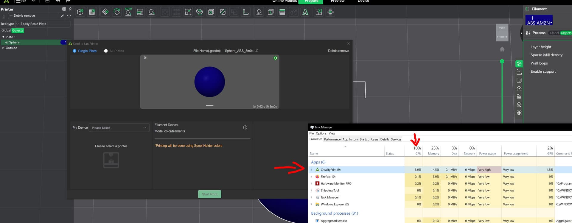

Then when i want to print - and that window pops up before printing, it uses some 15% of the CPU, i7 13700k, and 15% is a lot. The thing is, the preview window uses 100% of the GPU for infinite time, and that popup window uses 15% of the CPU for infinite time.
So it is definitely a bug within the CP7, as i compared the usage with ‘Cura’ and it didn’t even use 1/5 of what CP7 does….but Cura is not what i want to use.

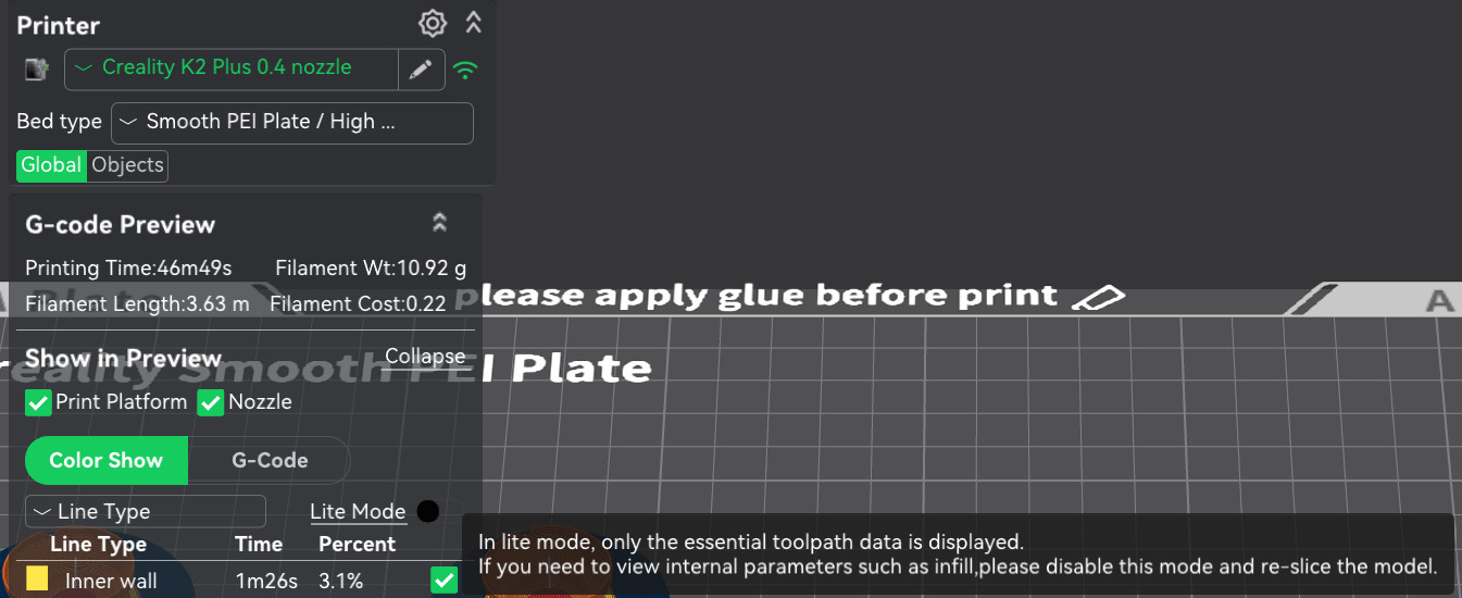

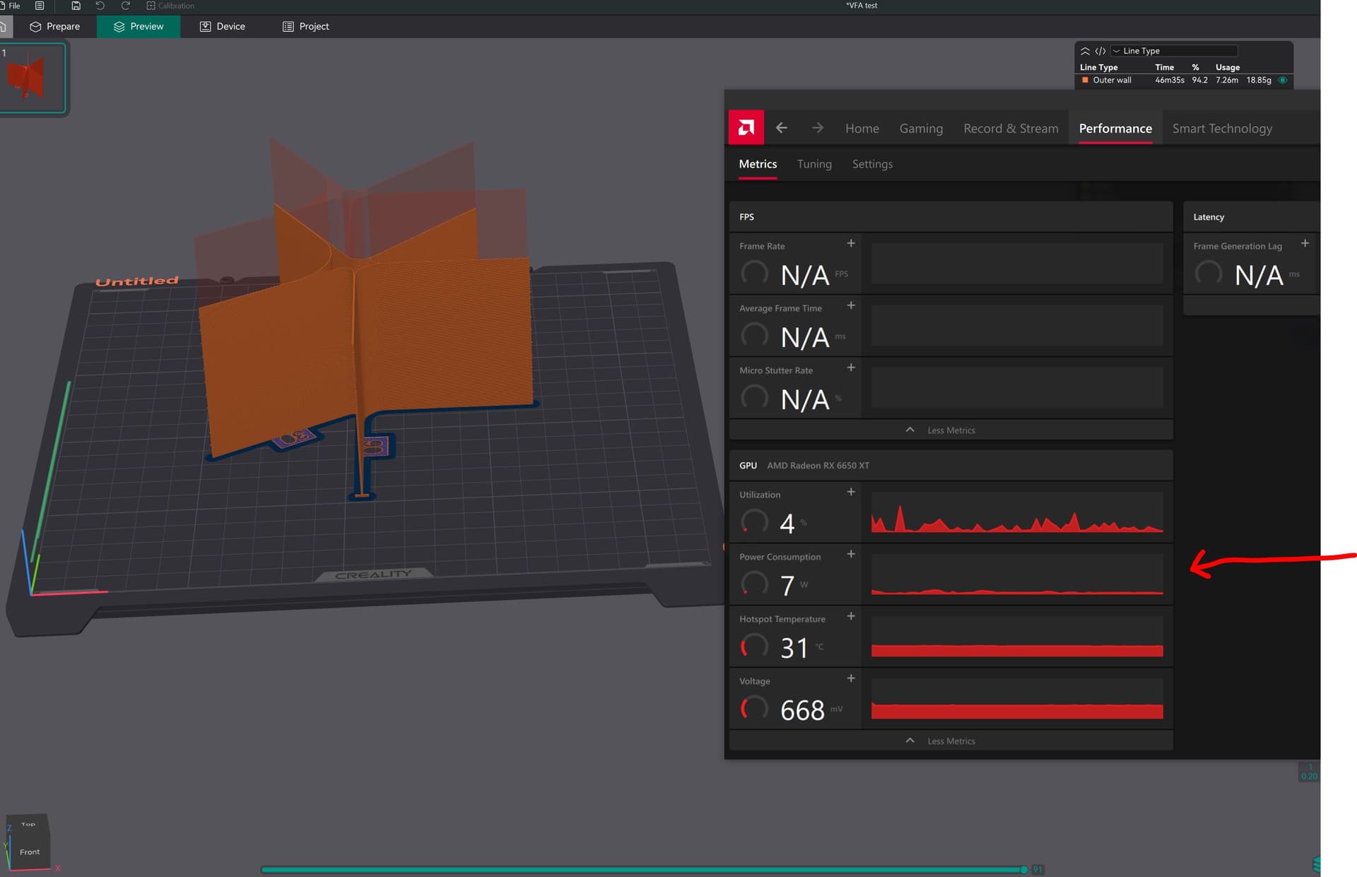

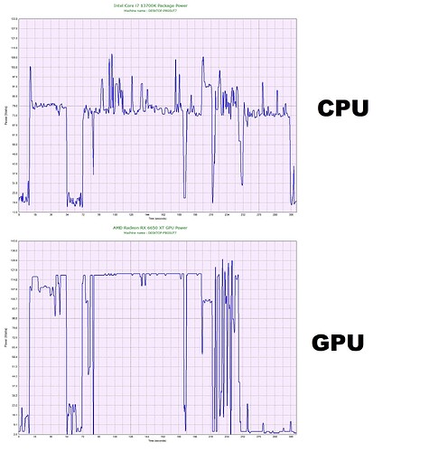

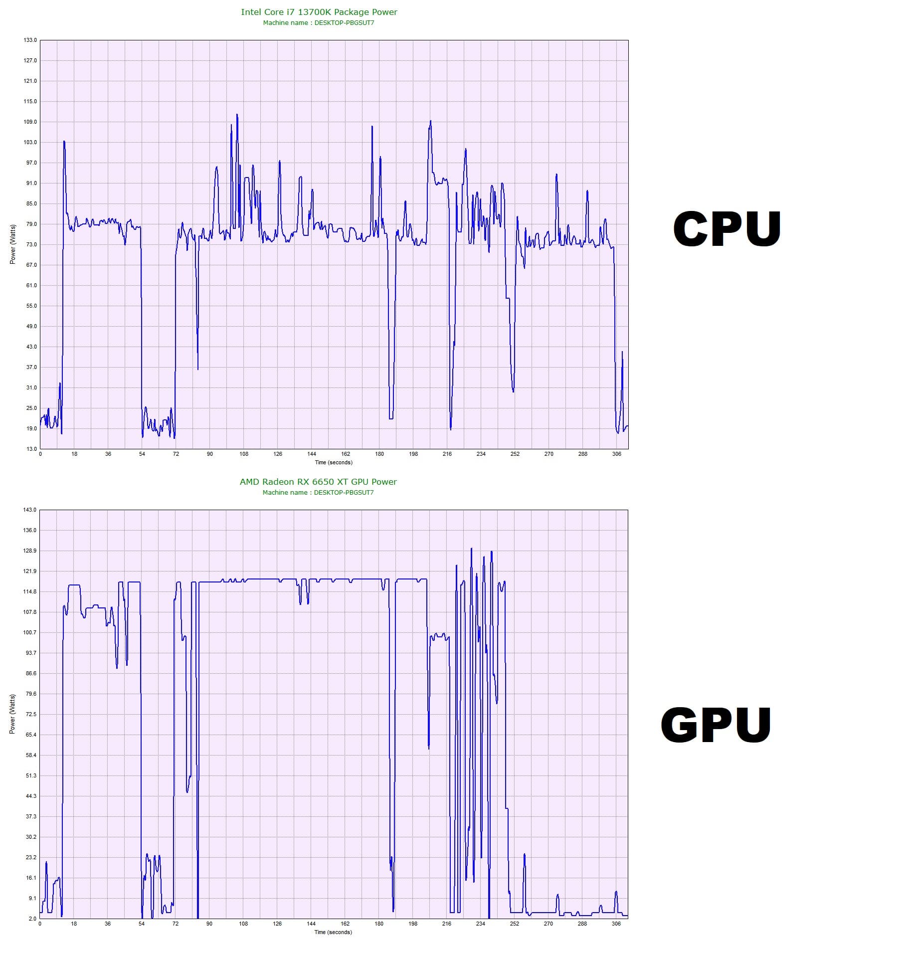

In lite mode:
And when i stop using the preview, and send the data to the printer, this popup window takes some 65Watts, just by doing nothing (if i stay in preview, the GPU will be jumping between 50 and 85Watts power usage):

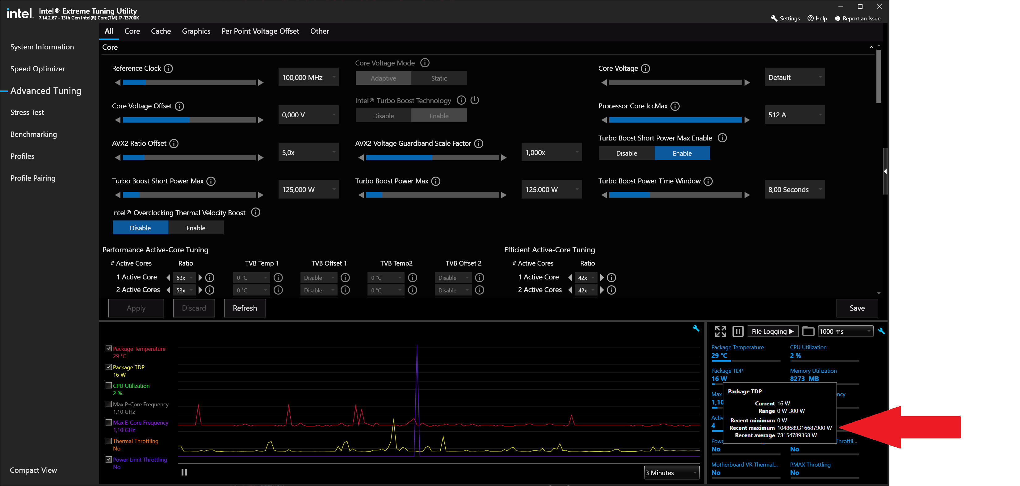

Creality print has a lot of bugs…..just like Intel software and Microsoft do.

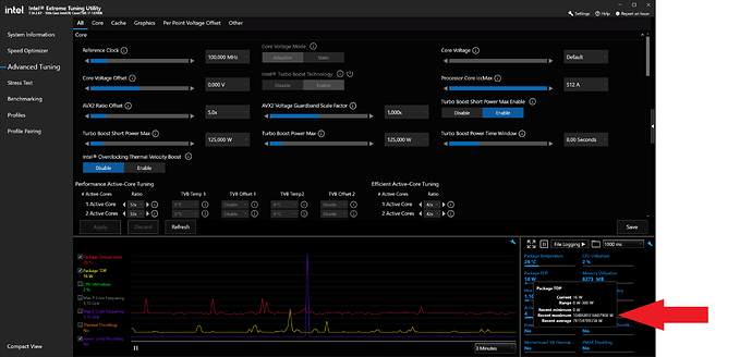

Here is an example of Intel not being able to get rid of a certain bug ….unless my PC draws 1048 TW at peak.

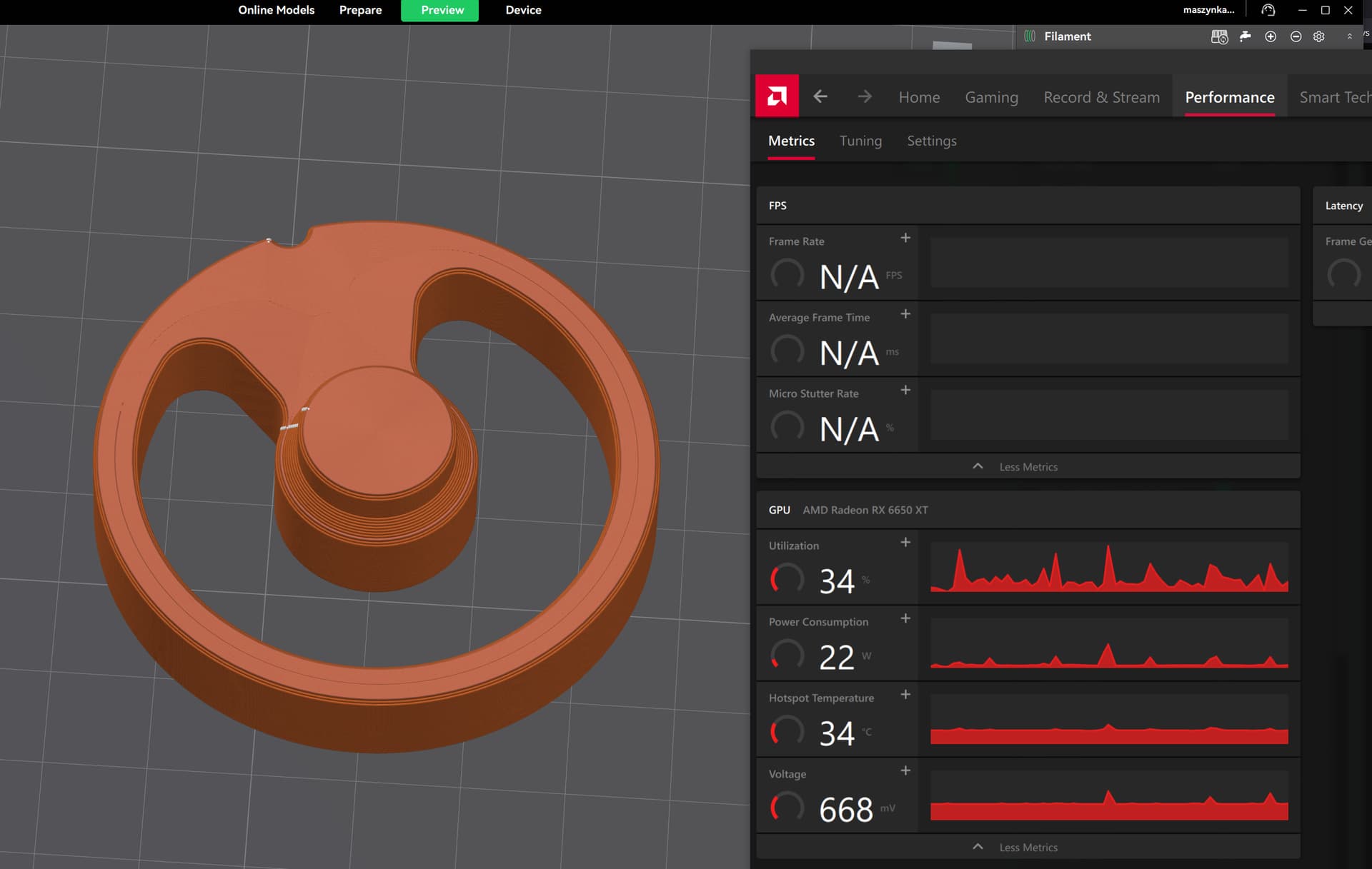

Could say i found the solution. It’s called OrcaSlicer.
It is exactly the same program as CrealityPrint, except there are few options, which are not shared by both of these programs. But like 99% of options are identical.
I opened a project saved with CrealityPrint and OrcaSlicer had not only all exact same values, but also filament name, temperatures, flow ratio etc.
….and so, OrcaSlicer only uses GPU power when i browse between layers, i can stay all day long on the preview - and as long i won’t browse layers, there will be pretty much no GPU usage

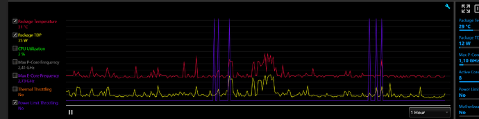

CPU usage spiked only above 35Watts, bcoz i launched CrslaityPrint to compare printing time and settings. Otherwise very very low CPU and GPU usage.
