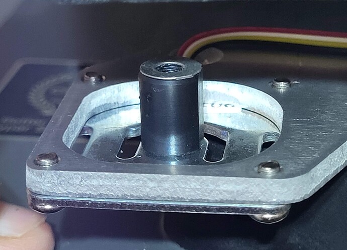

I have verified that the belt tensioner on the Ender 3 V3 Plus is applying too much tension. The following photo is with the tension on the least amount possible. I loosened the tension on both corners and pressed it up as far as possible and then tightened it down again. You can easily see the reduction in VFAs. However, there is a reduction in fidelity of the layer lines. I need to do more testing to verify the impact, but the overall quality of the walls has significantly improved.
I also reduced the tension on the Y-axis belt. This reduced the VFAs. The problem with this is that you will likely encounter belt slipping at high speeds/acceleration.

I don’t own a V3…but…surely there is a way to lengthen the screw, or even print a longer fitting???
There is a spring that does the tensioning. I suppose the spring could be replaced.

Hello… having same issues with my V3 PLUS i have other printers and the v3 plus has a lot of VFA (Wich i have partially fixed rooting it and running the input shapper tunning to get to different values on x and y.
But the worst is that “over tension” on the belts… no way to get them loose, i already tried tu decompress the spring to the opposite direct as the tutorial tell us how to do it but i dont get any improvement.
