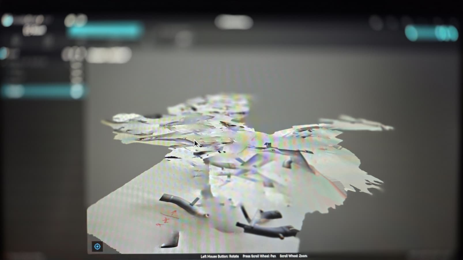

Hello,
I have a Scan Otter connected to a Scan Bridge. Using USB 3 through a wifi 6 dongle.
FW 1.1.8 otter, FW1.1.5 SB, 3.3.6 software ver. I have zero issues connecting and scanning.
My issues: My scans are difficult at best. No matter what mode I choose, the quality, using scan spray, scan spray and markers, markers on the base and standing. You get the picture.
1st it takes forever because it just looses tracking constantly.
2nd, and this may be normal, the built in light will only stay on for a max of about 15 seconds. I then turn it on again. I now just use a flashlight in place of it.
I have calibrated the unit twice with both finishing in the upper 90%.
The best part is that my scan still looks bad when I’m finished meshing it. I tried every setting I could generate adjusting the point cloud optimization and mesh settings.
It’s baffling how I see (youtube) people scanning very small objects with ease and getting great results while I’m having difficulty with a piece that’s approximately 3 inches long and 2 inches wide. (model car interior)
Is it possible the scanner is the issue? (needs repair)
Somehow I think it’s me.
All advice is deeply appreciated. Thank you
Can you send some pictures of what you are scanning and also the results. I have found that, despite what some people will tell you, you really do need good lighting. Check your exposures, I find I get better results when I over expose a little. I have two led lights on tripods that I use and I also use a matt black silicone mat that is really for baking that I use as the base. I don’t use a rotatable stand any longer, I find walking around the model gets better results and fewer tracking issues. What kind of fps are you getting? When tethered to USB I get 29-30 fps and when using the wireless scan bridge I get 14-15. Both seem to work perfectly. The scan bridge definitely gives a better grip and I do lose tracking a lot less since using it. I have never used spray, don’t like the markers but do occasionally use some 3d printed objects with markers on spread around the target object.
t sounds like tracking might be the main issue. If your scanner keeps losing track, try adding small high-contrast markers or using a better scan spray. Also, the built-in light shutting off frequently isn’t normal - maybe check if a firmware update helps.
For better results, try scanning an object with more texture to see if the issue is with the scanner or just the model. If problems persist, reaching out to support might be a good idea. Hope this helps!

The owl test has no pre-scanned file in the software, the owl has just rich geometry and texture and is therefore easier to scan than for example the motorcycle exhaust that you tried. You would need to prepare it appropriately, maybe needs markers to scan.
It was so slow I could draw it faster. It would also lose where it was and I would end up with an exhaust with extra tubes that it added.

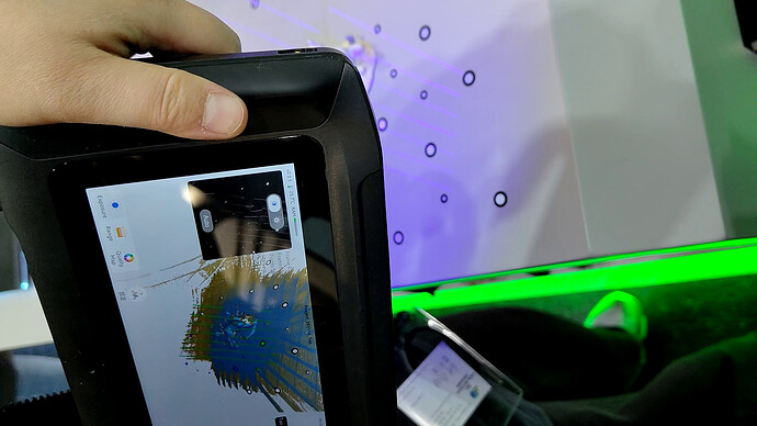

Hello I have same problem with p1 igné on for you now ?
Can you maybe attach a photo of how it looks when you try to scan? And describe a bit more what the problem is and what you tried to scan with which mode. I tried the P1 at Formnext and it was quite easy to use.
Honestly, I think it’s good, or maybe it’s just very temperamental. I had an accident and couldn’t get it out before. I think adjusting it with the blue light is extremely difficult. I’ve been trying for eight days with markers, more or less spaced apart, matte white, black, cardboard, etc., and nothing happens. There should be a starting point if the problem is with the settings. It’s not very useful for my photos; it doesn’t scan anything. It works in infrared. I’m going to use the warranty because I’ve had it for a few months now, and I’m honestly wondering if there’s something wrong with it. I calibrated it on Saturday with great difficulty.
Can you mount your phone on a tripod and make a video like that showing how you try to scan something in laser mode?
It is very hard to tell what doesn’t work from the pure text description. The scanning requires some learning, getting used to it, the hand eye coordination etc. but with the P1 and its built in display it should be not that hard.

Sermoon p1 problem all new
Well, I think I’ve just thrown €3500 in the trash. I’ve been working on your device for 10 days now. I’m going to contact legal services because this device is brand new and I can’t spend all day fixing your thing. I have a job and I just don’t have the time. All the procedures have been followed, but nothing works. I’m letting you know again that the calibration has been done, but it’s very difficult. Thank you for taking the time to reply anyway.
Thanks for the video. Generally the P1 seems to be working, the fact that the cross laser lines show up and that the camera captures the markers and it intermittently recognizes them is a good sign.
One thing that I noticed right away, that was tried in a very bright environment. The scanner has a hard time seeing the laser lines it projects on the markers and the object trying to be scanneda under these circumstances. If you ask me, this is the reason why IR scanning works and laser line scanning does not. You can try manual exposure in the small preview window of the IR camera there’s the switch for it (auto/manual), but generally I would highly recommend to use it with a bit more shading.
The other thing is the range and the movements. The range is set to a distance of 255mm to 470mm but you hold the scanner quite far away most of the time. Also you move it very quickly, looks like you’re trying to “catch” the tracking. Hold it steadily, without abrupt movements, slowly move it closer until it catches the tracking, then also steadily move it around the object close to the optimal distance if possible.
