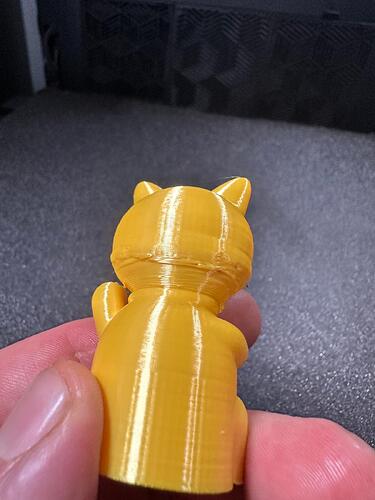

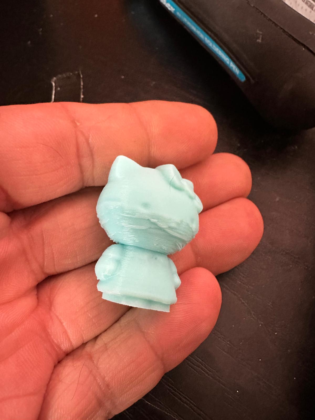

What could be doing this to these poor cats?
I tried these two different models - one with silk pla, one with pla meta, and the same type of result occurs. Thanks a lot in advance <3

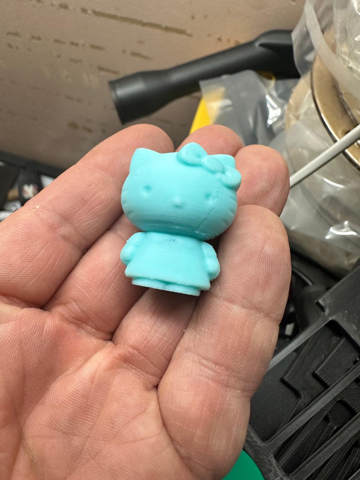

Just in case this helps other folks out - I changed my filament settings, under cooling:
Max fan speed threshold: Fan speed: 100 Layer time: 30
Beautiful results, if I could just get this seam out of the way :slight_smile:
You can also change the orientation of the cat so the side cooling Cools the back of the head more.
