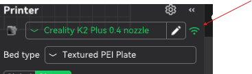

mine wasnt syncing at all, the i did this and fixed it.
  1. Click on wifi icon next to printer menu on top left of screen.
  2. then make sure the radio button is clicked on next to the printer
  3. CFS will now appear in the Filament section , now click Auto mapping and it will update.
It was bugging the hel out off me on this, thought it was because i have K1max with upgrade Kit, but no, just need to click the radio button. think it unselected it self when i di dthe update to the latest one
hope this Helps
Which menu and which screen are you referring to? I’m using CP 6 with a K2 and CFS. Auto Mapping button does nothing.
then
Thanks That was way easier!
