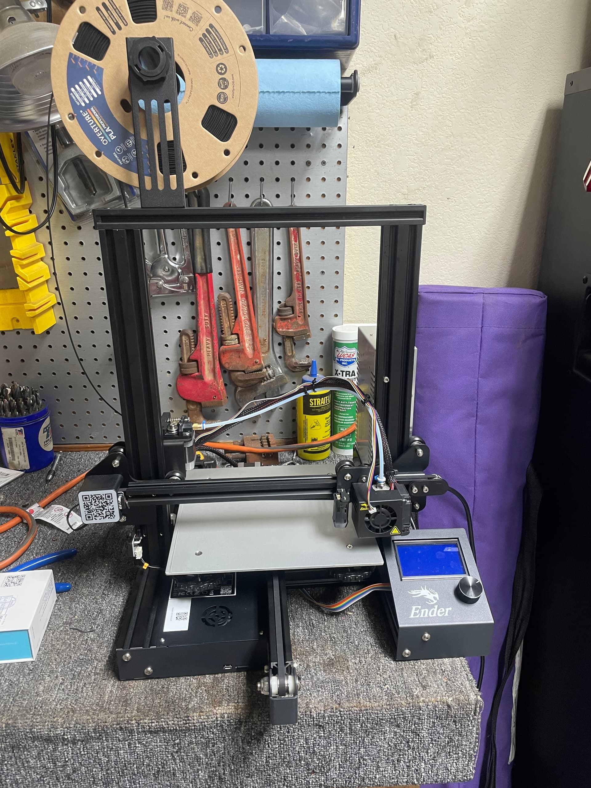

New guy here!! I have recently purchased a ender 3 and im not sure what model I have. Box says ender-3-B on the printer it says ver 1.1.2 and on the motherboard it says 4.2.2
Problem I’m running into is that i wanted to add a cr touch then updated the Firmware with what i thought was the correct firmware but seems like i have the wrong firmware it says “no tf card” sometimes and then i try to go to “print from tf” and nothing will load.

Can you share a picture ? It will be easier to identify the printer :slight_smile: :sweat_smile:
Yes that’s an ender 3 :slight_smile: !

Not sure about firmware and all but you have one of the first Ender 3 models from 2018. You can tell by the cooling fan in the front which they later changed to face underneath so debris wouldn’t get caught in there.
Ender-3-B
Also the “B” at the end might mean it has a magnetic build plate, improved extruder and frame, etc.

From the image of the printer, it is a standard Ender 3, The V2 has a wider rail that the bed moves on and as stated above , the original ender 3 has the control board cooling fan mounted on the top of the case. The V2 fan is mounted under the printer.
