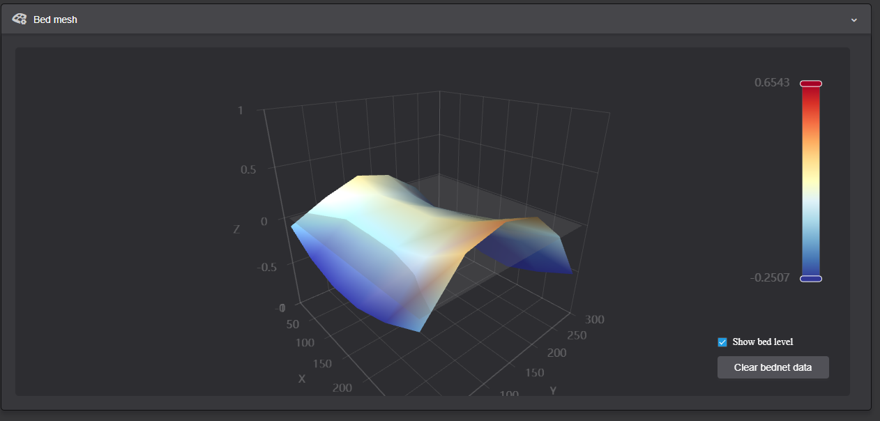

What's Creality's tollerance for warped beds?
I currently have a 0.695 range for my bed with a notable “taco” shape (corners higher than the center). Would this fall outside what Creality would consider ok? It’s way off from my K1, which has a less than 0.3 range. Just wondering if I should contact them for a replacement under warranty.

According to Creality’s Wiki site the tolerance can be up to 3mm. :flushed:
K1 Bed Leveling
I’ve seen people get their bed replaced with a much smaller range than 3mm. But there’s a difference between having a bed that is not flat, and a bed that is flat but not level. The taco- or hill-shaped beds I’ve seen replaced were around 1mm range, iirc. But in each of these cases, they were having demonstrable problems with printing. Are you having issues?

My concern is possible dimensional accuracy issue, for example, if I were to print two halves that were to mate together, an unlevel bed will cause an issue with them having a perfect fitment together. I ran a single layer print along most of the bed (300x300), and the “taco” shows. This is after attempting to level the bed manually using the feeler gauge method used back before ABL was a thing, but I cannot get rid of the taco that way. the only possible way would be by somehow shimming the middle with a heat-resistant, ridged material and cranking down the edges as tight as possible. I’ve attached a photo, but if those are too low-res, here is a link to an Imgur album with the full-sized image of the bed with closeups of multiple points.

Incidentally, I am having the same issue as you, but upside-down:
Theoretically, we shouldn’t have an issue with first layers if the bed mesh compensation was working properly, so clearly it does not. I sent in a support ticket a week ago, but I don’t expect any response until next week at the earliest because of CNY.

In my case, I let it soak at printing temperature for 30+ minutes before calibrating. The result is as pictured.

Update for everyone: After sending a picture of the bed mesh and waiting for the Lunar New Year break, I got an email back from Creality support, and they are sending a new bed. They were very understanding and willing to warranty it. I assume it was approved more because of the shape of the warp (a single corner may be more serviceable and fixable than a “taco”) despite the variation in height being lower than what most people think their tolerance is (I’ve heard elsewhere that its allegedly above 1mm). Hopefully the next one is flatter than the old one.

CS got back to me too about my valley-shaped bed (1.0mm range). They suggested shimming it with paper and said that a range of less than 3mm is acceptable.
I said absolutely not. We’ll see what happens…
PLA printed fine - PETG is another story however. I’ve got a bed like Anubis132… inverse taco - have been tweaking it. Added strips of kapton tape directly to the bed edges - has helped take some of the taco out of it. Down to about 0.3mm variance. Also been fiddling with Z offset. Printing 200x200x0.4mm cube. Have yet to get a cube free from defects. Can feel the Z steppers spin slightly as the head moves, so it at least attempts to use the leveling data. Followed https://wiki.creality.com/en/k2-flagship-series/k2-plus/layer-compression and everything is tight - don’t know what else to try.
Following up: CS agreed to replace my bed, despite the level 1 support person saying up to 3mm range is acceptable.
