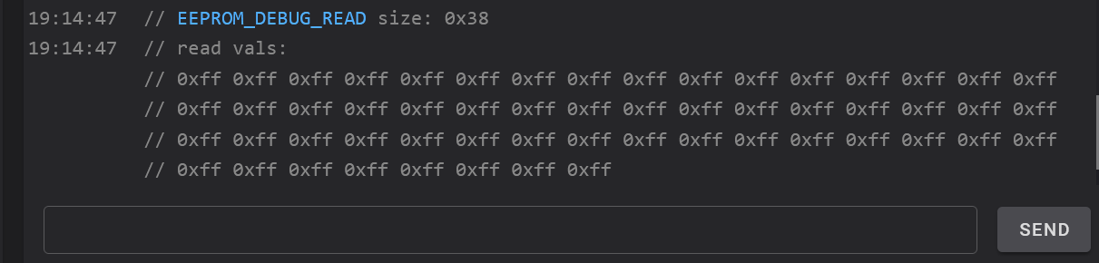

when sending a print i get EEPROM_DEBUG_READ size 0x38 and does not print
i send a print in creality print to my k2 plus and it looks like it starts printing and then disappears a few second later and in the console window of fluid it says this …
Anyone else has this problem and what is the resolution… Ive only had this printer a couple weeks and a few prints off it and now its not working….
Hello ! Had this kind of issue on my Ender 3V3 (Using Fluidd too), I had to delete all existing gcode files in the memory to “unblock it”. It looks like one gcode didn’t load correctly and that blocked everything !
Watch out for special characters & other languages used in filenames/gcode object names, in addition…
these usually cause issues/crashes as well..
Just delete from printer, rename object / plate, whatever in CR reslice and try again.
