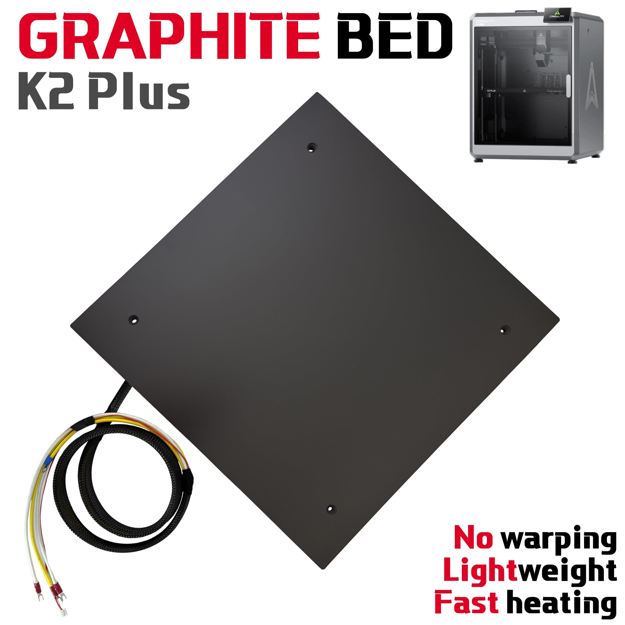

But what if you need to print engineering part that need to be flat. Warped bed means you will get bent print. And not just at the bottom of the print, its goes all the way trough the entire print. I test printed a long 10x10x240mm along the Y axis, and the result is a consistent height bar of 10mm, but warped, just like a bridge.
Look at this
That looks interesting. Thanks for posting that. :blush:
