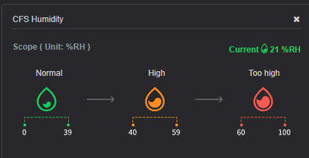

So here’s a question - what’s a good target rH for the CFS? When should you replace the bags?
Crystal Kitty Litter is mostly silica gel. I put a soup can or similar sized tub of it in the filament storage boxes, along with a non-electric dial type humidity gauge. Occasionally the dessicant gets baked in the oven around 300F for a few hours, which is easiest if you use metal cans. I’ve been doing this since the Printrbot+ days so around 2012 or so.
I’m using the CFS guide levels, I use silica gel in printed spool holders and swap out/re-charge silica whenever it gets above 30%, I’m in an extremely humid city, often over 80% humidity

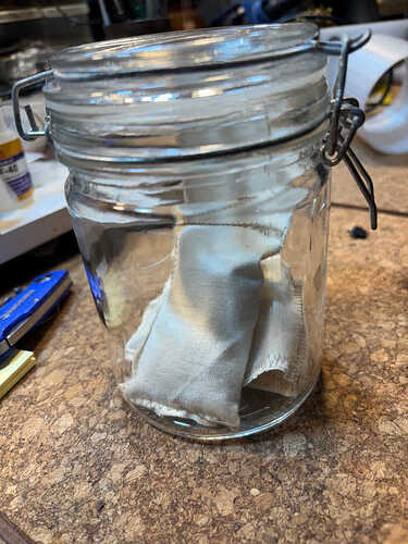

I have a couple of kgs of Sigel desiccant beads in my home shop I use for a compressed air desiccator system. I got my sister to whip up some cotton bags that fit inside the CFS desiccant compartment, added some beads and then got her to sew them shut. The filled bags go into the kitchen oven at 125ºC for 4 hours to dry out. I got four bags made up so can keep two of them as spare in an air tight container for immediate use when needed.
