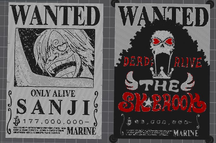

I need some help here. Has anyone else run into this issue with reasonably flat prints? I have tried expanding the individual objects and detailing them on a large scale, then shrinking them back down to the size that I need. I first tried to do it by just changing the colors to the design that I wanted and printing it, which came out like I tried to do it by melting crayons. No matter what I have done in the “paint” tab, I still end up with this resolution, but it has only been these 2 pictures. The rest came out great.

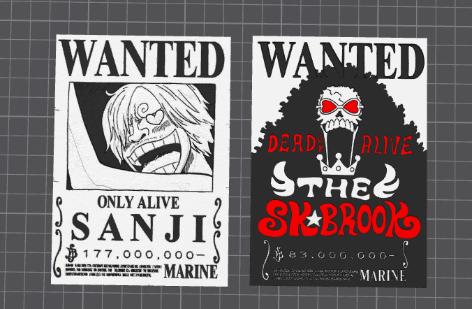

This is before I slice the plate
And this is the after product:
I can’t get rid of the white dots and the unnecessary color bleed that happens.
WHICH SIZE ARE YOU TRYING TO PRINT THOSE?
I’m printing them at 90.2mm x 128.64mm x 2.2 mm. Even when previewing the slice at full plate size it is doing the same thing

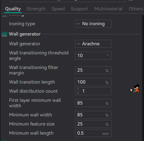

ok you need or use a .2 nozzle or make bigger the small lines. also you can play with the wall generator settings but beside of use wall generator arachne is no much I can recommend.
