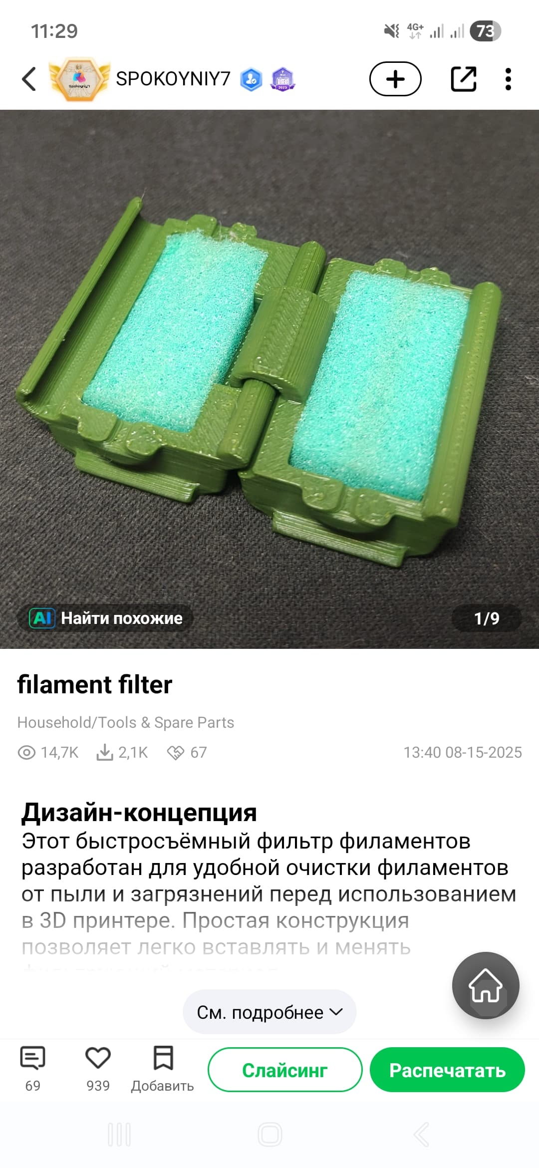

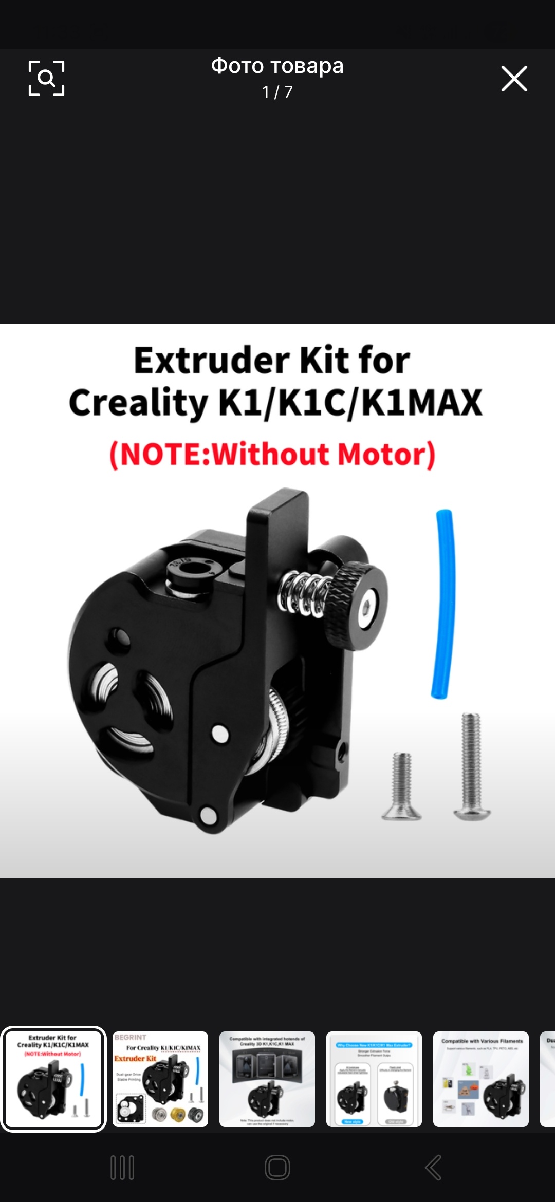

Hello, perhaps the settings of the slicer were incorrect and the nozzle is also clogged with dust, be sure to put the filter on it can be found on the Creality Cloud and print out inside place a paralon, a sponge for washing dishes, for example, by cutting it out to size. Another solution is to upgrade the extruder and replace the hotend itself with a modernized radiator. You can order on any marketplace.

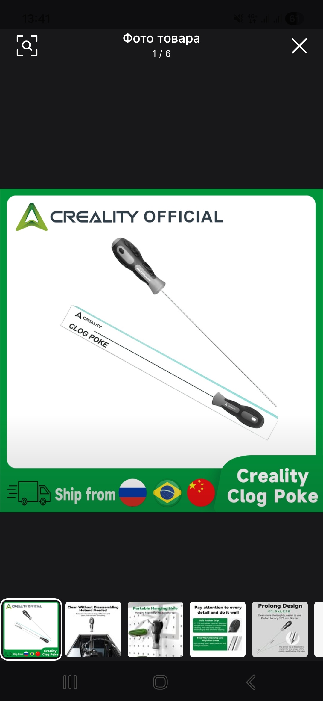

Try to order another tool like this for cleaning and pushing nozzle plugs from Creality.
