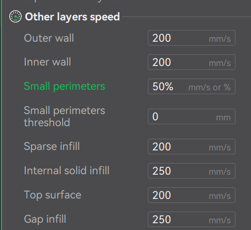

That points to a larger issue: the profiles and calculation logic do not appear to be seriously validated against actual machine behavior. When changing speeds for specific functions, such as outer wall or inner wall speed, I have not seen a consistently logical relationship between those settings and the resulting time estimate.
