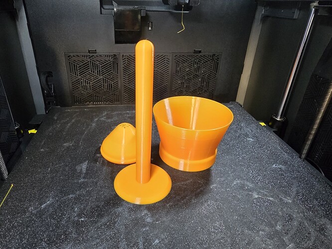

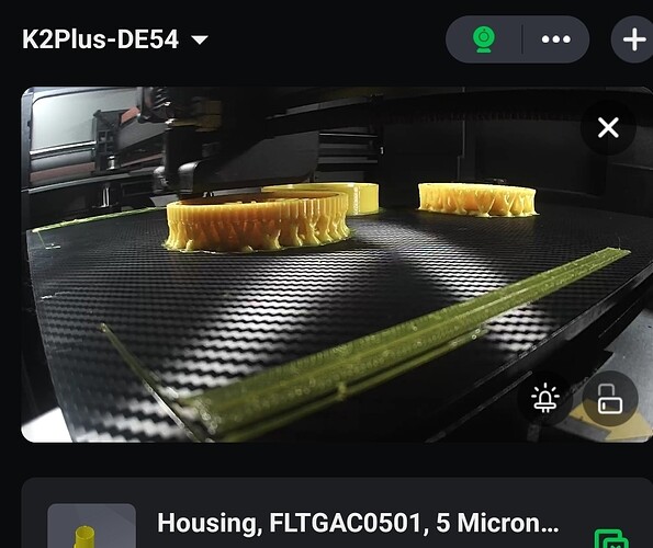

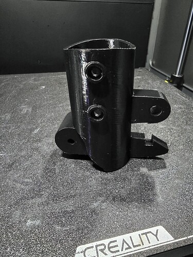

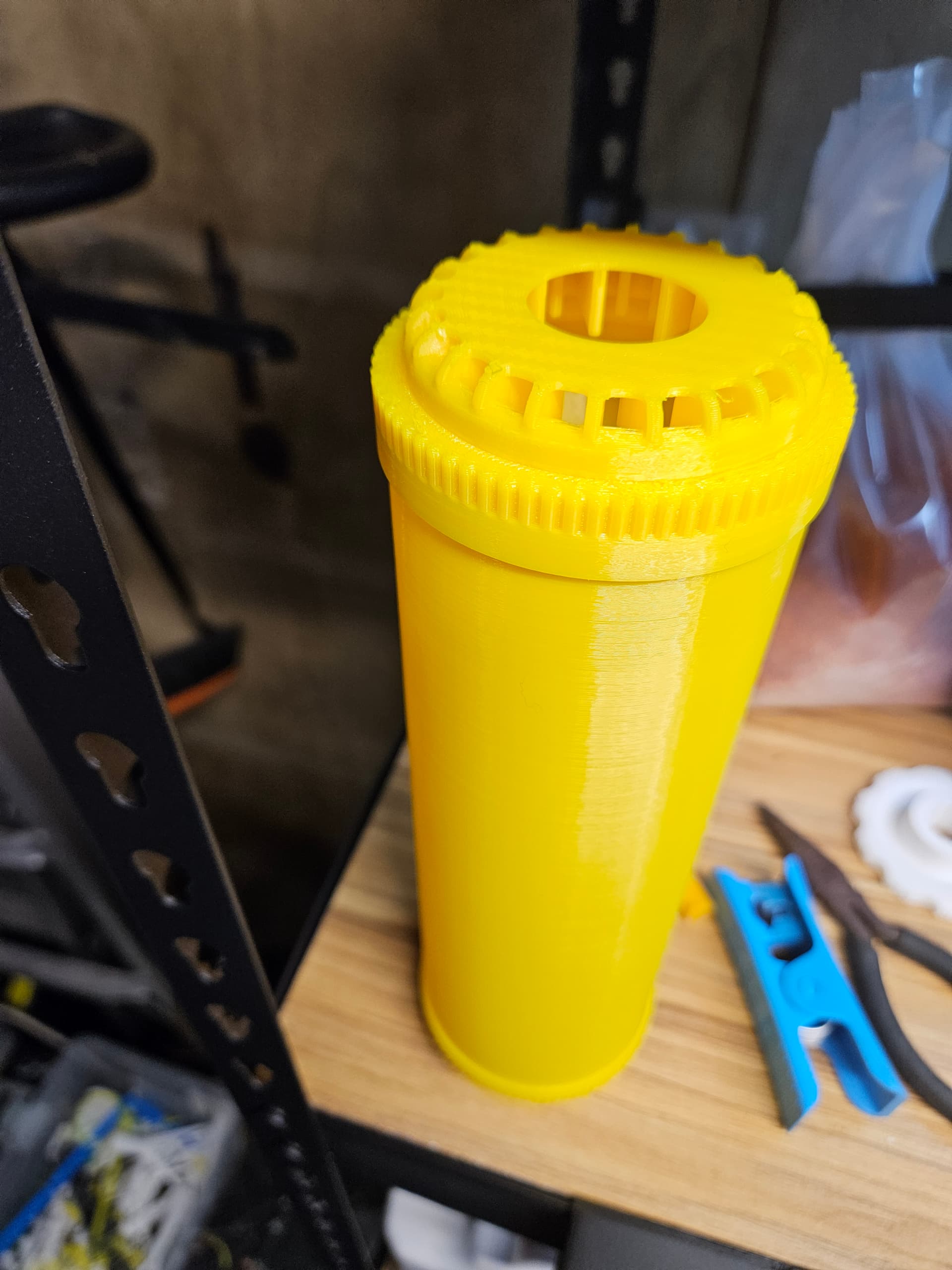

Some PETG examples I’ve recently printed. Spheres without any supports (green is petg black was tpu), 10" filter cartridge for GAC, RO di plungers, and a golf trolley fix.

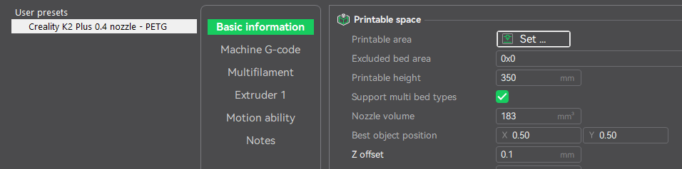

I signed up just to post this. I was having issues printing Creality Hyper PETG on my K2 Plus since I bought it. At the same time my H2D was doing great with it. After comparing default profiles I found that the only setting you need to change is “First layer - Line width”. Set it to 0.42 (the default is 0.5) and PETG will become your favorite filament.
