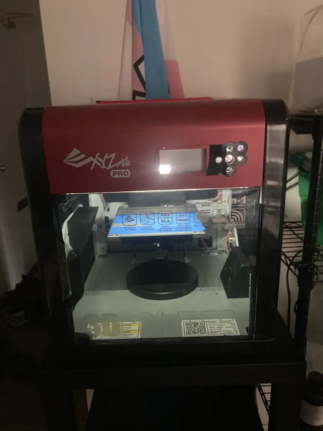

My DaVinci 1.0 Pro from 2014 had an optional laser engraver head, even back then. (although thier software to run it was sub par.)
They also offered a 3 in 1. model (3d Printer, 3d Scaner, and laser engraver). in the image you can see the turntable and on left and right are the cross-line (red) laser units. one low looking up, and one high looking down at the turntable.
So am very confortable with multi role machines.
