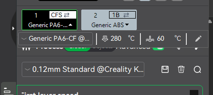

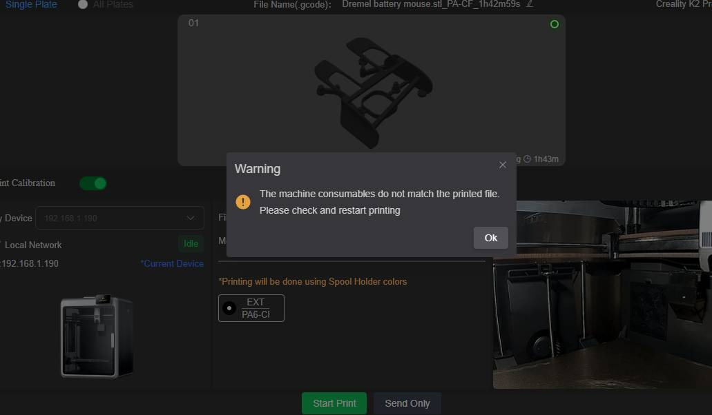

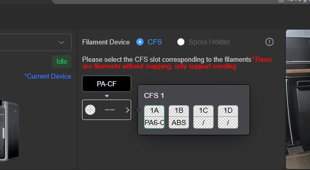

I’ve got a part I really want to print in Pa6-CF. I’m having a *There are filaments without mapping, only support sending error.

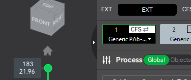

I’ve used rfid tags, the cfs and external spool reader both read the tags and the printer seems to know the material. Creality slicer will let me slice the print in the material it reads in but wont let me send the print.

are you feeding from the external spool holder? if you load from external spool holder and then set the filament manually you should be able to get it going
