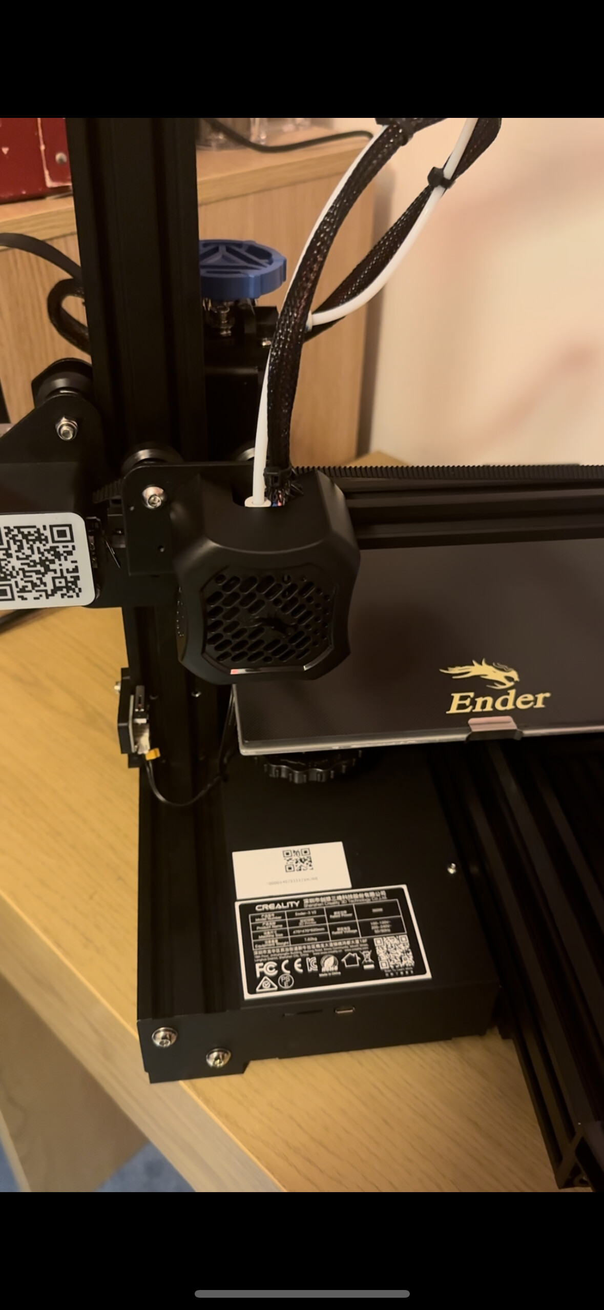

Hi , I am new to printing just set up my ender 3 v2, everything seemed okay then when running auto home for the first time when it goes to the far left it makes a loud noise then stuck won’t complete the auto home or move atall , any help would be appreciated thanks
Hi @Jezzmondj and welcome to the forums.
Sorry to hear you are having issues with the X axis… having looked at your photo it looks like your X axis belt is installed upside down, the teeth of the belt should not be on the outside of the belt.
I would recommend loosening the belt off, removing it and reinstalling it the correct way round. The belt being the wrong way round it causing the teeth not to grip onto the stepper motor that controls the X axis movements.
