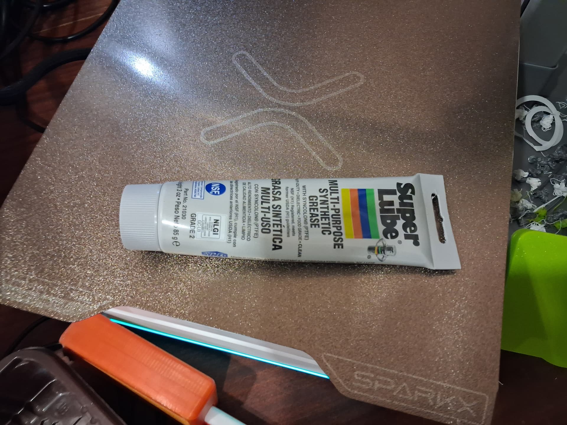

Hi everyone, my Creality SparkX i7 is making a strange noise when moving along the X-axis. The noise happens even when the printer is turned off and I move the X-axis manually.
I already lubricated the X-axis rail and adjusted the belt tension, but the noise is still there.
Does anyone know what could be causing this or how I can fix it? Thanks!

I tried to press the print head slightly towards the back of the printer and the noise disappeared, which means the noise is coming from the linear guide.
08.09.2026 : I added thicker grease and the noise disappeared after a while, now the X-axis works without noise as before.
The noise was coming from the printhead cover—the one you can easily remove by hand to change the nozzle, etc.—; if you don’t believe me, just take it off and let the printer run: you’ll notice it’s super quiet and makes no noise. I also want to draw the attention of all SparkX i7 users to this: check your printer’s screws—absolutely every visible screw—to make sure none are loose. My printer arrived with loose screws along the X-axis, both on the linear rail guide and at the X-to-Z axis connections at the rear of the linear rail.
Thanks for the help and recommendations! :handshake: In my case, the noise persisted even without the decorative cover, and the screws were fine—I had disassembled the print head. Lubrication did the trick; every situation requires a different solution, and the more solutions and recommendations that are published, the easier it will be for users to figure things out and fix these issues.
